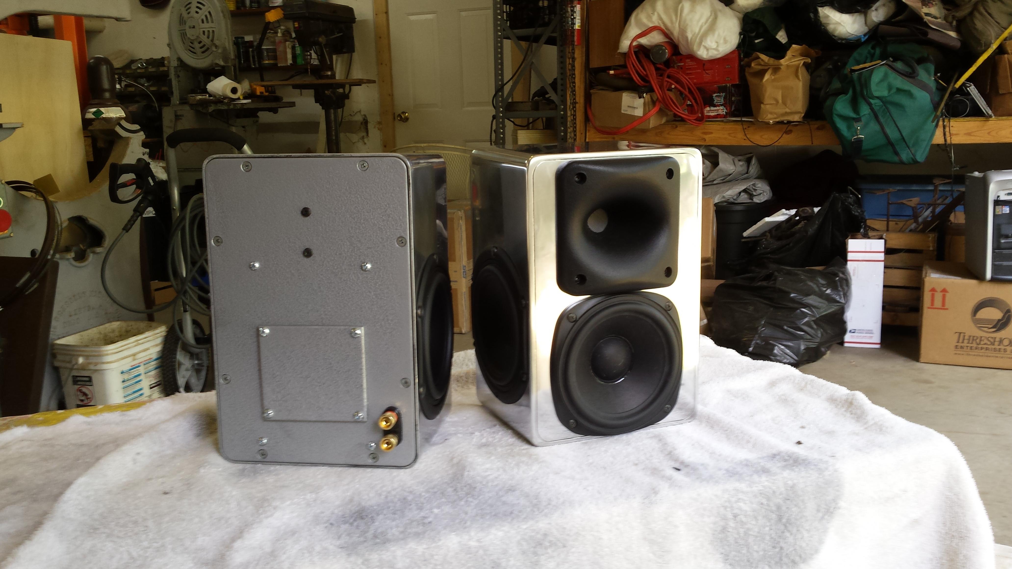

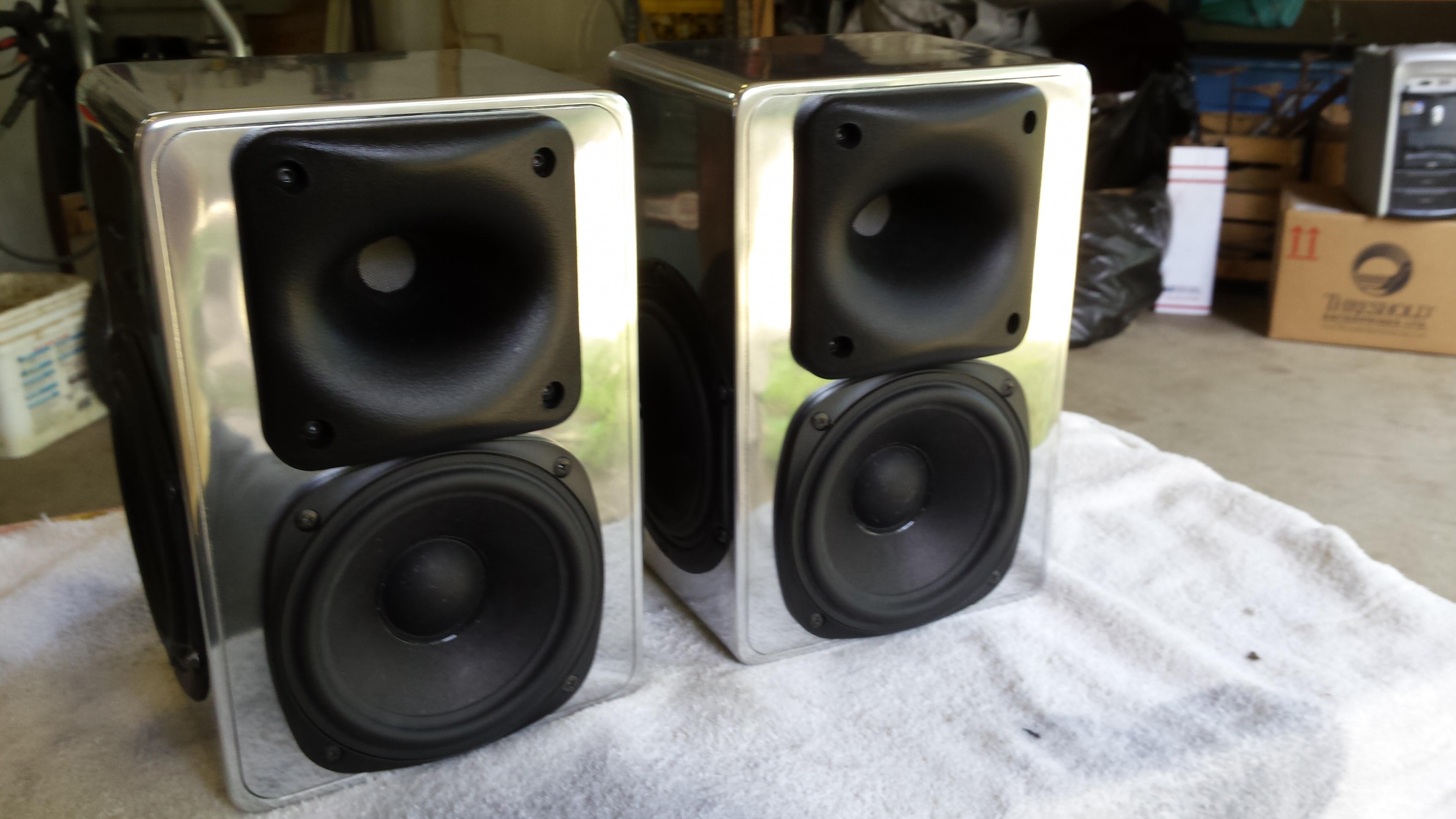

I used Minimus 11 cabinets because they are made with very heavy aluminum so I could polish them to the high luster you see in the pictures. They measure 7" x 10.6" x 6.3" and weigh 15.5 pounds each.

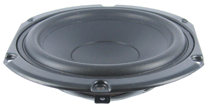

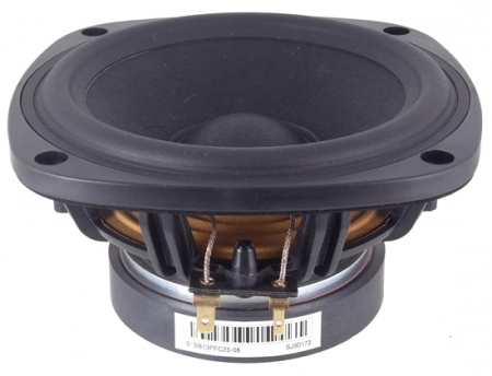

I used the SB Acoustic SB13PFC25-08 5" Paper Cone Woofer as it is a perfect match with this size cabinet and used 2 Peerless 830880 Peerless 5.25" Passive Radiator in each cabinet instead of a vent. The passive radiator gives the tight bass sound of a sealed cabinet with the lower available bass of a vented cabinet.

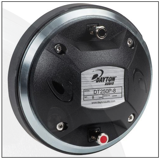

The horn is the H45E elliptical horn with the Dayton Audio DT250P-8 1" Polyimide Compression Horn Driver.

Pix for the completed speakers.
