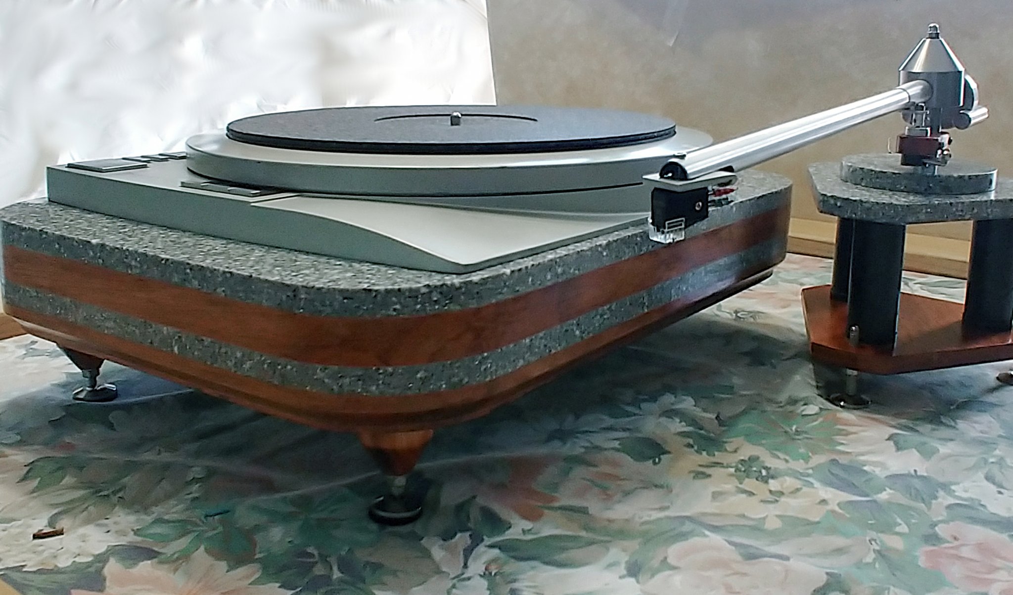

Sorry, when you said "wrong side" I thought at first that you meant this:
How do you keep something like that from being moved once the cartridge is set up?
Hi Marcus,
I would make the pod heavy enough to resist movement. I would also use materials with a large coefficient of friction for the contacting surfaces. Later this year I am going to build an experimental turntable with a freestanding tone arm. I intend to design a decorative but precise locating gauge to be placed on the common turntable and tone arm mounting surface to monitor the correct location of the tone arm pod relative to the turntable. As I am writing, other solutions are occurring to me: The area contacted by the pod could have three Velcro pads located in recesses 120 degrees from each other with similarly located opposing Velcro pads on the underside of the pod. The Velcro pads should project slightly from their respective recesses so that they are slightly compressed when the pod rests hard on its locating surface.
