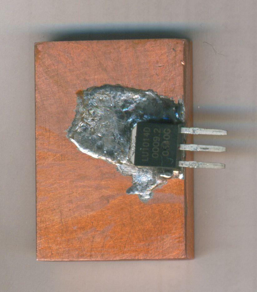

When building ZV9 there is a problem: mounting the Power J-FET's
on the heatsink. I have an idea that I would like to share with you. I solder the fets to a copper plate with a hot air gun. Then I throw it in to water allowing it to cool immediately. Then I screw it to the heatsink, with mica insulator. I don't know whether it's working or not but it seems the fet survived the process. I'm waiting for your opinions. Here is a pic:

Thanks for sharing.
Instinctively, I'd skip the immediate cooling to not shock the different metals.
/Hugo

Netlist, thanks for the reply.
You are right but what about the maximum allowed heat stress ?
(It's 260 °C, over 10 sec.)

Well, maybe putting it in a shallow water with just the copper partly immersed would help. BTW, a thinner & smaller piece of copper would also do the job nicely and would be easier to adapt to your purposes.
I’d go for the smallest possible copper plate, still allowing you to drill holes for mounting.
Then, tinning that plate and solder the component when the copper is still hot will probably take less then 10 seconds with a good iron. I admit I did not try it but should.
/Hugo

Netlist was right. Throwing into water is a medieval method. Don't try it ! (Unless you want to see inside the fet.) The fast temperature change will destroy the fet mechanically. Despite this
the idea is good only cooling method was wrong. Next try I put the copper plate with the fet on a wet cloth. It was good.

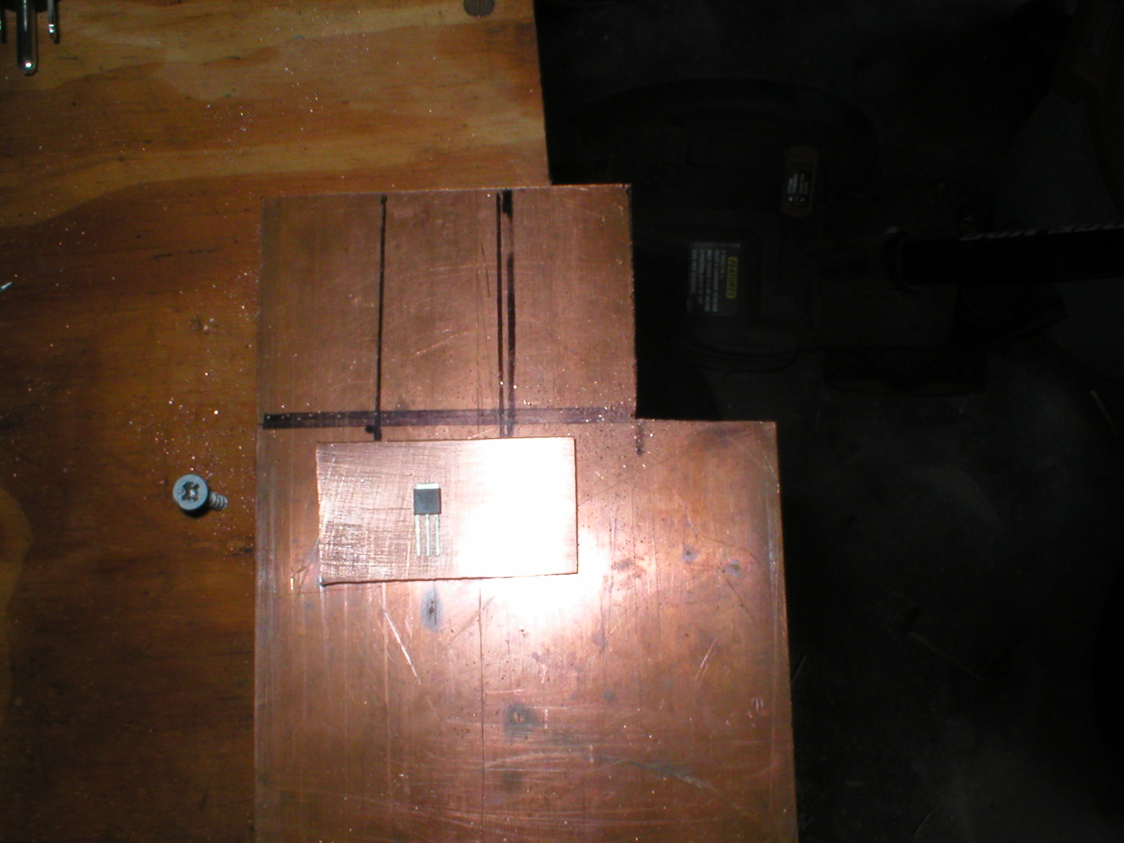

Do pictures interest somebody possibly?
To avoid misunderstandings not with the weller, but I soldered it with the method written down earlier, avoiding the sudden refrigeration.
