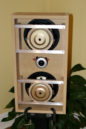

You might want to take a look at my implementation, it works quite well (the speaker is NOT under compression, unlike the Phoenix).
http://www.htguide.com/forum/showpost.php4?p=133401&postcount=17
Mac, where did you source that profile that you use on the back of your drivers? A very clean and minimal implementation.
Ron
Thanks mac. What is interesting in my design is that there is a layer of Sorbothane between the MDF "donut" and the magnet itself. It's hard to see, it's the thin grey stuff. I was trying to minimize vibrations being transmitted back into the baffle.
Ron

The woofers are HiVi M8A, 8" aluminium/magnesium cones. I don't have the t/s specs handy. I bought them from Solen in Quebec, but I believe that Parts Express also carries them.
Ron

Mac,
Can you tell me what type of material you used to sandwich between the woofers and the steel rib?
How did you attach that foamy part to where it is?
I'm still puzzled as to how the steel bar from behind can hold up the 2 woofers. I would imagine that if it's 1mm or 2mm off, there would be at least some buzzing.
Magnet Mount
I used Mr. Linkwitz' Orion mid-driver mounting modification as my model, as his Phoenix mid-driver mounting scheme seems to present too much reflective surface for the backwave to interact with.
My mount consists of a thick "hockey puck" that's the same diameter as the O.D. of the magnet.
The MDF "puck" is secured to the magnet with PVC construction adhesive...and is also held in place with a press-fittted sleeve I laid up in glassfibre set in polyester resin.
So, in my case, the backwave "sees" only a sixteenth of an inch of extra material, the fibreglass sleeve, and the shelf bracket I bolted to the MDF puck.
The midwoof is, of course, sitting on a foam-tape (weatherseal) gasket.
In other words, my solution is almost exactly like Mr. Linkwitz' solution...only a bit different...and -ahem- a bit more secure.
No, I DON'T have a camera, sorry. More money for speaker projects!
