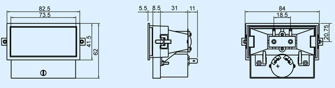

So i bought a couple of Nissei TN-73 to use on a power amp project.
These are some nice(and cheap, paid 24 bucks a piece) meters, and do have a simple way to mount them IF you use the supplied bezel. I want to go in another direction however and plan on mounting them flush to the backside of my thick wooden front panel, and bevelling the opening a bit(in essence the front panel becomes a large bezel). This unfortunately means i won't be able to use the mounting hardware that came with the meters.

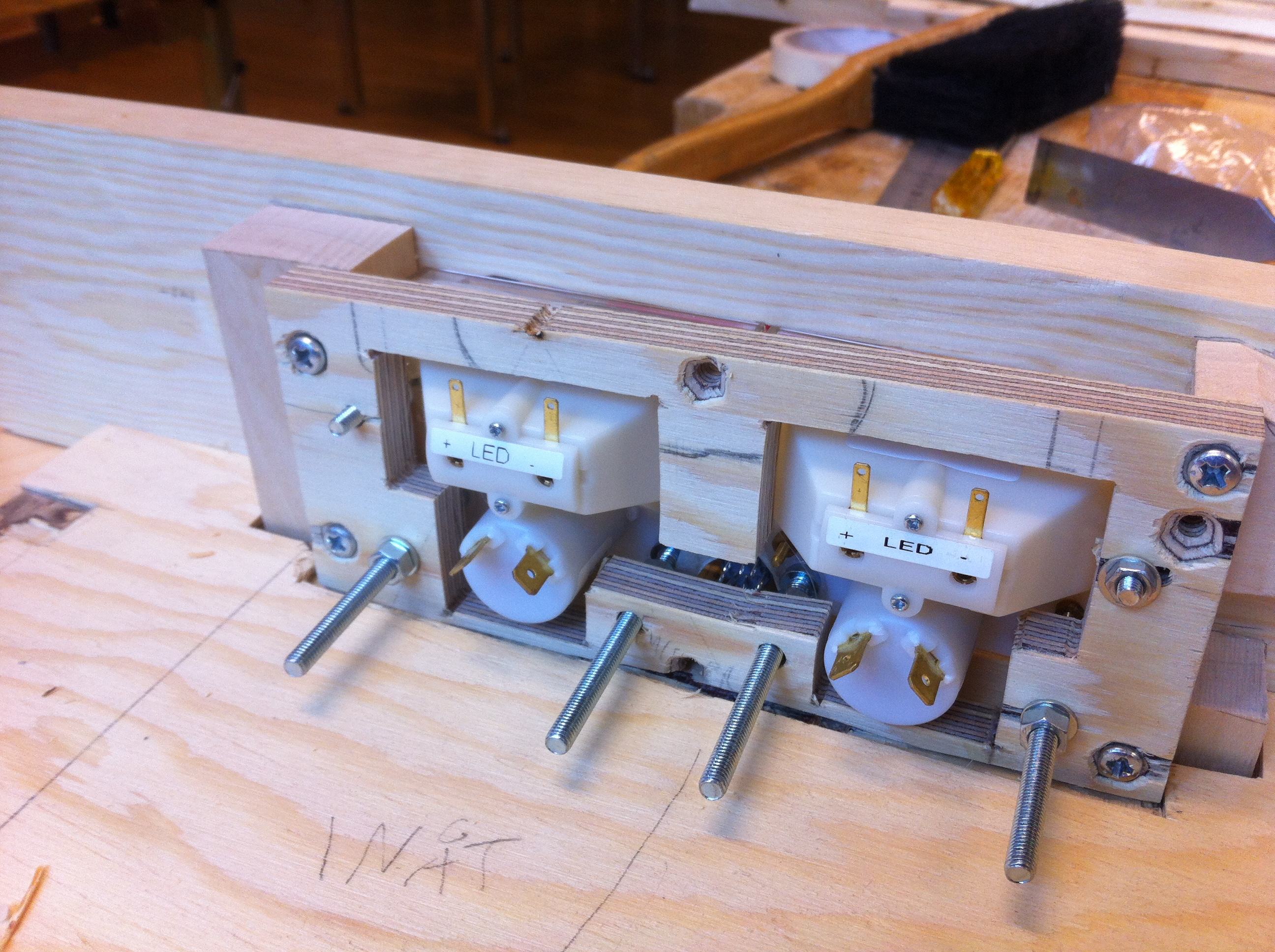

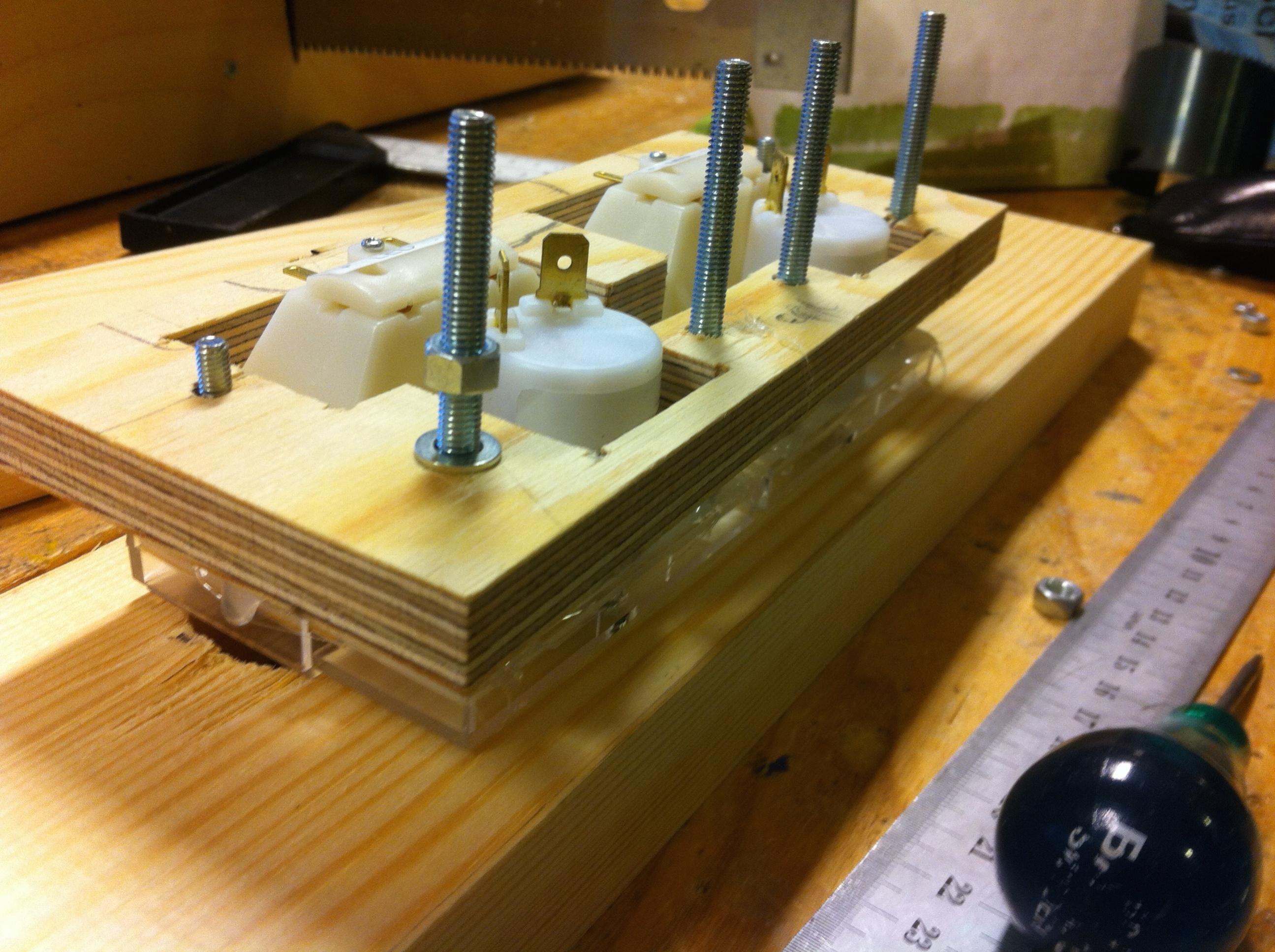

So the plan is to first glue(cyanoacrylate?) the meters side to side, then create a wooden jig and use that as a guide to glue(silicone, PU?) some screws onto the back of the meters to fasten them in this jig, then secure the jig to the back of the front panel(wood screws). The wood is Fir for the panel and plywood for the jig.
Anyone out there did something similar with their meters and/or have advice for me? Attached are the dimensions of the meter and the beginnings of the jig, laid on the front panel.

Or locate the meters into a plywood sandwich made of thin panels of ply .
The front ply forms the combined meter window and holds the fronts in without a central bar , the middle ply holds the meters together as a rebate would and the rear ply holds the backs in .

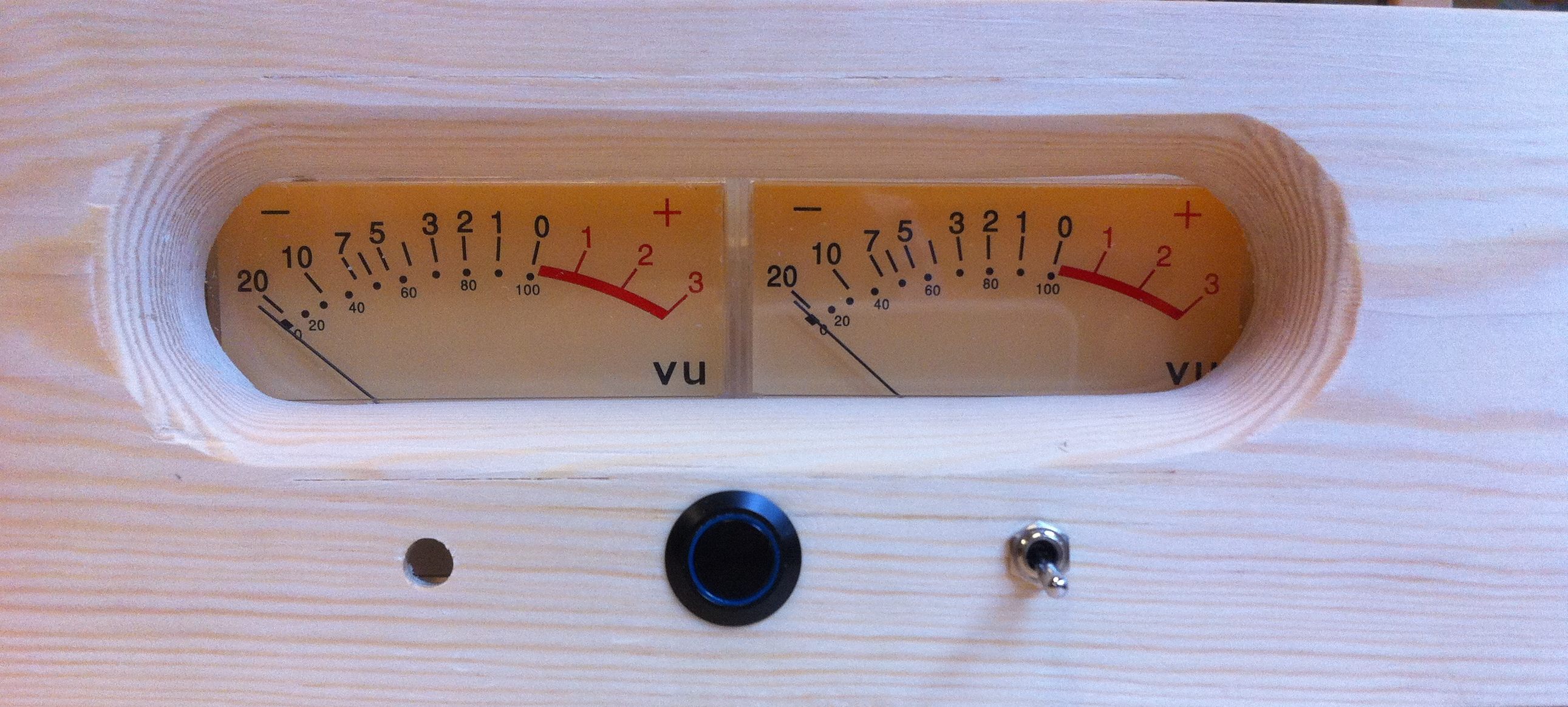

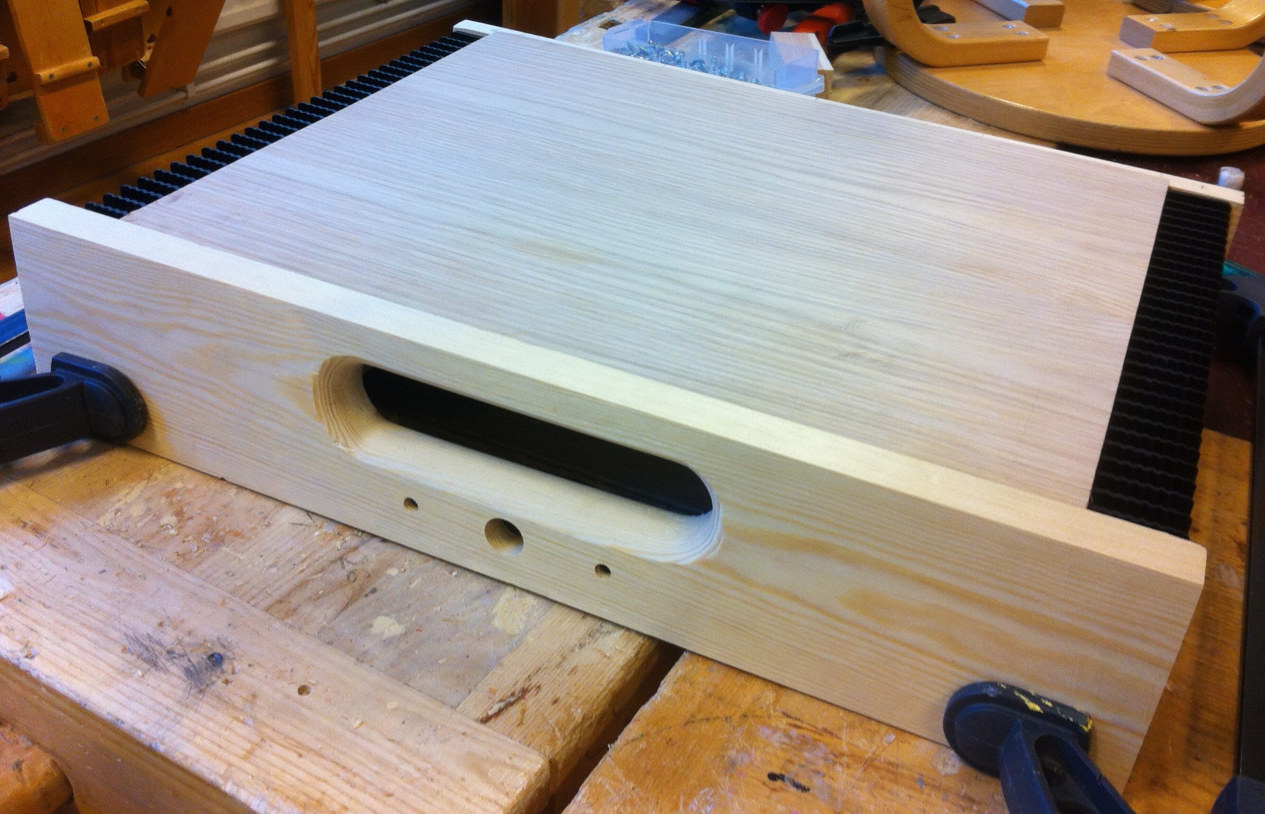

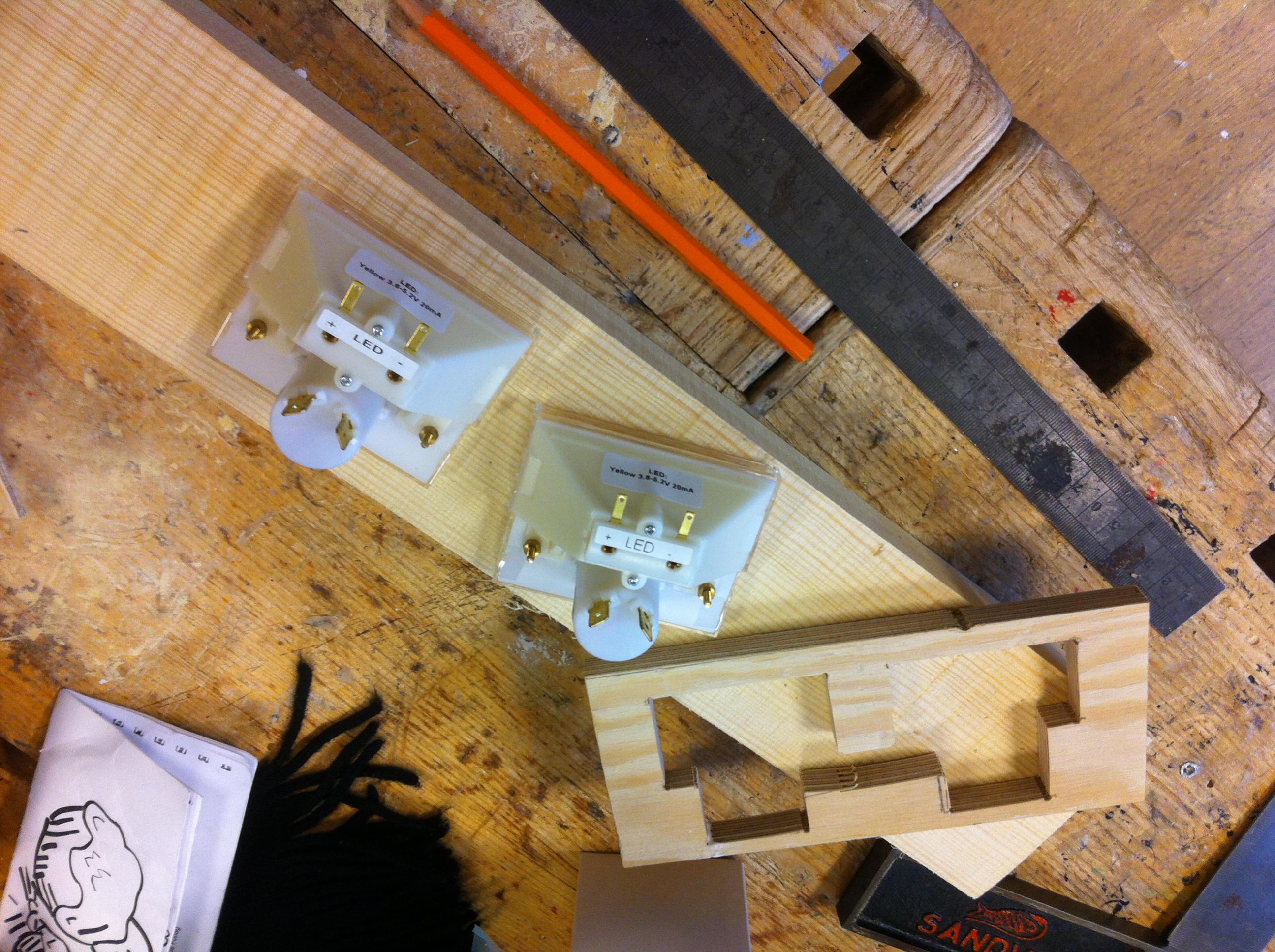

Yeah but i want to minimize the distance between the meters and the back of the panel. Here are some snapshots from my build session today.
I was stressed out as the shop was closing, so i made a mistake. I only subtracted one radius instead of two when i put down my pilot marks for the drills, so the hole is 15mm too wide. :/
But i decided(right then and there in fact) to put a small piece of wood or metal on each side of the meters and place the protection LEDs there instead of on the front of the panel. Too much work redoing the panel and wasteful of wood too.
I think this is going to work!

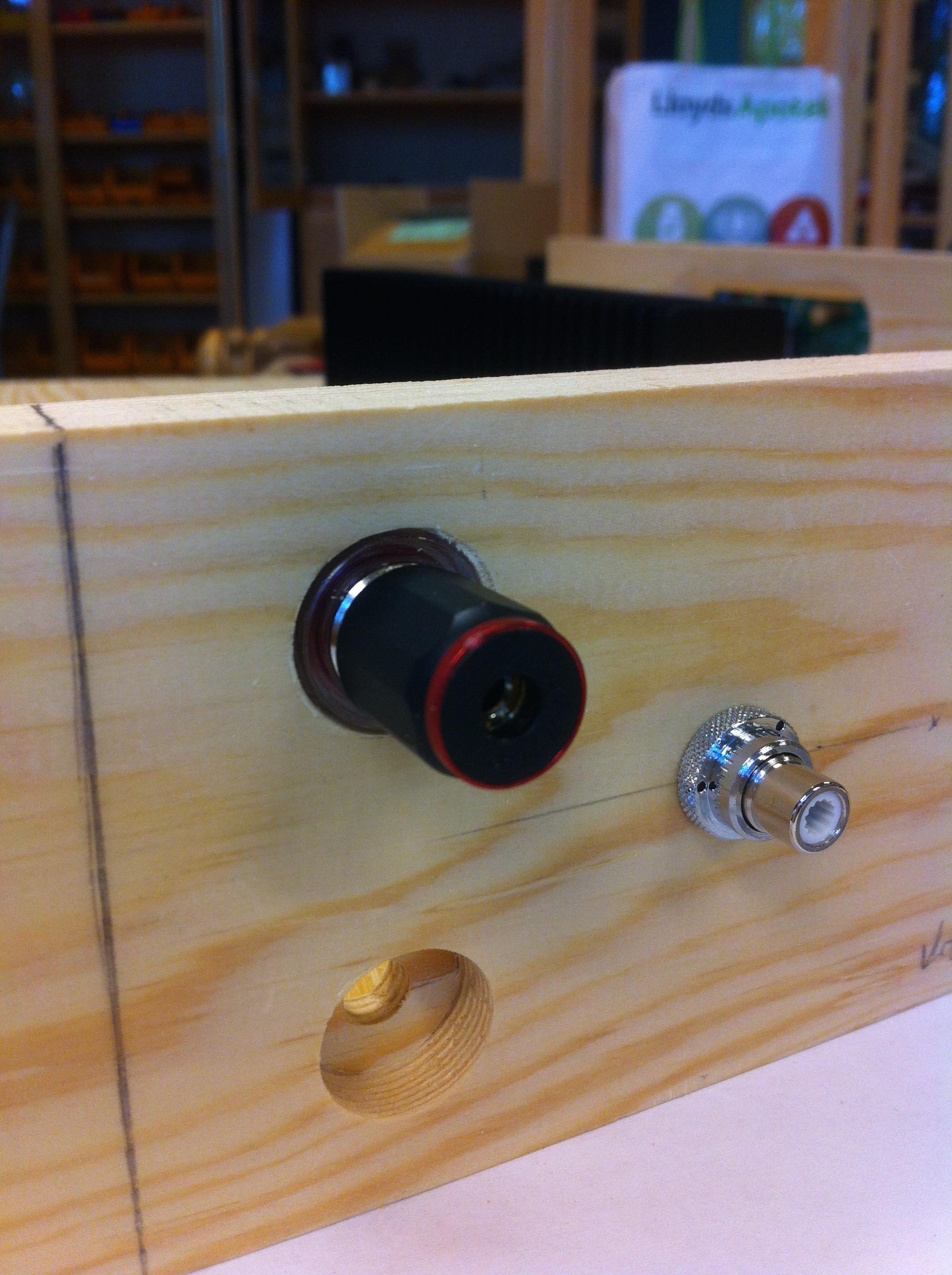

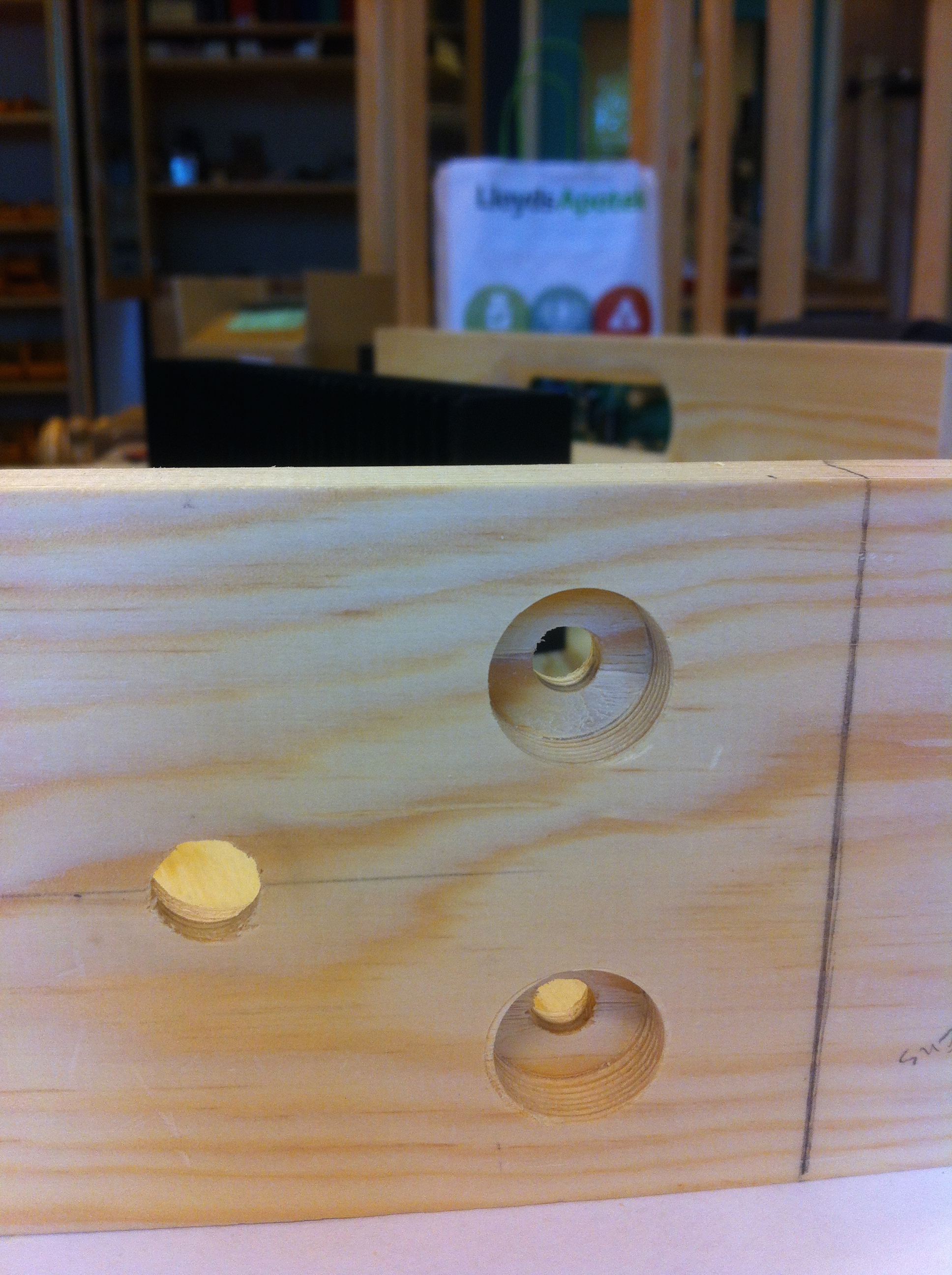

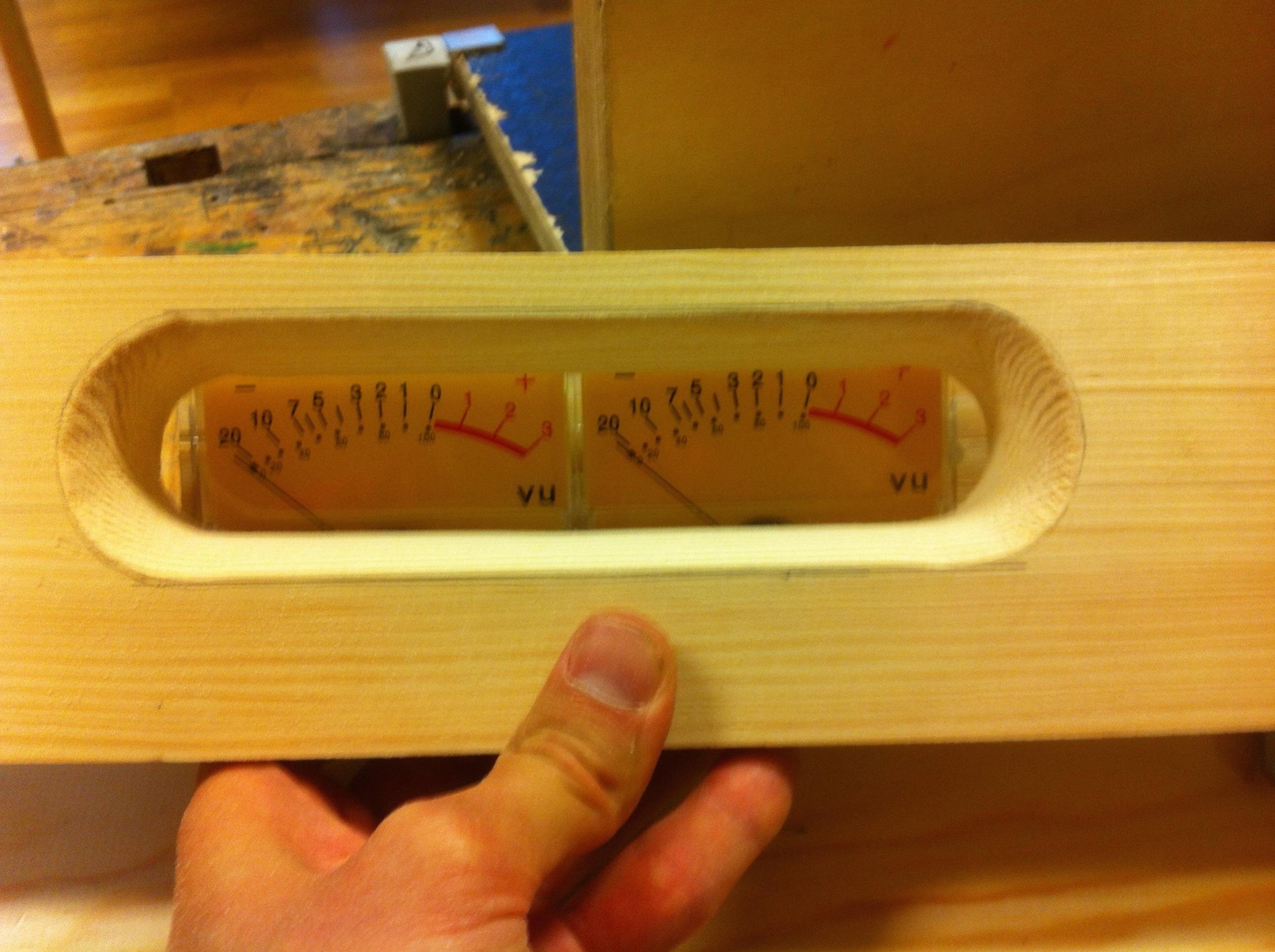

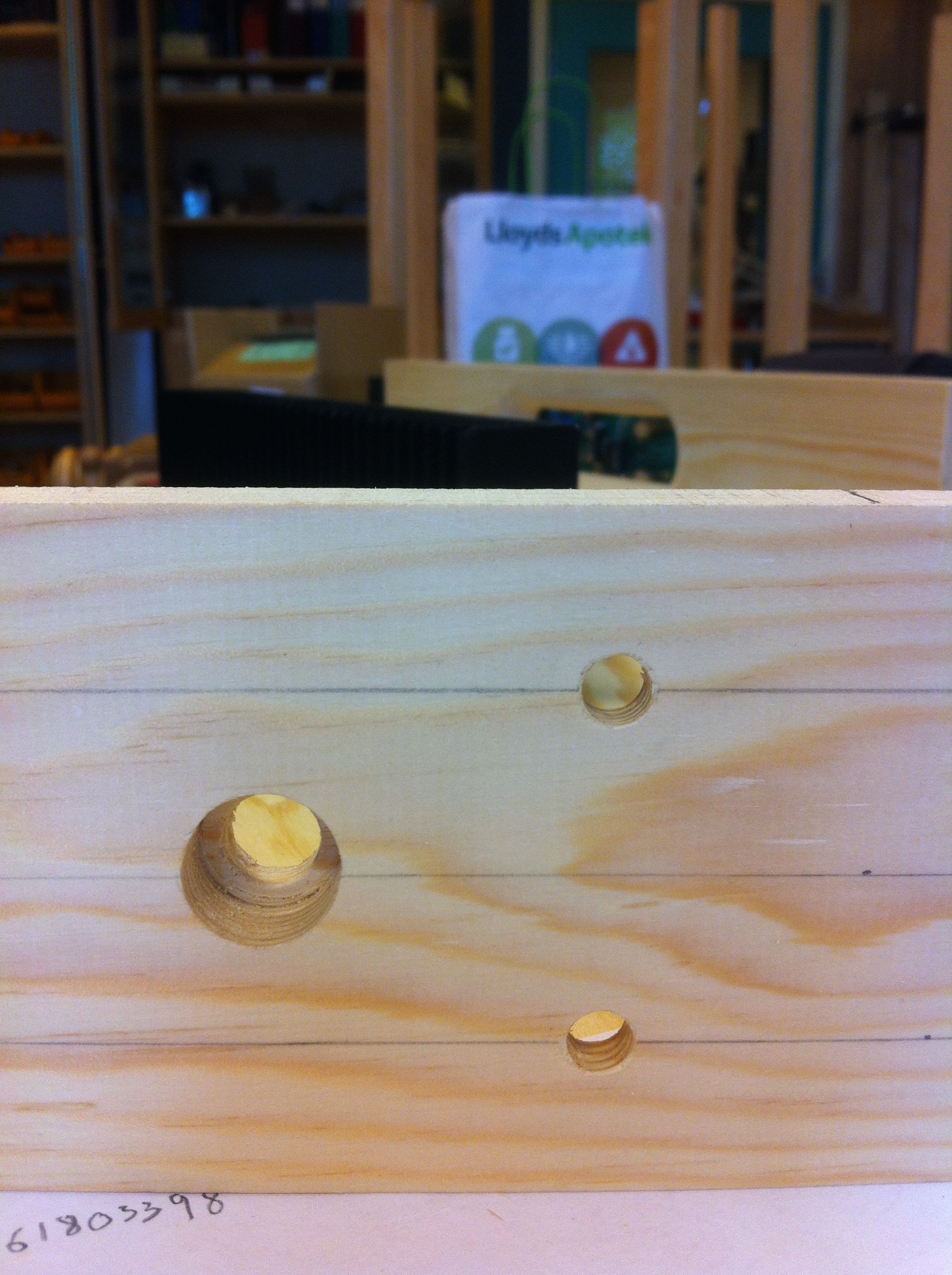

Went ahead and redid the front panel, this time form slightly thinner stock, the gap was bugging me too much. Will post some photos of the finished mounting arrangement once it's nice and dry. In the meantime, i tackled the rear panel, and i have to say i'm fairly happy with the results. The speaker posts are sunk from the outside, vice versa for the RCA jacks.
A quick update with some progress shots. I liked the older panel better with regards to snugness, but this new one will have to do. The whole build turned out to be fairly tricky to get right, i ended up having to take a hacksaw to the meters themselves(to fit the power switch), some hours of chiselwork to muscle the plywood into shape(should've used thinner plywood but this was all i had that was sturdy enough), but a lot of fun and a learning experience. The cabinet is probably around 80% done at this point.

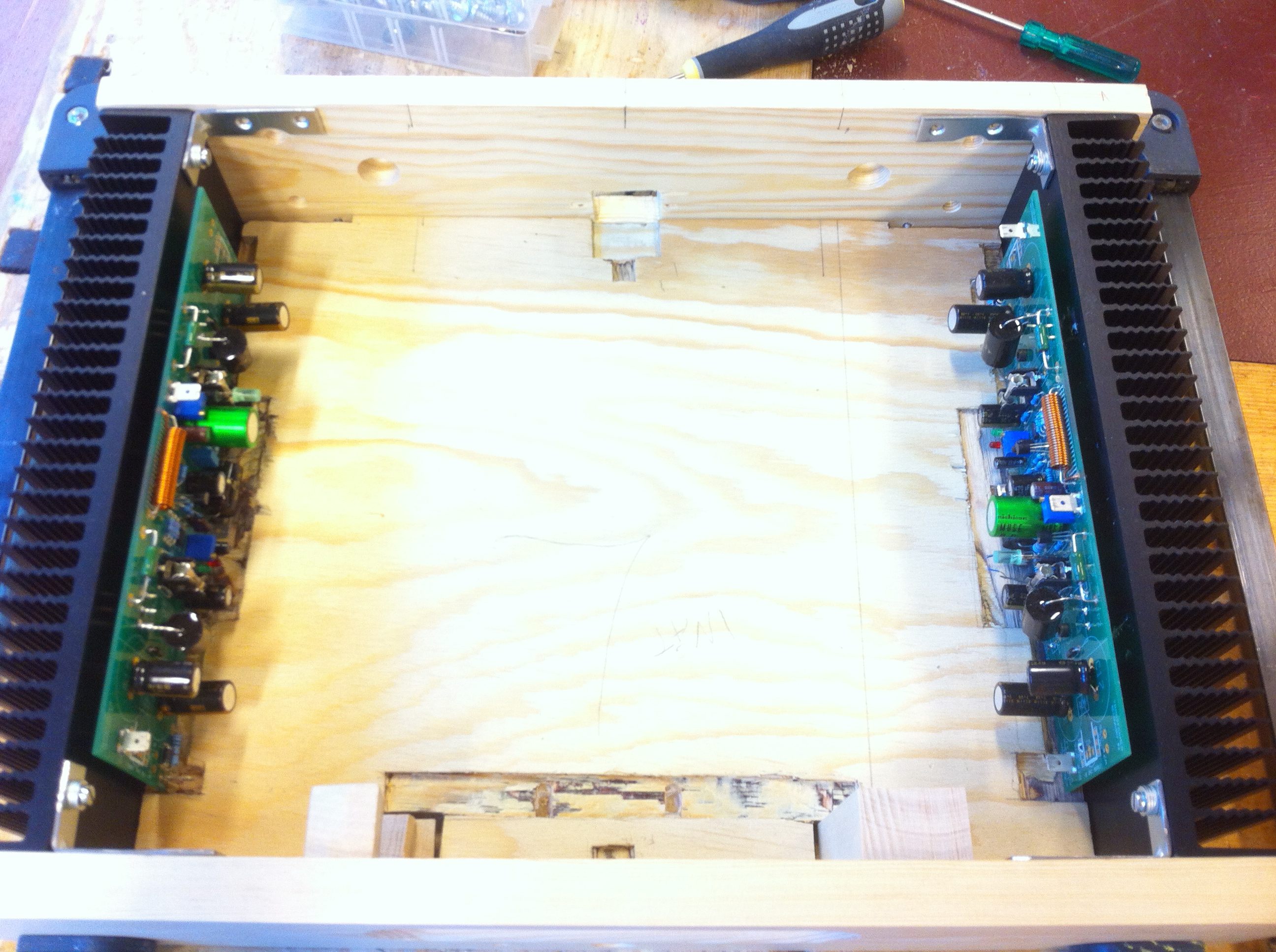

And the monologue continues... 😀 Here are a couple of shots from todays session in the shop. The lid is going to be hinged, to show off the insides but also in case i need to keep it slightly open to keep temps inside the case down.
Nice and roomy inside, plenty of space for PSU and wiring.
