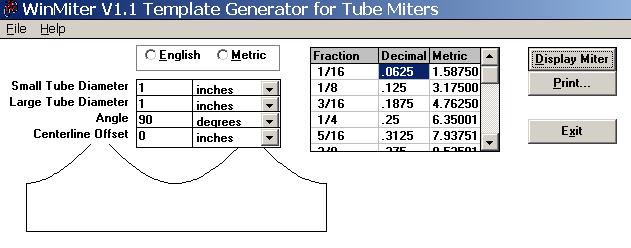

Here's an idea.
Use a ~3" piece of tubing for a connecting piece (ie the driver to be mounted on its end)
Use a program like tubemiter or winmiter to make a template for the notch on the 3" pipe, cut it out, and mark & cut the hole on the 4 1/2" pipe. Cut the 3" pipe as short as you dare afterwards, ie to a minimum.
Both are windows programs. tubemiter looks slightly more basic in its interface, but does the same job.
tubemiter.exe (and tubemit3.txt )
http://www.ihpva.org/tools/ (near bottom of page)
winmiter.zip
http://home.tallships.ca/mspencer/winmiter.html
