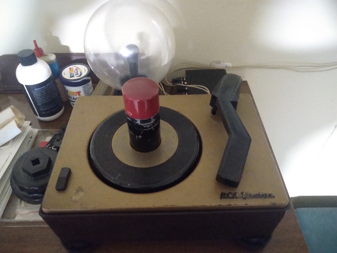

Might be interesting, I'm just doing that but scrapped complete drive circuit and using only motor:
https://www.diyaudio.com/community/...eded-with-motor-and-drive.412984/post-7795028
Either that or I'd have to build a motor base to mount the motor on to keep it totally separate from the record changer.
I'd then build a bottom for it all to sit on to where I won't have to worry about the belt tension changing.
The belt would then go around the edge of the platter.

One thing about it is if I were to use the capstan motor with my 45 player I can use an o-ring for a belt and since I used the brass replacement drive wheel that uses two o-rings, I can remove the o-ring that goes against the motor shaft and place the o-ring belt there which will go around the capstan motor pulley. I can then place the motor such that the belt provides the tension needed for the drive wheel to properly contact the platter and then remove the spring that applies the pressure and taping it inside the cabinet so that I don't misplace it.
