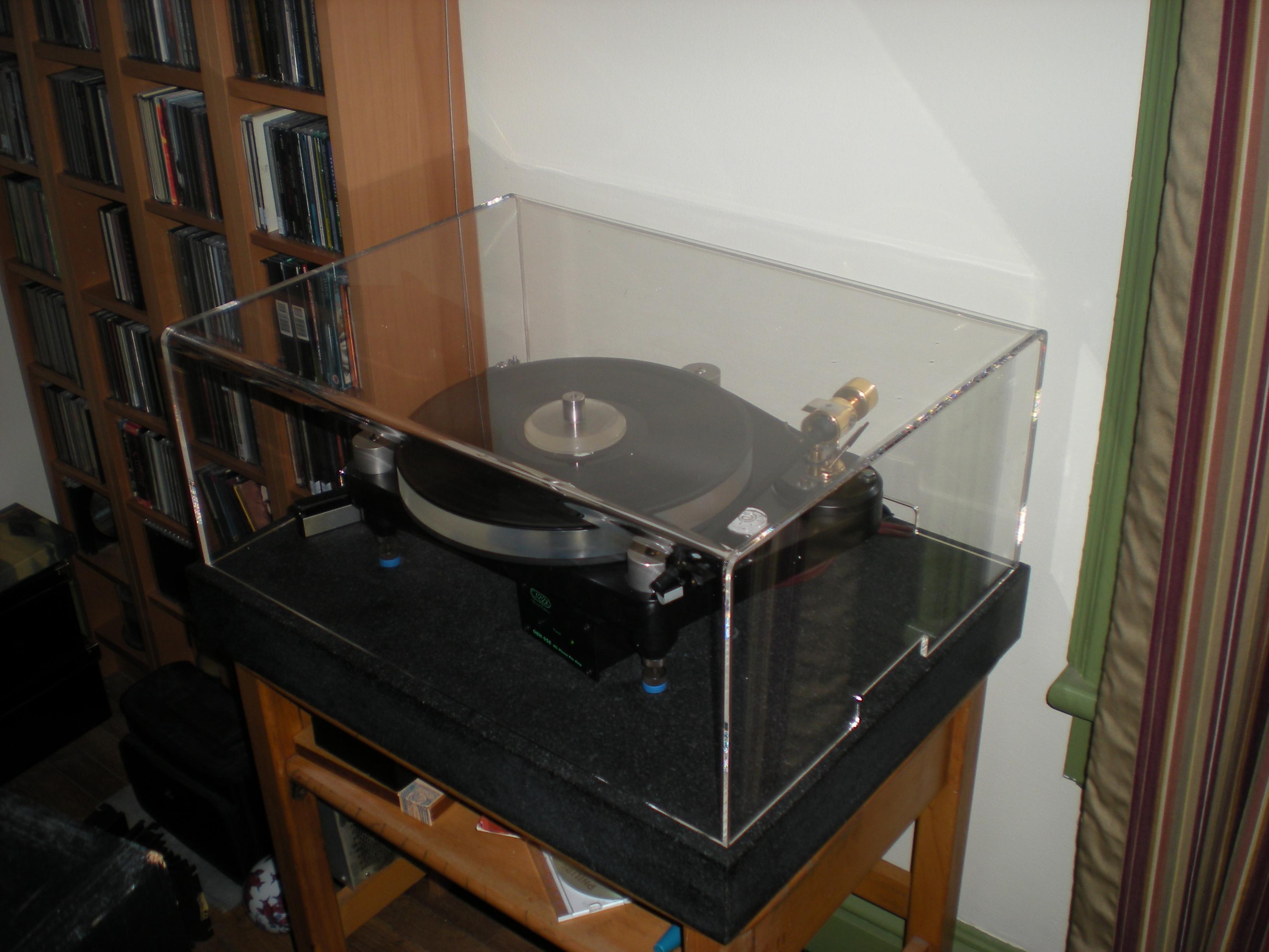

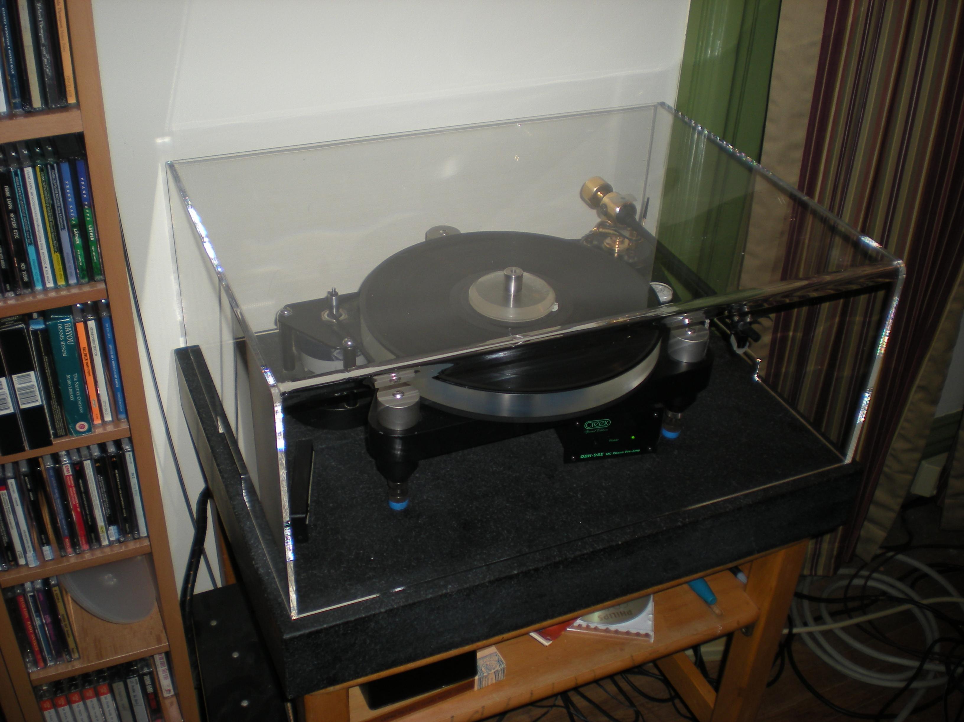

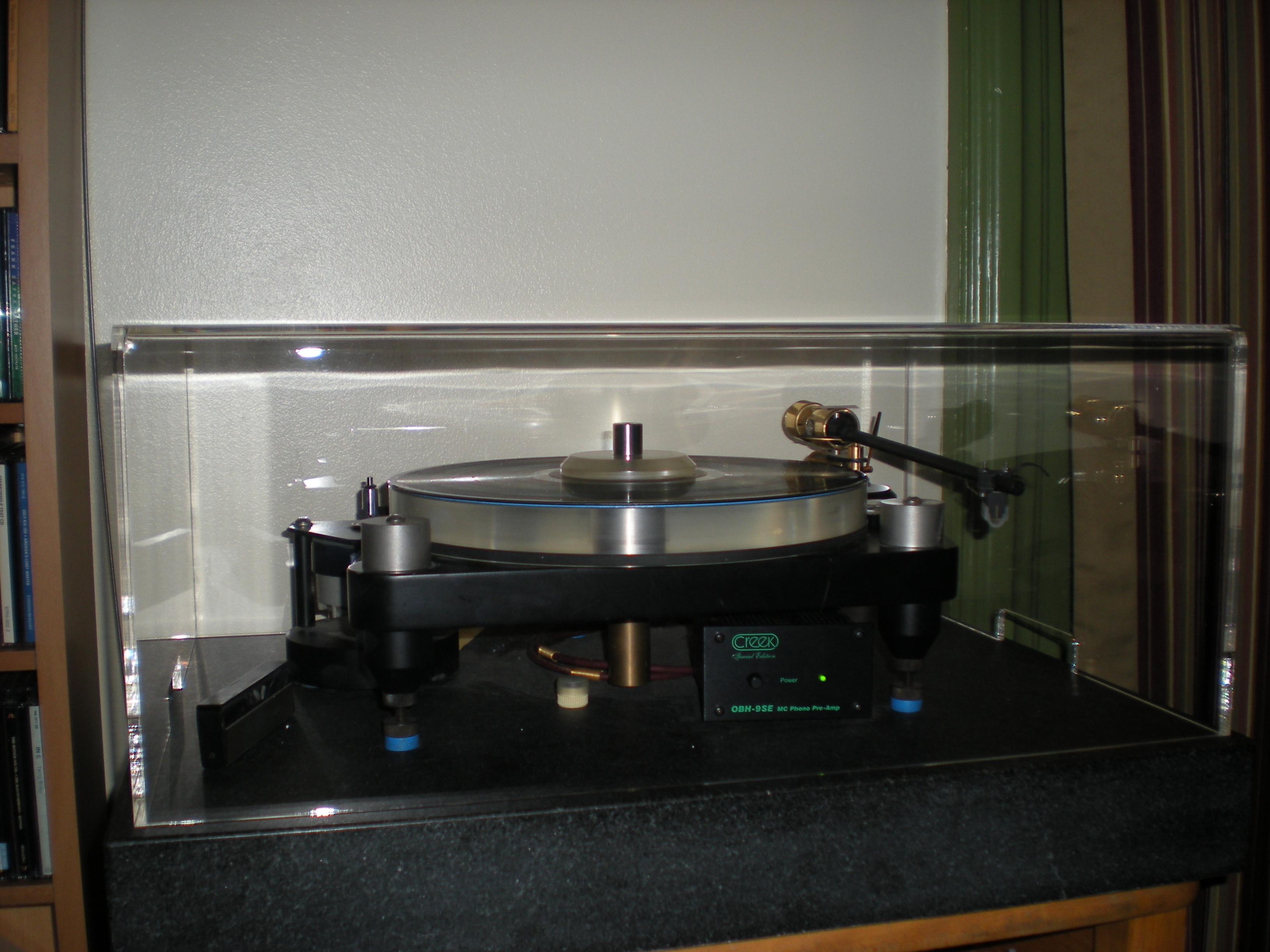

Here are a few shots of mine. The plinth and the platter are acrylic, the whole thing sits on a granite surface plate isolated with some EAR Isodamp grommets. The motor is a surplus 900 RPM hysteresis synchronous capstan motor, for extremely smooth rotation. The spindle is machined from non-magnetic stainless steel.
I built this around 1990, when I had access to a machine shop.
