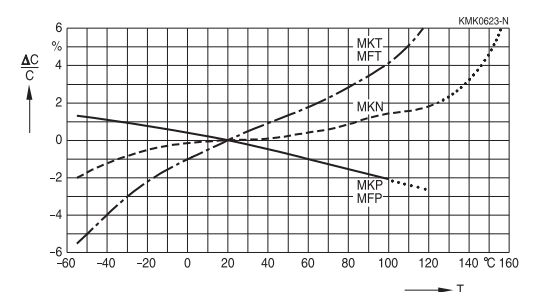

CBB is Chinese for MKP, metallized polypropylene film,
... most of the time 🙂
If you want to be sure, throw it in the freezer, and measure the capacitance before/after: true MKP has a negative temperature coefficient, i.e. the capacitance goes up when the temperature goes down. Polyester (MKT) is the opposite.

Tried your suggestion last night (5-6 hours in the freezer) and the capacitance hardly change.
If I have to guess, the change is less than 0.5-0.75uF which I think is not enough to definitively conclude that the capacitor is MKP or not?
In saying that, I'll try again but this time I'll freeze it longer.
Yes, you can read it on the graph: between +20°C and -20°C, the change is about 1%.
As long as the capacitance goes UP in the freezer, it's MKP.
Alternatively, if you're brave, set your oven to 80°C, and your cap should go down by 1.5%. It'll live, btw.
And yes, you can combine freezer and oven if your cap meter is really crappy.
