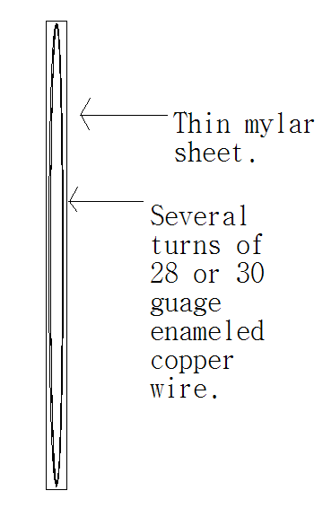

Here is a pic of what the exciter in the SI Soundpads looks like. I have four of these I would be willing to let go for cheap. I've had my fun with them; I'm over it.

The Arias were pretty well optimised in terms of balancing the needs for low moving mass, low inductance, efficiency and long throw, given the magnet materials we had then.
Efficiency is defined by the moving mass, the coupled radiating area, and the motor's BL product - that's B (field strength) x L (length of wire in the gap), usually quoted in Tesla Metres (Txm).
So in theory there's four ways to increase efficiency: Reduce the mass (but we already did that), increase the coupled radiating area (not so much make the diaphragm bigger, as make it stiffer), increase the L (but it then gets heavier - or shorter) or use a more powerful magnet system (possible nowadays with neodimium, but a serious engineering job).
Maybe the thing to do is to buy the most efficient full range driver you can find and cut it up for parts to make your own exciter. But most of these sort of units have very little linear throw - they try to get as many turns as possible in the gap, so you won't get much low frequency headroom. But it might be worth a try.

Paul,
thank you for your help. I intend to use the magnet of a prosound mid or midbase speaker to do some experiments. How much y-max did you use in the Sumo Aria?
In an earlier post Moray wrote you used 150 gauge Mylar HS.
Do you still know the dimensions of the membrane?

Zelter,
They were 50 x 75 cm.
By Y-max, do you mean X-max? I can't remember, to be honest. But it was something around +/- 6mm linear throw.
