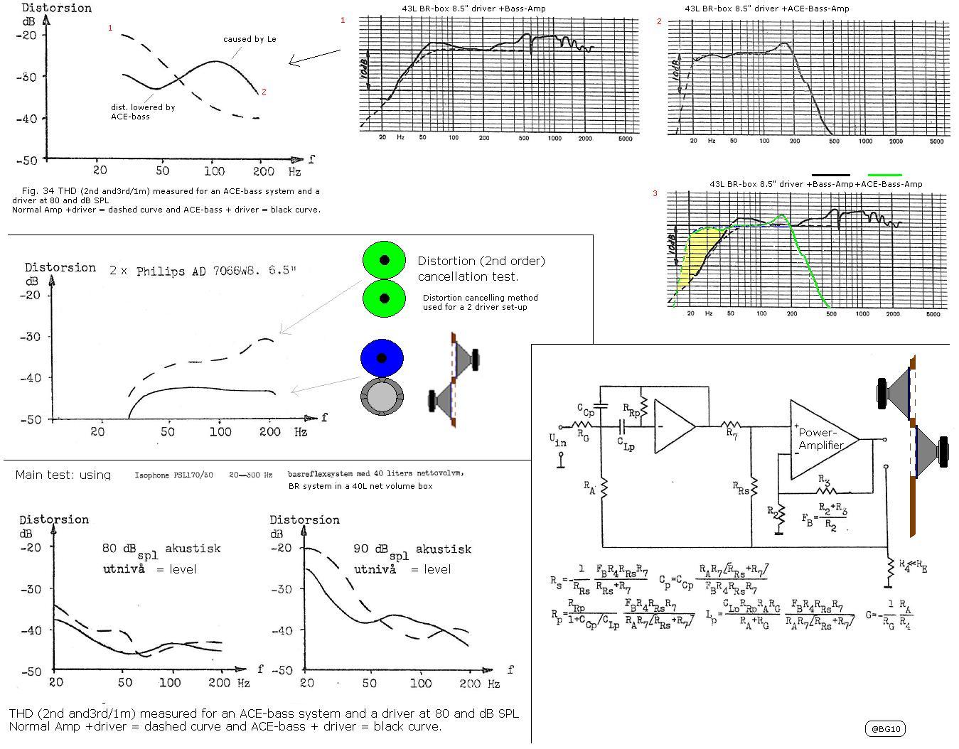

Hi grandfank,
Have you measured distortion before and after applying your circuit?
FYI, A picture showing ACE-Bass distortion figures to compare with:
b🙂

Hay, bjorno!
I talked about the distortions introduced by my sensor and it generates a perfect sine curve, which is the approximation to an iron bar only changes in amplitude without distorting the shape of the curve. He has simmetrical (as multivibrator) generator. But, as I have said, he has no linear characteristic, ie its sensitivity to positive and negative half-waves are not much different. In this respect, the same linearity has not, in my opinion, and capacitive sensors, but they are susceptible to external factors such as humidity and temperature is probably yes.
Actually nor any measure, I did not hold. I just wanted to show you all your sensor and propose to use it because of motional feedback did not see a problem why he is in this case would not help.
Your graphics are very dull and hard to parse that either.
Thank you.
Thank you.

Hi bentoronto,
Just click at the thumbnail and the picture will be magnified but then you must also click at the lower left corner for further expansion..
b
...Your graphics are very dull and hard to parse that either...
Hi grandfank,
I guess you have similar problems to magnify the picture as bentoronto hereabove?
b
