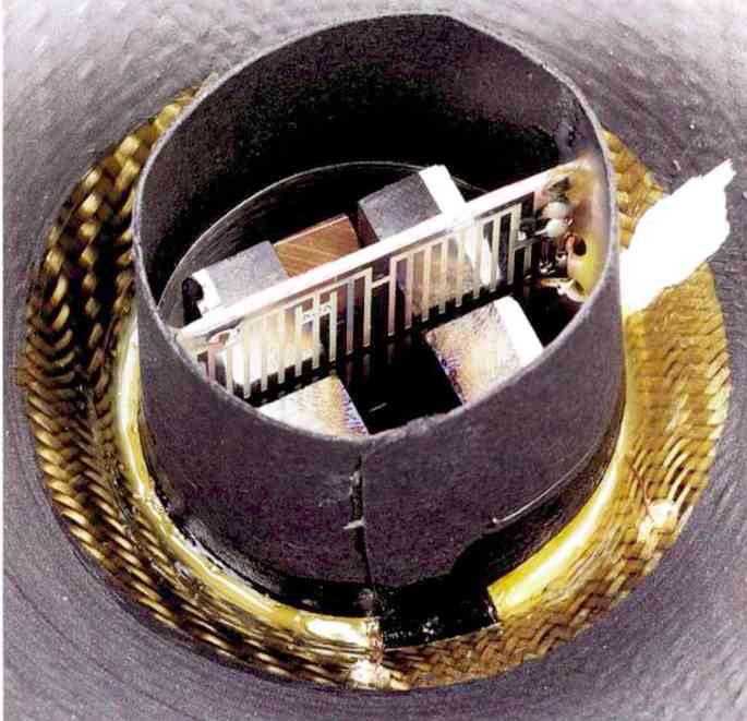

This picture from a 25 cm Backes & Müller sub was discussed in a German forum. An inductive sensor will monitor the velocity of the voice coil.
Apparently, there are four rectangular (ferrite?) magnets, setting up two gaps of the same or opposing B direction.
There is one trace in the center of the PCB that sits at the upper end of the gaps. The voltage induced in this trace would essentially be a half wave with a strong peak every time it crosses the rest position. This might actually be a position detector used for a servo that maintains the rest position of the coil constant.
The velocity sensor is probably a coil that runs around the circumference of the PCB, so the trace at the upper end might make up 1/4 of that sensor. As the VC and hence the PCB moves, the area that is inside the gaps changes and if the field in those gaps is homogeneous, a voltage proportional to the velocity will be induced. If it really works this way, the two gaps would have to have the same orientation.
The questions we could not get a satisfactory explanation for are:
- why the use of two gaps rather than one large one?
- what is the function of those fingers on the center trace that we presume is a position detector? The are parallel to the motion of the VC, so no voltage gets induced.
Intriguing. There is a different finger pattern on the left with something that looks like a type number shown. I wonder whether those fingers have maybe a mechanical or dissipation purpose. Another possibility would be a capacitive sensor. Would it be possible that the inductive part senses the mechanical mid point position and that the fingers are part of a capacitive pick-up to sense the velocity and/or position?

Back to induction:
Those textbook pics of loop area A and dphi have made me blind. There is absolutely no need that the trace run around the circumference of the PCB, the loop can be closed anywhere as long as it is not inside the gap.
So a single trace centered in the gap is enough as a velocity sensor.
Any trace that does not sit in the center when the driver is in rest position is more like an overexcursion sensor. This might be the function of the trace at the top of the pcb.
Still does not explain the function of the trace that sits exactly at the top of the gap and has the fingers.

Well, if the fingers have a mechanical purpose, they would keep the center trace from moving relative to the PCB, but this seems overkill...
Also, one would want to do this only for the velocity pickup trace where excellent linearity is needed, not on something like a position or overexcursion sensor.
Coming to think of it, maybe the picture was taken with the cone pushed up, so the fingered trace really IS the velocity pick-up?
Already got a reply. Seems he did push up the cone while taking the picture.

I still have no explanation for the vertical fingers on the sensor trace. They certainly have no inductive function

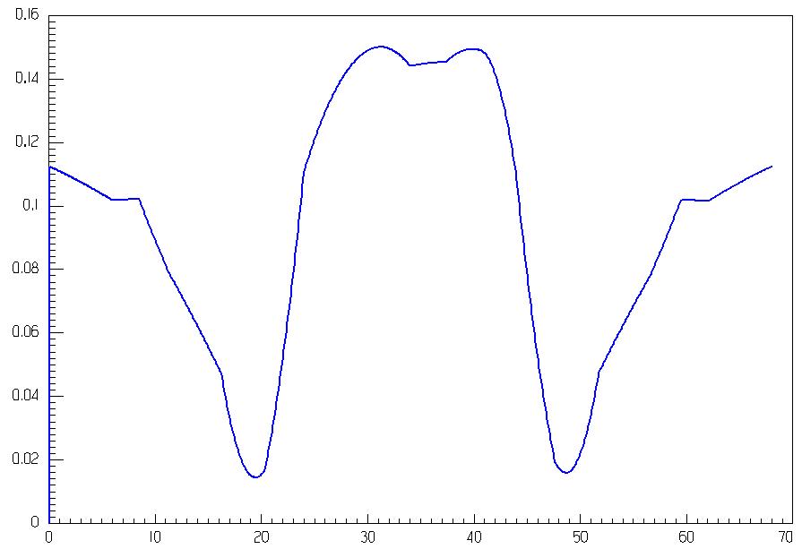

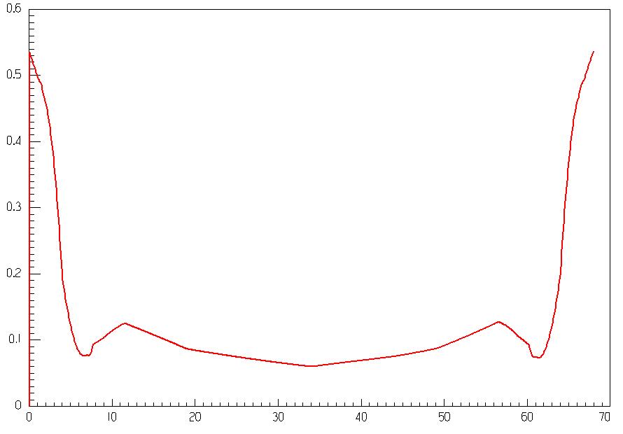

Of course. But, can you draw flux density between the magnets?
You will find a huge flux nonlinearity in the gap. (picture)
The fingered trace is essentially vertical and sits in the vertical center of the magnetic gap in rest position.
In the rest position the flux between two magnets is theoreticaly zero,IMO.

I still have no explanation for the vertical fingers on the sensor trace. They certainly have no inductive function [/B]
Fingers have thickness. When summed, they are practically half of the main trace lenght.

Ummm... <scratches head>
Perhaps the acrylic block with the vc pattern is square, and the gentleman installed it 90 degrees out??
Which seems to make more sense, but the pattern seems broken in the middle, which is puzzling to me as well...
Also what is the possible orientation of the magnets given that they are sitting on top of a pole piece (presumably) that is magnetized with one orientation or the other??

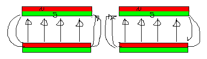

I think we can suppose that the magnetic orientation is like the pic below (top view) -> flux == linear inside the space from sensormovement.

The pic that Milan posted is the field of a single magnet polarized along its long axis.
The BM sensor seems to use two magnets polarized along their short axis and in the same orientation, more like Juli's picture.
However, the field is far from uniform. This is a pic of two Neo35 bar magnets 60 mm long, 10 mm thick and with a gap of 4 mm (I misread the gap spacing, so everything got simulated at twice the intended size). Most of the field wraps around in free space rather than filling the gap. So efficiency is low and the field is not very uniform as one moves along the gap.

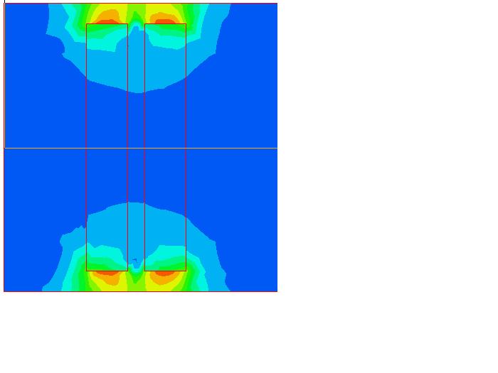

I have tried various versions, with steel back plates on the outward-facing sides of the magnets and also with steel plates lining the inside.
Either we are misreading the picture or their inductive sensor was just not a smart design.
This is actually one of the better versions of the two magnet designs I could come up with. It uses 10 mm steel plates lining a 4 mm gap. The steel plates are about 20 mm long, i.e. somewhat shorter than the Neo35 magnets on the outsides, which are 30 mm long and 6 mm thick.
This is a B-field plot. Note higher field and somewhat improved flatness in the center region. The steel plates were centered symmetrically inside the magnets, however, there was a slight assymetry with respect to the simulation boundary which might explain why we are seeing an assymetrical curve.
