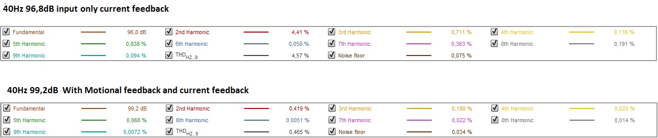

Some measurements as promised (one corona-period ago) on MFB and CFB Dipole Woofer.
Happy to say that it works really good!
I have struggled to improve the phase margins at both LF and HF in order to maximize the feedback.
Reached approx 20-25dB in distortion reduction which i consider is enough.
However, once you have started to tweak an wiggle on the knobs, the optimizator nerd in me gets heavily engaged, must be somethin in my nature. 😎
And the sound?
Playing a pure 30Hz sine wave goes from apperent (no MFB) to almost quiet (with MFB) at the exact same output level!! 😱
I hope you get the point... higher harmonics tells you the direction of origin in the room. With MFB it dissapears almost.
