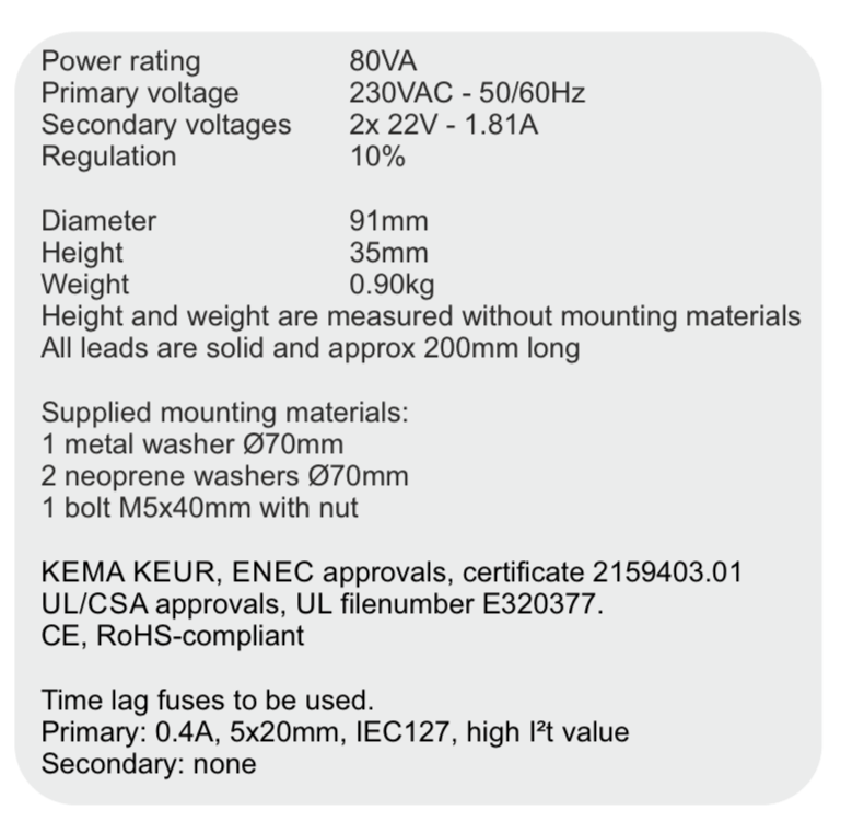

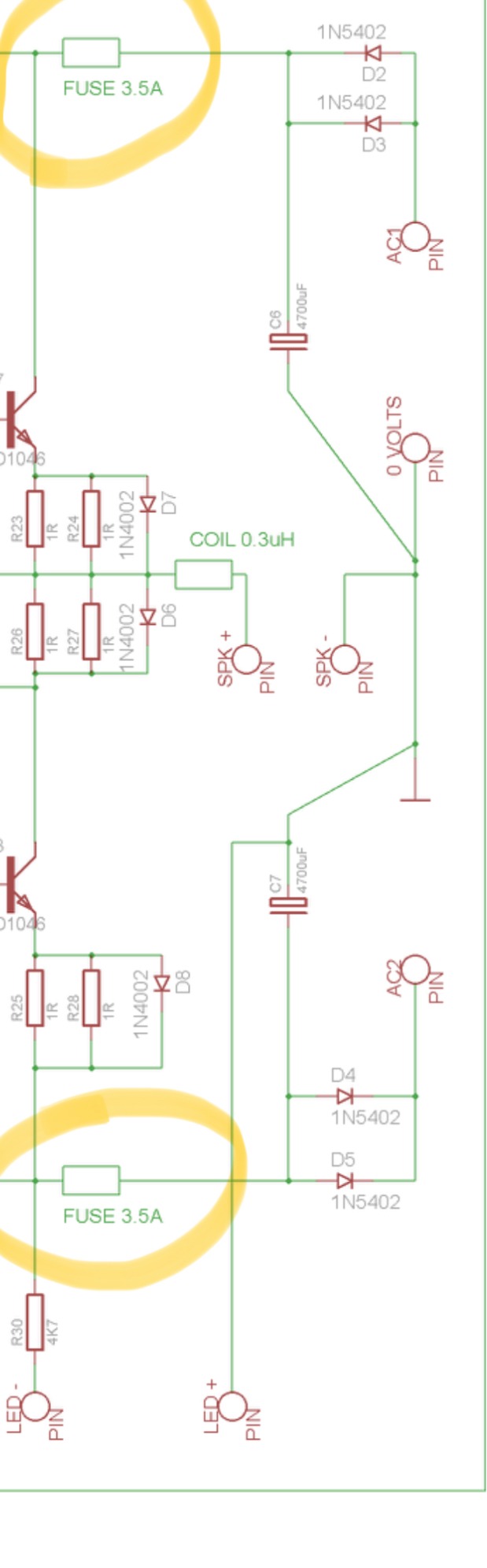

New Amplimo toroidal transformer purchased and recap in psu using Nichicon 5600uf/50v.
Everything seems to work fine but will send to check in bench for idle current / dc offset etc.
Regarding fuses now..
I replaced original rating of 3,5A with 1,8A in secondaries, as is better to follow transformer rating this time.
Someone had placed also mains fuse in pcb. I tried 0,4A as in transformer label but it burned right away just by turning on. So I went to 1A.
Any comments would be great about fuses.
