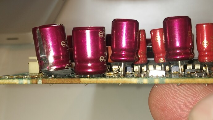

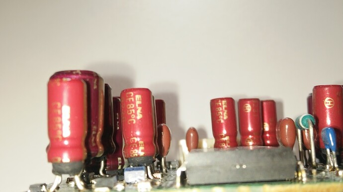

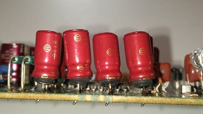

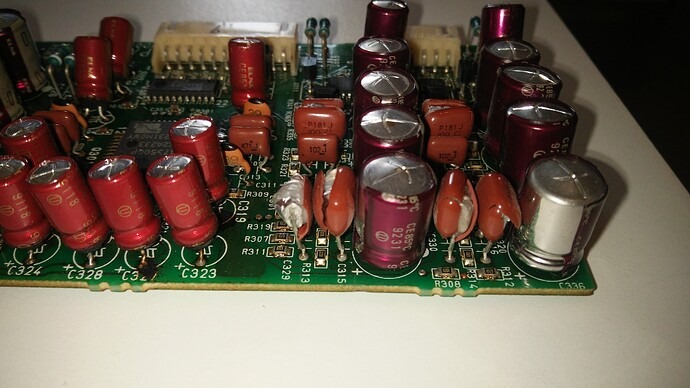

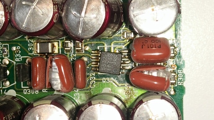

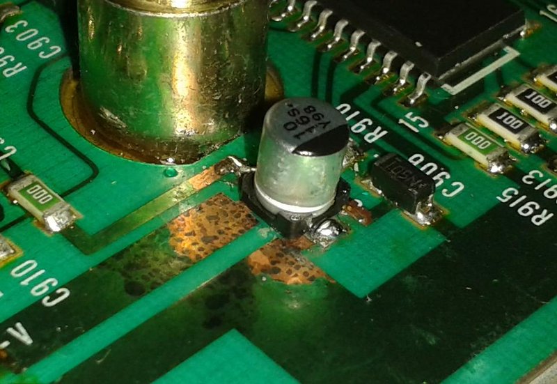

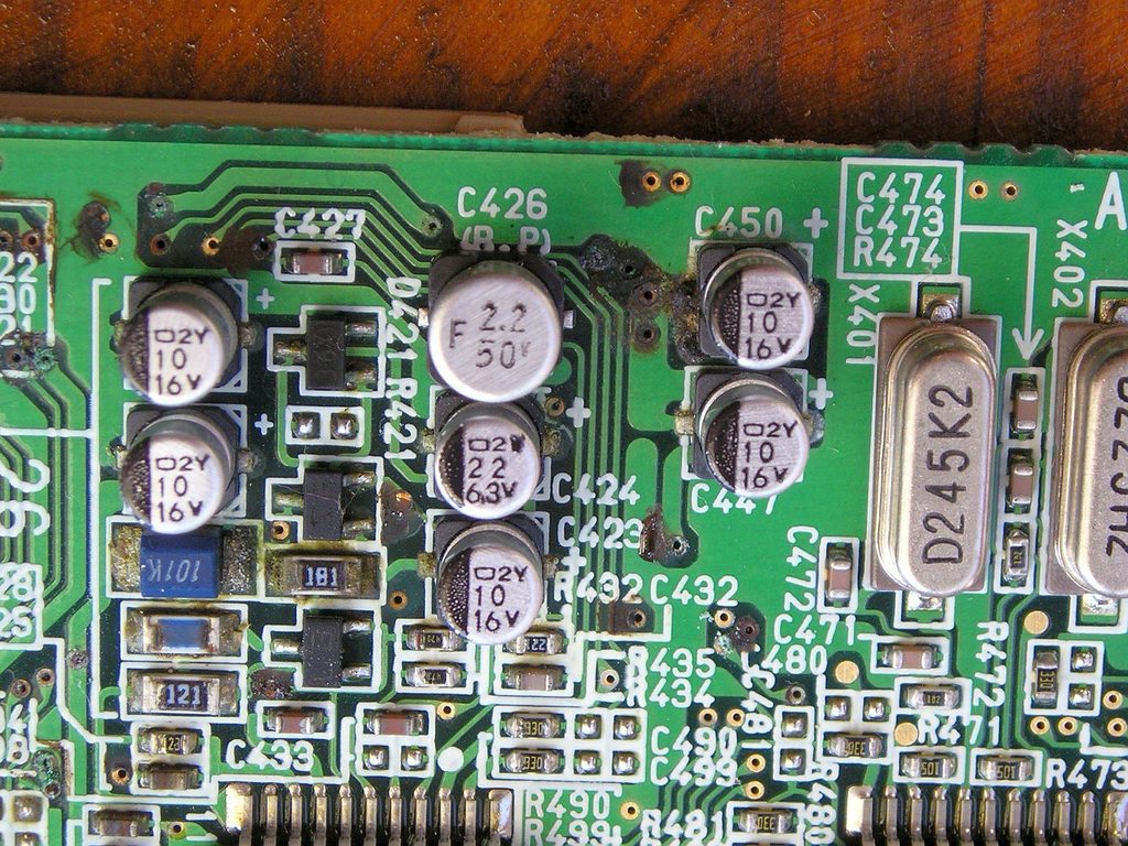

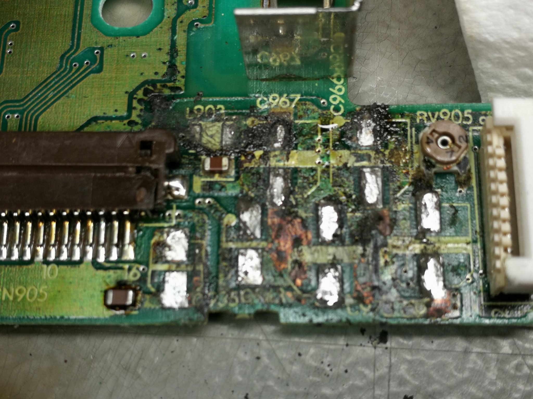

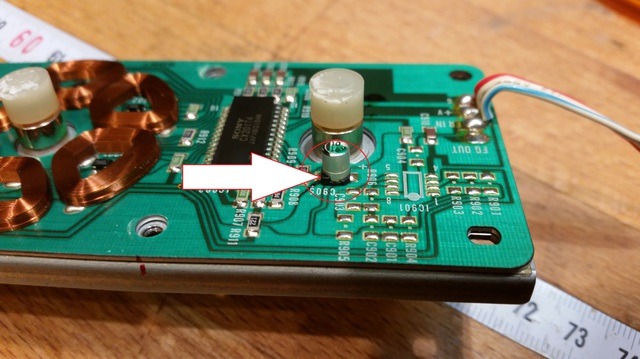

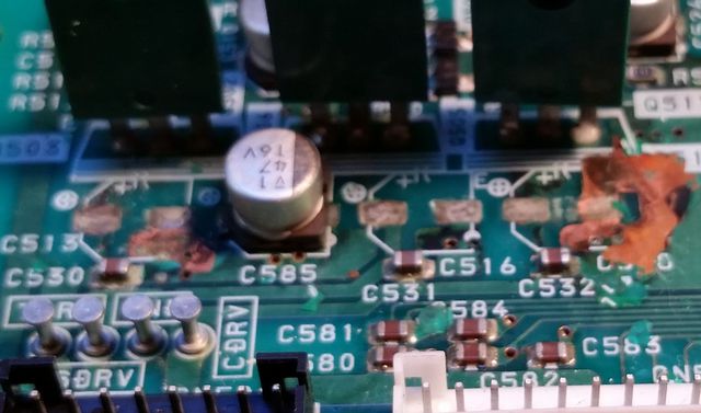

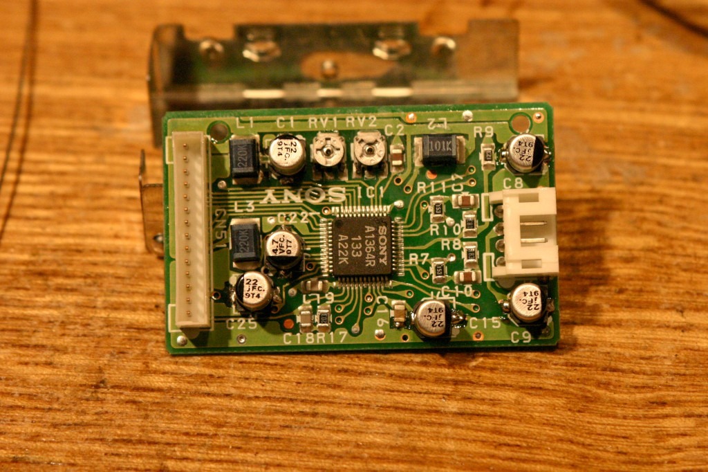

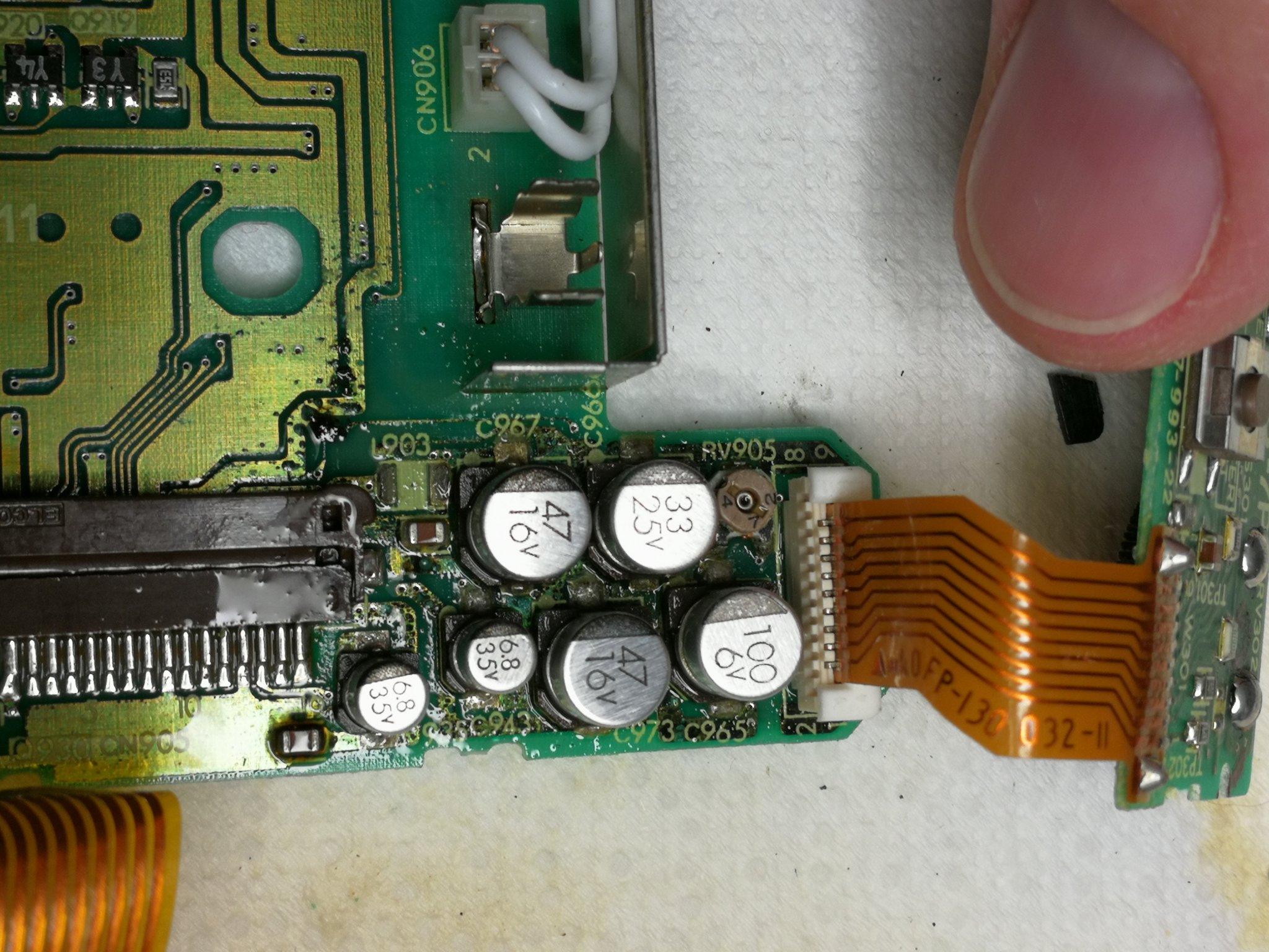

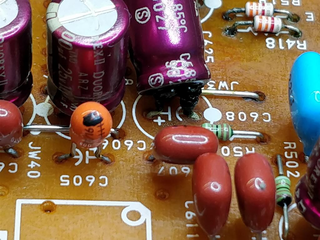

Cerafine and Duorex... both meant to be "for audio" and both garbage.

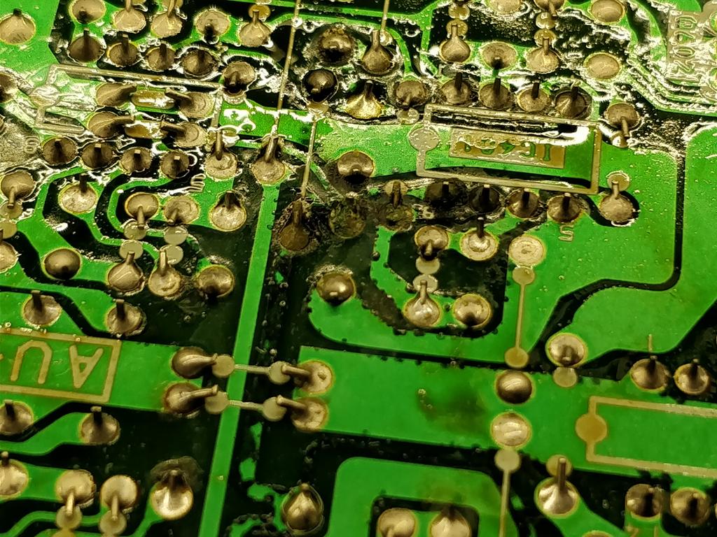

I hope the 5532 in DCC900 is not caused by caps. The device can't have worked properly this way.

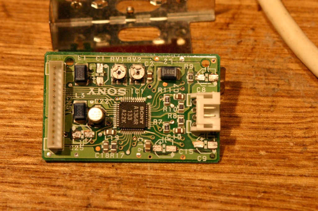

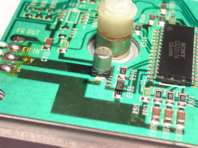

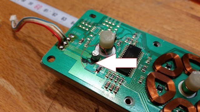

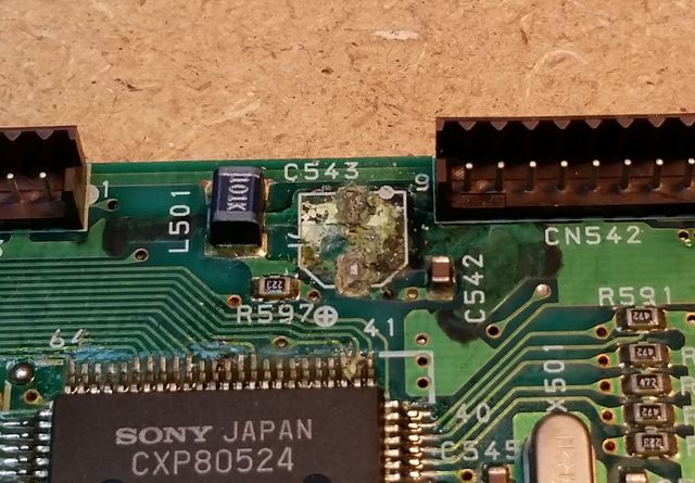

Till today I have rarely seen SMD electrolytic caps go so bad as in the pictures. Was this a just so in a certain period in time or are there still such quality SMD electrolytic caps being produced today?
