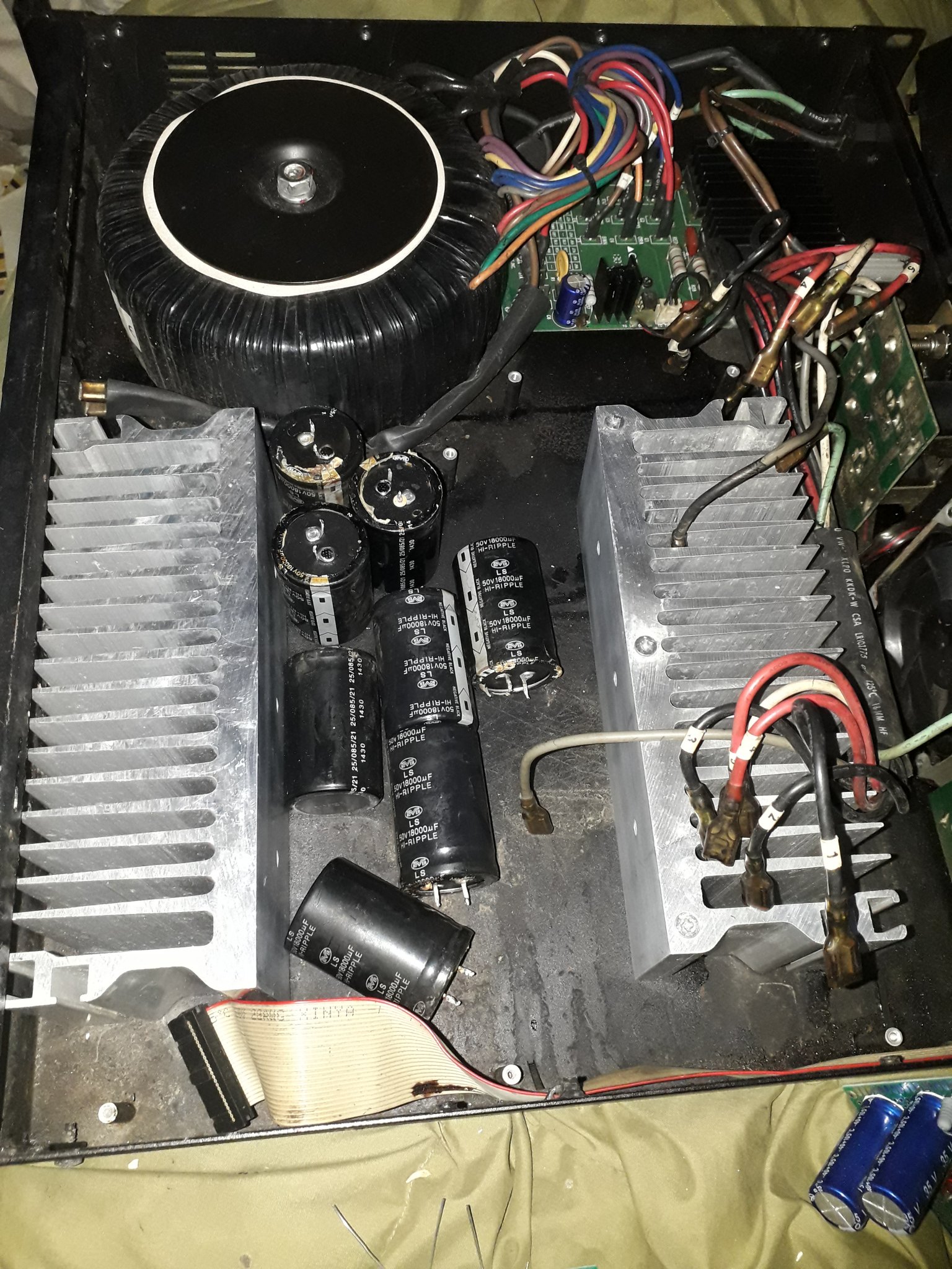

Yesterday I got for free a broken QSC RMX1850 HD, one of the earliest QSC to introduce a switching class B for the upper part of a class H amplifier.
Apart from being a very heavy unit employing 4 rectifier bridges the only thing that was completely fried was the protection circuitry on one channel..I mean everything starting with R4...and not a single power transistor, not one!
I'm thinking to remove all the protections , scrap the class B upper part of the amplifier , remove 8 power transistors, rewiring everything for half rail replace the heatsinks with the vertical flow ones, screw some holes into the case for air convection and I'll have the most reliable 120 watts/8ohm amplifier with that 10 kg transformer...thinking of faster transistors, rectifiers and op-amps too , 0.44 ohms instead of 0.22 ohms emitter resistors as in the older versions and maybe the kenwood l-01a driver stage rewiring 😉

NOW you see why you never do without DC protection, and why you should NEVER use a @#$&*% triac crowbar on the output of a solid state amplifier for the purpose! Time to buy a new PCB - translation in practical terms: new amplifier. $400 for a PCB module and $200 service fee and you still have an old amp full of dust and cigarette smoke. Which is why you got it free.

well...in my country nothing is really for free...NOW you see why you never do without DC protection, and why you should NEVER use a @#$&*% triac crowbar on the output of a solid state amplifier for the purpose! Time to buy a new PCB - translation in practical terms: new amplifier. $400 for a PCB module and $200 service fee and you still have an old amp full of dust and cigarette smoke. Which is why you got it free.
Anyway...this amp worked for 12...15 years in the biggest disco around here regularly at clipping volumes...I'd say it did its job for a made in china product.You need to see how bad the heatsink is.Besides the filtering caps are simply dry...weighing almost thhe weight of their aluminium cans...
And it is naturally DC protected as the output is capacitor coupled as in all qsc products. Good speakers are way more expensive than amplifiers . I fixed one qsc USA 1310 amp in the past ...that had about 4 tranz bvurned...just replaced them...It worked for another few yeras patched like that.
And what's wrong with the crowbar? That's the only professional way to protect your power electronics and it works...It obviously worked here even if it died.By the way, the triac isn't dead, just the pcb 🙂

This version is not “naturally DC protected”. The center tap of the power supply IS connected to the center connection of the rail caps. Unlike earlier designs where the center between the rail caps actually floats. This change was necessary in order to accommodate the class H stepped voltage supply. You can get DC to the speaker here - which is probably what happened. If the rail caps are dried out that may be why. I bet they didn’t go down evenly - resulting in uneven clipping which puts out an average DC, which then shorted the crowbar and it just stayed that way till the board toasted. PCB mount caps never hold up under long term high ripple useage the way computer grade soup can caps used to. After 12 to 15 years of disco duty it doesn’t surprise me at all - I’ve re-capped plenty of those old QSCs. The crowbar did protect the loudspeaker - but for the club owner was still out $600 for a new amp. Probably a class D that will fail in a year or two instead of 12.

If you look carefully at the schematic for the 1850, there are two connections labeled “CT A” and “CT B”, where the trafo windings connect together. The amp shows “CT A” connecting to the speaker output node between the supply caps.
The class H rail switching will not work properly if that center isn’t nailed down. The mid rail voltage, relative to the upper rail voltage will wander around depending on loading, rather than staying at about half. The class H versions aren’t as fault tolerant as the old classic models because of this, but the heat produced in regular class AB at these power levels is unworkable. The RMX is still a pretty solid design - their install versions are almost identical circuit wise - just some re-packaging and adding features like 70/100 volt output trafos.

The output is kept quite firmly by the op amp's dc refference while the class B stage on top is refferenced between supply rails .I'd say using the mid transformer tap is allowing for lower quality leaky capacitors , not so sure it has anything to do with the crossover switching of the class b amp.The class H rail switching will not work properly if that center isn’t nailed down. The mid rail voltage, relative to the upper rail voltage will wander around depending on loading, rather than staying at about half.
But the relative voltage between upper and lower rails will move around. Even with perfect capacitors if the load on the lower rail is higher than the load on upper rail, the lower rail gets dragged down much faster if you are just relying in series capacitors to divide the voltage. Resulting the the VCE on the output transistor being much higher when the rails switch.
If this actually worked properly without the supply center tap no one would bother with the multiple coils. You would just use a stack of four capacitors fed by one transformer winding and tap the rail switches at the nodes between them. I’m sure it’s been tried, and failed with a string blown output transistors to show for it.
It works for a single set of rails because the average loading between the two is the SAME.
