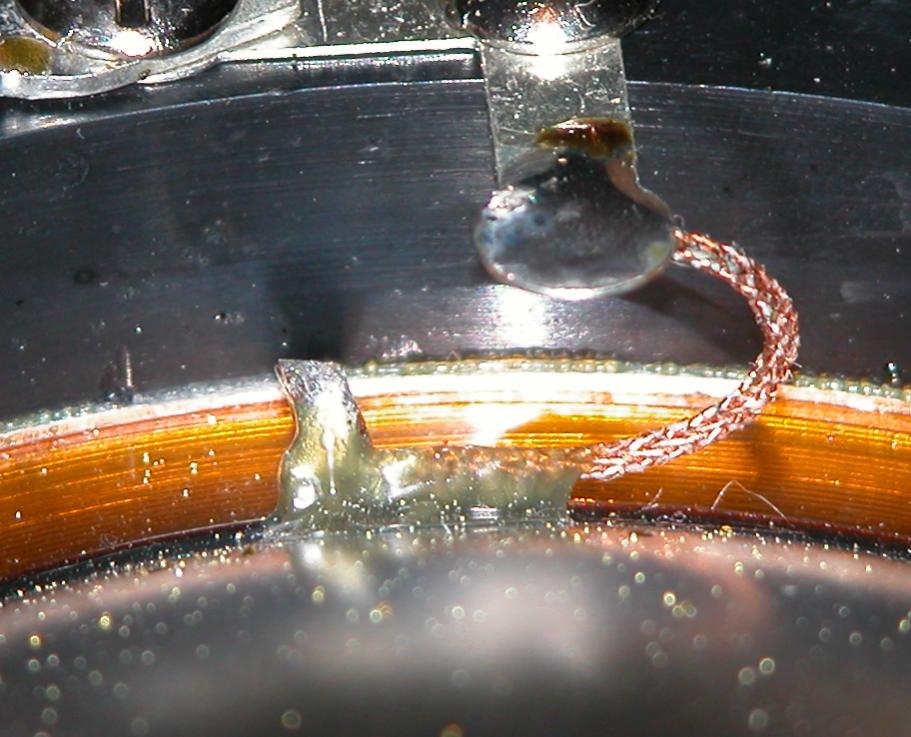

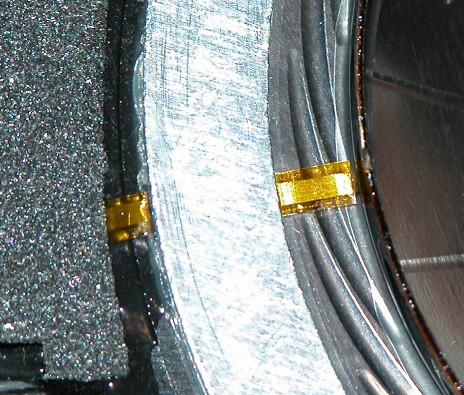

Cool, thanks for the photos. The flat strip is typical, the braid isn't - at least not in the drivers I've used. And the flat is often where the break is, even in normal abuse.

Ummm... the braid takes more thermally... quite standard... the failure of the kapton + trace seems to be at the point where it meets the inner edge of the surround/diaphragm interface. Looks like it burned out. Fuse wire.

I dunno. Certainly it could be a problem. BillyDoc IS trying to break stuff with sound, after all! But at the moment I don't think that is what killed the drivers.
As you said yourself:
(emphasis mine).. the failure of the kapton + trace seems to be at the point where it meets the inner edge of the surround/diaphragm interface. Looks like it burned out. Fuse wire.
Did it break from too much current or from too much excursion, or both? The rest of the diaphragm looks undamaged.
There are a couple of things to do to test it. And if it were my rig, I'd test it.
1: Run the woofers only - and at least 1 good compression driver 'fram in place. Short the 'fram or connect it to the amp (no signal) so that it has some damping. Does the SPL from the woofers destroy it when it's not being powered?
2:Run only the compression drivers at the full level. Do they break? If so, it's not the woofers causing the problem. (Check for amp clipping!)

Morning Gentlemen,
Let me answer a few questions:
The correction in the third-octave just above 300 Hz was about 6 - 7 dB of extra power to flatten things out, tapering to nothing in 3 or 4 third octave steps.
The meter used is a Larson Davis LXT model with a high level microphone originally designed to measure artillery noise. I forget how high it goes, but definitely above 140 dB. The SL meter also has internal software for the third-octave breakdown, dump to computer, etc., and is calibrated to NIST standard. It wasn't cheap!
We haven't found any indication of a burnt out voice coil at all. All damage seems to be purely physical, and consistent with excessive diaphragm excursion. The way the Pyles are constructed the back side of the diaphragm is open to ambient pressure via cracks between several loosely fitted parts, and has more than enough room to travel to destruction. If you press on this diaphragm from the horn side you can see it come back and simultaneously twist on the horn axis. It quickly pulls the ribbon leads up tight . . . and that is what I think broke them off. It's a big diaphragm so just from a "pneumatic" point of view capable of developing a lot of force. On the other hand, it takes quite a lot of force to displace it as well, so I can't be sure. Instantaneous pressures can't be all that high in absolute terms, and these diaphragms are pretty stiff.
Oh, OK. That's new info, then. From you descriptions and photo before it looked like a burn out of the ribbon going to the VC. You don't think it is?
Still; if it's over-excursion causing the damage, is the excursion caused by the power applied to the drivers, the bass SPL modulation, or both? At this point we don't know, it's all conjecture. I still think you should test.
