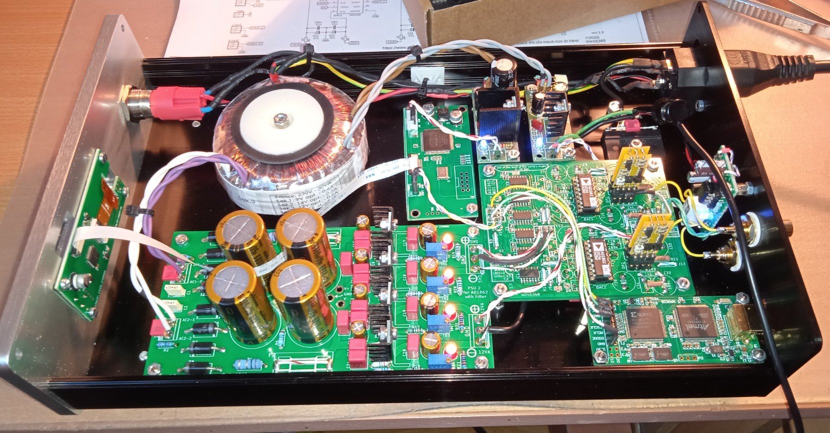

I have built several DACs with USB, SPDIF and Toslink inputs. I mostly listen to FLAC files from HDD using PC and USB connection. It gives me the best results, and I love watching historical videos of concerts and other music videos on YouTube. Compared to everything else, it is the most comfortable for me to use.
I agree with everything, a good system.I have built several DACs with USB, SPDIF and Toslink inputs. I mostly listen to FLAC files from HDD using PC and USB connection. It gives me the best results, and I love watching historical videos of concerts and other music videos on YouTube. Compared to everything else, it is the most comfortable for me to use.
And building a DAC yourself is definitely a quality goal.

If you ever decide, this is simple and sounds very good. Much better than any factory DAC for the same money. My recommendation is AD1862 + AK4118 SPDIF receiver + Amanero USB/I2S board. AD1862 is a true Vintage multibit DAC (20bit). It can also be only AD1862 + Amanero as USB only DAC, or AD1862 + AK4118 as SPDIF/TOSLINK DAC only (for those who like to burn CDRs.).I agree with everything, a good system.
Use this link for more details:
https://electrodac.blogspot.com/p/dac-ad1862-almost-tht-i2s-input-nos-r.html
Note: 8th pin on the I2S input header is missing connection with the GND (on some of my PCBs this pin is unconnected, if you are going to use it, solder it with the nearest GND pin on the header)

Nice!If you ever decide, this is simple and sounds very good. Much better than any factory DAC for the same money. My recommendation is AD1862 + AK4118 SPDIF receiver + Amanero USB/I2S board. AD1862 is a true Vintage multibit DAC (20bit). It can also be only AD1862 + Amanero as USB only DAC, or AD1862 + AK4118 as SPDIF/TOSLINK DAC only (for those who like to burn CDRs.).
Thanks NIXIE62.
If i had to decide this could be a good choice.
