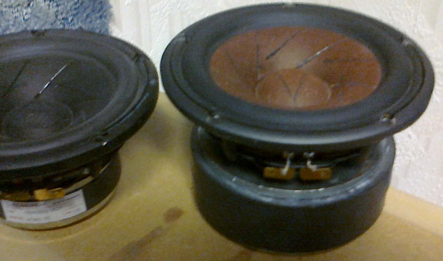

1)version A-stock scan speak 15w frame,cone,surround,spider is original but hardened. VC 50mm from scan sepak 26w revelator, magnet from scan sepak 26w revelator
2) version B-stock scan speak 15w frame,cone,surround,spider sourced from Focal . VC from scan sepak 26w revelator, magnet OEM Scan speak (built to specifications- 1.5mm larger hole- for 50mm but 4 layers coils.
3) version C-stock scan speak 15w frame,cone,surround,spider sourced from Focal . VC from scan sepak 23w4557 subwoofer, magnet from scan speak 23w
4)version D-stock scan speak 15w frame,cone,surround,spider is original. VC 42mm from scan sepak 18w4545 clasic, magnet from scan sepak 18w4545
actualy cones was sliced wood fiber ,not sliced paper, but astill scan speak made.
Version 4 was safiest shot to drivers mechanical structure as the only thing I change its VC diameter, and magnet. unfortunatley after measurements and testings i didnt finded any SIGNIFICANT improvement on power handling (~+30w) until coil started to heat and resitance went up. eficienty reduced by 0,8db. it sounded better but not so much that would be trouble worth

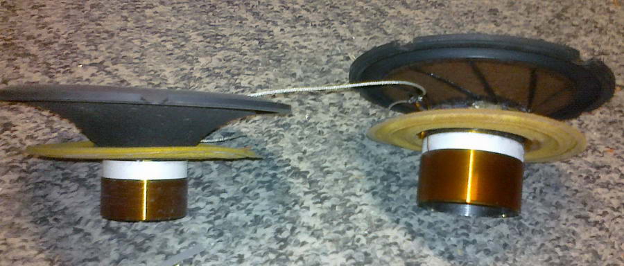

versions A/B/C needed reworked structure as 26 and 23w had extended cooper rings (SD sytem) and tiny cone would hit in inward at max excursion at same spider level. I lifted basket from magnet by 4mm(5mm for C version) refixed with longer srews and things went better.
coils formers from 26 was need extended by 8mm to fit 15w.i used kapton 50mm VC frmer from peerles xxls subs. glued with ultra strong an light loctite glue.
It took some time to 50mm coils to cone and reworks spiders, srew news holes in magnets but we may pass this chapter.

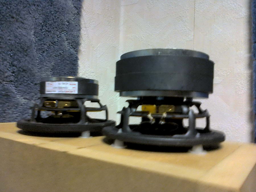

Assembling. there was no questions about mechanical "fixed" centering only "live"- no spider behaviuor is ideal and live centering is the only way to go with excursion like theese on such small spiders. my "insurance" was version B (with extra space in gap) which i belive could be centered and VC do not scrach at maximum excursions. but to my surpsise both 26w coil versions was centered good. I used Technicoll 2 components epothermic reaction glues.1min time which actualy 5-6mins- more than enought to solder wires and prepare generator. most important last 30seconds when glue starts to get hot and it glues strongly. in theese 30seconds I need test in variuos frequencies (10-70hz) and whats important in this case- at extreme excursions.
version C centered also well but i wasnt able to to test it at max excursion(physical drivers contruction limits)
I used lightest glues not not add extra weight to driver(it already have much weightier coil than usual)

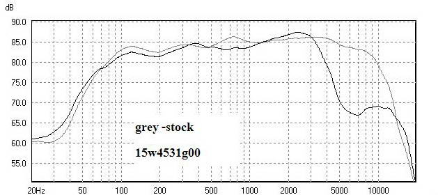

first measurements wasnt a surpsise as a reference i used 15w4531 driver (all prototypes also 4ohms) it have eficienty of ~85db( sensitivity nearly 88db) .
version A was 82db, B 80.6db, C 81.4db D was 83.8db of course frequency response after 3 khz sharply roll of,comparing with stock. but in lower midrange it was basicaly the same form A version.
now excursions - A and B versions have 18mm linear excursion peak to peak, while maximum is so so 24mm C version had 24mm nominal excursion, maximal excursion was also 24mm- as expected too long coil for 15 spider/surround structure.

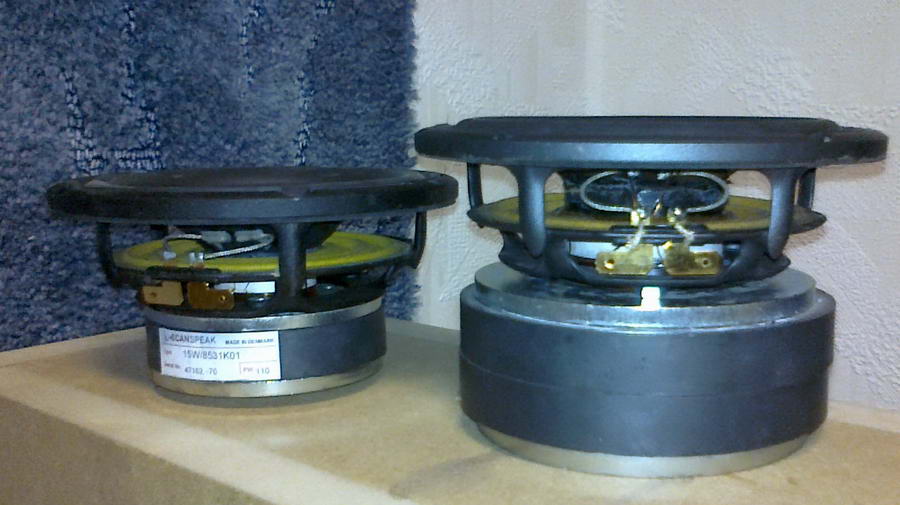

MMs was A- 19g, B-19g, C- 23g, D- 14g
Fs was also on the high side varying from 45-to 65hz depending on spiders stifness I used. on some frequencies spider noises can be heard at extreme levels. one of the driver just started to moove during air-free test!

ataching midfield measurement aligned to 1w/m input(not 2.83v) of succesful A driver. also photo of driver A vs scan speak 15w.

Very cool work, You can clearly see the effects of the large coil on inductance (as seen in the top end response and certainly on the efficiency, but that's neither here nor there for your task (max output in small cab/driver format). Very impressive indeed. I do wonder how long the adhesives will hold up, you'll have serious thermal buildup if you're leaning on that (meaning- sustained high input power) in a tiny little box. A lot of us go for high efficiency and minimum heat, this is essentially 100% the opposite.
