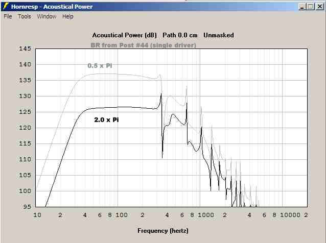

Hi koutrou,
Did you notice the enclosure size in papasteack's example from Post #80? 1812 Litres. And without a back chamber this is a resonant pipe with the offset driver (OD) mounted into the side.
The simple bass-reflex box from Post #44 looks a lot better if you use 0.5 x Pi as your environment reference. It actually gets close to your target, I'll attach an SPL screen @ Xmax.
You have to decide how to realistically simulate the environment for your application (0.5 x pi = large hard surface corner, e.g.: concrete corner).
18 Sound has a lot of very interesting looking "manifolded" enclosures, but they are designed for specific drivers, and putting another driver into those enclosures take a full design cycle to get from the basic box dimensions to the individual volumes and ducts.

with the real dimensions my enclosure is 920 litres (with a close area of the box without it this is 700-750 litres about) ,154cm length , height 62cm and depth 96cm so the results are better also 18 sound driver for manifolded box hase same xmax ,same frequency and about same power , for horn loaded area the recomended 18 sound drivers have same xmax and less power.... so there isnt big problem i think....Hi koutrou,

...BR vs OD, simulation fight !
As if they where something different ^^
Ok, 0,5pi, OD with the same f3 around 35hz (maybe a bit higher...?) as the BR of post #44, and 628L for 2 drivers VS 460L for the BR with 2 drivers. Running both at xmax=10mm : BR Pmax is 500w, OD Pmax is 800w. OD smoothed with 1,5kg polyfill 🙂
Bandwith X f3 X size X efficiency : only a matter of choice !
BR :
OD :
BR :
OD :

Hi papasteack,
I did not mean to say that the BR looks better than your OD simulation. I meant that even though the box is not changed, the BR @ 0.5 x Pi looks much more impressive than the BR @ 2.0 x Pi, that's what I tried to say. 🙂
The BR does have a size advantage, and is probably better behaved at higher frequencies (?), but, it does have the disadvantage of the much smaller port size, which-by the way-also kills a lot of bandpass designs at high power.
Your Dual OD-QWP (offset driver 1/4 wave pipe) has a much larger output cross-section, but, even the small one is big, and you used a lot of dense stuffing inside. The QWP is a valid approach, and one of the easiest to build.
