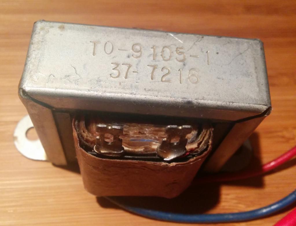

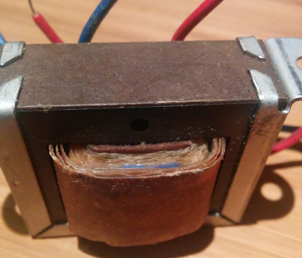

What is the $10 output transformer?
TO-9105-1. Probably made for a guitar amp but: Paper in wax and many layers...so quite some care has been taken to construct them.
This is what I could find about them:
TO-9105-1 5K/8 ohm Output Transformer
Primary 5,000 ohms, secondary 8 ohms, works fine with single 6BQ5/EL84 and 6V6-GT tubes. Mounting centers are 2 3/8 inch apart.NOS OEM surplus made by Ravenswood Electronics for "TMA Wheeling,Ill".

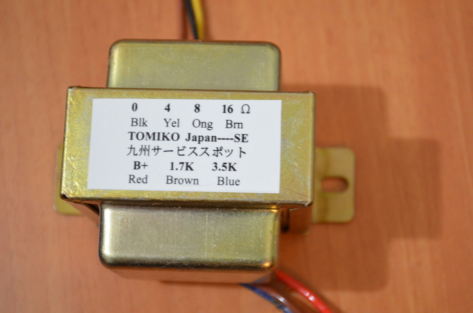

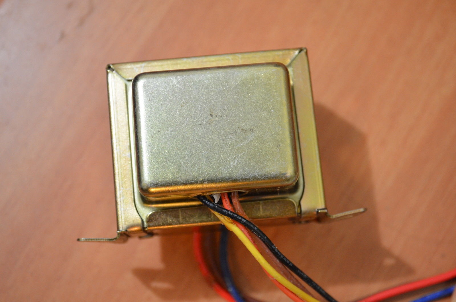

Good job bas! I am using these super crappy tomiko's. I bought 6 of them for $150 (or maybe even less) a few years ago... My loftin-white design, 6SL7 driving 2a3 is my favourite amp now and uses these little disasters. They leak capacitance all over.. make stupid small noise just with the heaters on...I was about to pitch them about a dozen times... but in this circuit they simply shine. 🙂
The 6SL7's are actually russian 6n9s's - I splurged and spent $10 for a pair of them (including shipping). The 2a3's are the cheepest chinese ones that go for $20 each. But I actually got them free from a friend who was just going to throw them away.... I use $1 teevee damper diodes to rectify the mains...
This little amp is such a giant killer too. Its startlingly good and I love it. Took a while to design but I'm glad I built it now. The most expensive part is the Mains Transformer, which is top quality - I got it from Thomas Mayer. I highly highly highly recommend him. The second most expensive part is the Lundahl choke, which I also sourced from Thomas.
The sockets are re-cyled. The wire is whatever used stuff I had on hand. After listening to it breadboarded for a week, I just stuffed it into an old chassis I had from a previous project. The volume control cost a whopping $5.
I always thought it was the parts that made the amp. Not true. Its the circuit! Getting the circuit right is the MOST important thing to do.
No amount of simulation can substitute for actually building it and listening to it either. So if all you do is simulate stuff in Spice, then tooo BAD for you! 😉

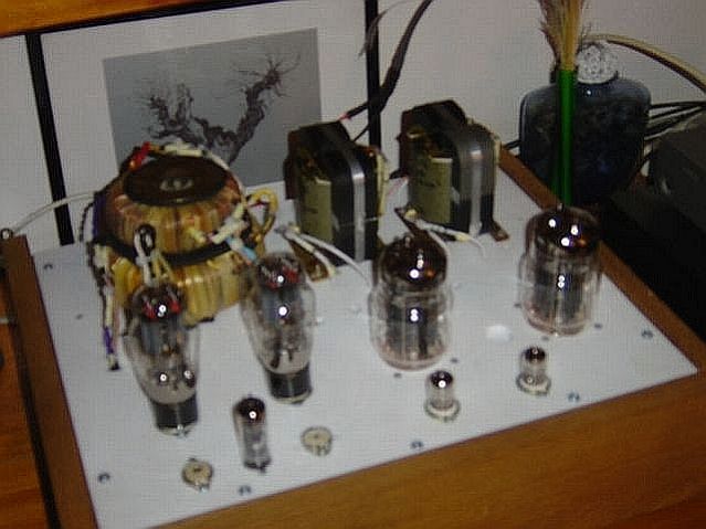

Quite unnecessarily Most expensive parts in tube amps is OPTs.
Let's see. I have own wound OPT for 6C33 SET amp, 9 layers:
- Vacumschmelze SM102-b double C cores with 0.1 mm lamination (from a local second hand store),
- 2 or 3 kgr (forget exactly) CuLL wire (from a local store)
- Teflon insulation between windings (5-6 unwind russian teflon capacitors 56nF/K72) + additional paper insulation between layers.
- Bobin done with material for PCB.
You can see my OPTs in atach. Sorry for the bad picture, it is very old.
Price for this top material was about 50 euros.
What do you think, how much $$$$$$ "brand X" producer asking for OPTs with such top material.
That is the biggest problem, as well as with cables and capacitors. And some tubes also.
