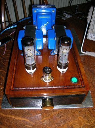

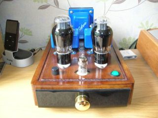

So you see,
We don't know if your trying to make Ongaku on the left.. mortgage money
Or something like this middle EL34 and right 6L6..which was a fun project..😀<<using Edcor..
Sorry just resized the pics..
Regards
M. Gregg

I used Edcor GXSE on the amp shown and XSE on an RH 84.
The RH is lower power sounds nice.. 😀

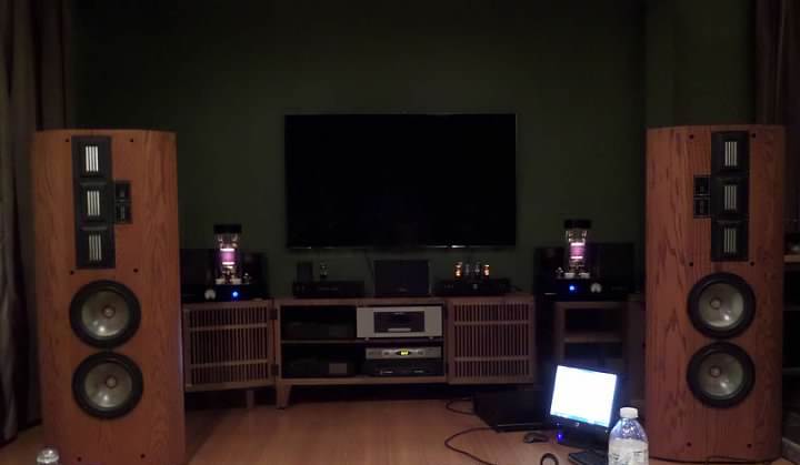

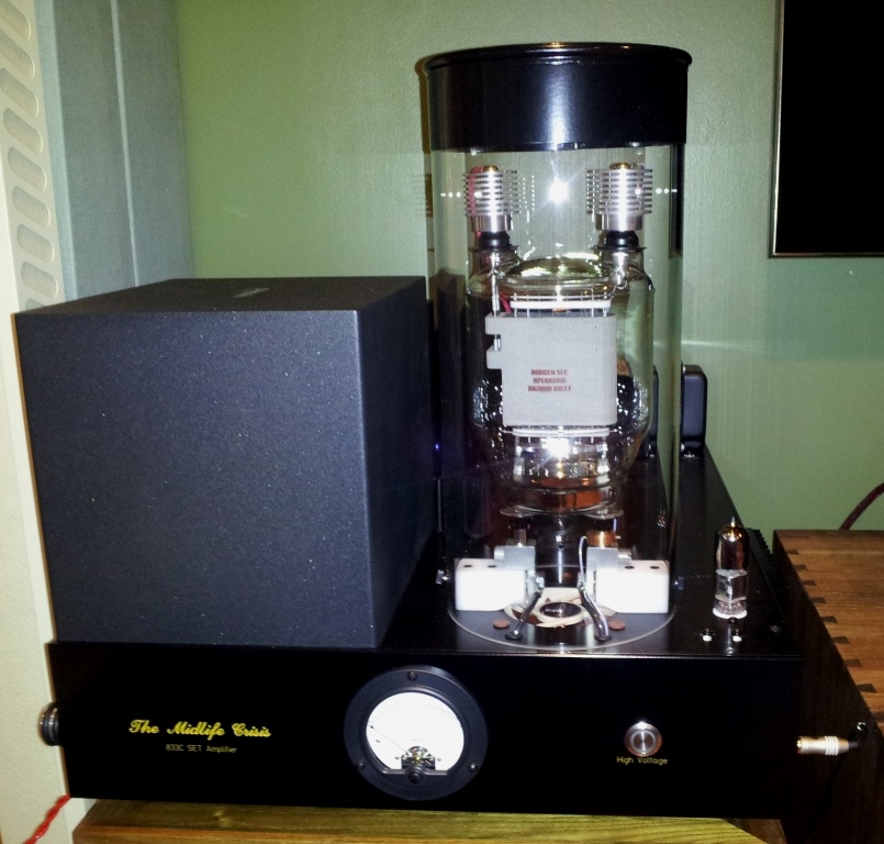

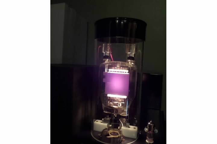

I wonder how much Magz spent on his Monolith output iron for his 833C amp?
I wish I could find the thread where he posted pictures of them completed......they look sooooooo boss!!!
Roughly $5k for two OPTs, plus shipping from Belgium to US, customs duties, etc.
Given the current state of the Euro, however, you could get them about 20% cheaper now, though...
Thread: http://www.diyaudio.com/forums/tubes-valves/232484-midlife-crisis-my-833c-amp-build.html
PS: These sound fantastic with the very inefficient acoustic suspension Infinity RSIIb's in the picture. This is a bit of a special case, however.
