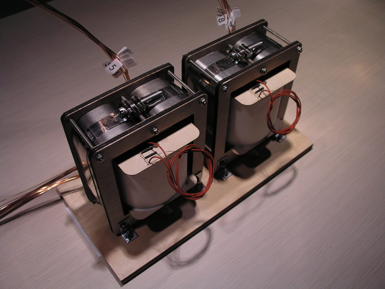

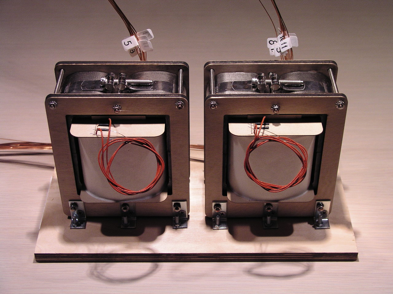

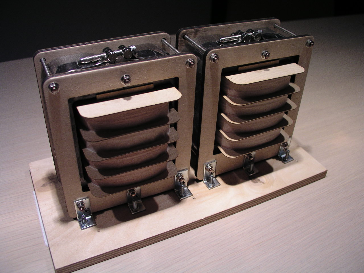

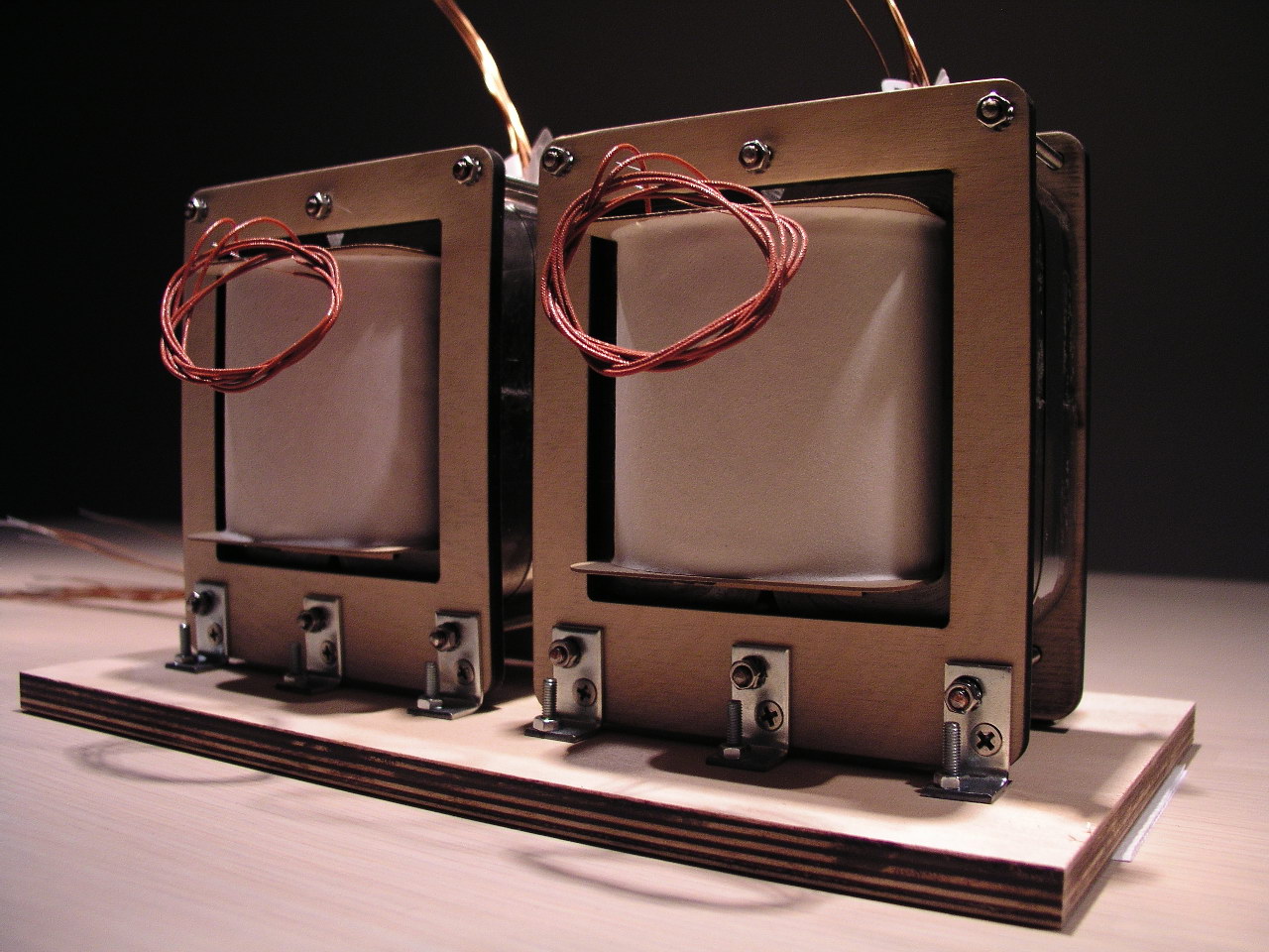

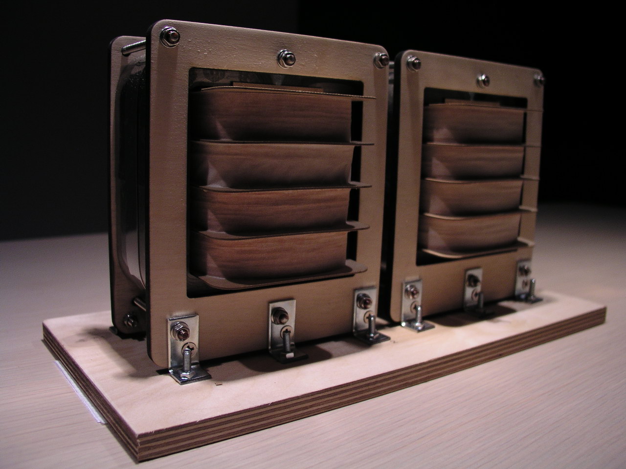

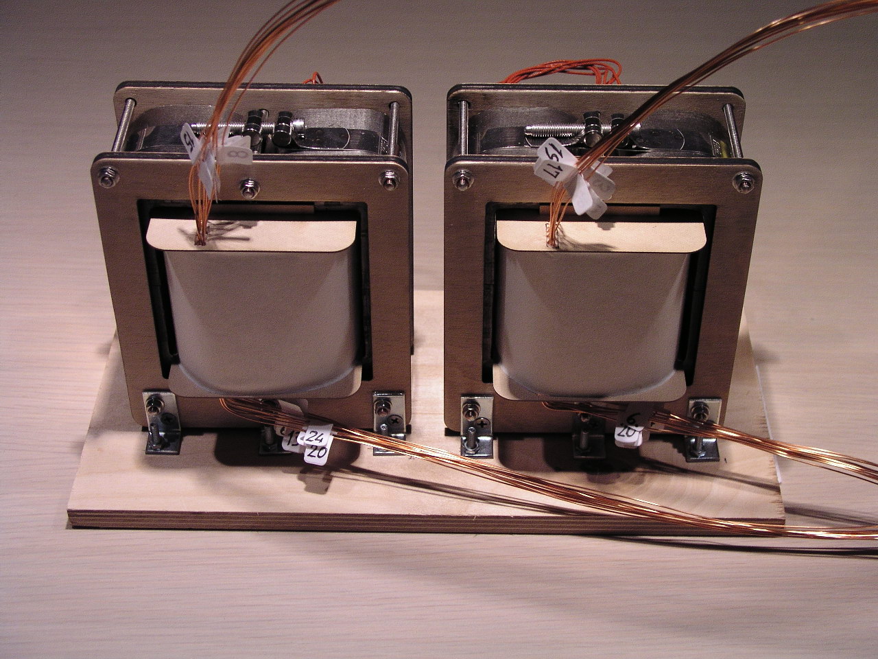

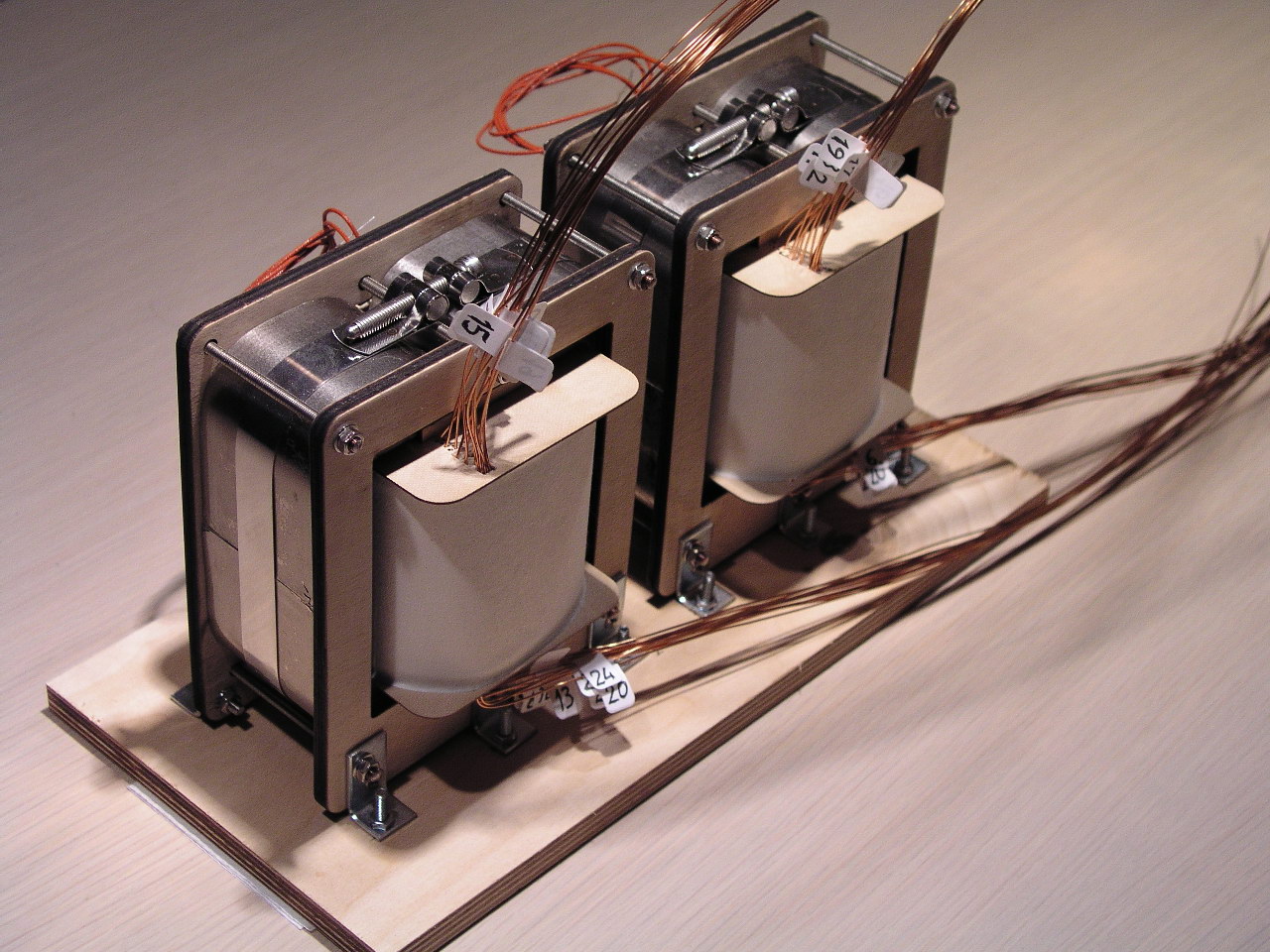

After a rather long time of inactivity, I am going to present you my latest project that I have been working on. After the exotic power amplifier with 211 output tube and the exotic phono preamplifier, I am going to show you the most exotic output transformers.
They are rated at 5kOhms of nominal load, proposed for tubes like 300B, 2A3, type 45, type 50 tubes, and the Telefunken AD-1 and RE604 tubes. These are cost-no-object creations only for the perfectionist music aficionado that wants to have the very best possible in terms of sound quality. Just for verification, they have been extensively compared to almost any other product available in the international market.
They are manufactured out of the most 'extreme', custom ordered ferromagnetic material that exists today, proposed for most accurate reproduction of musical signals. They are Double C Core shaped and the alloy ribbon is 20-24 microns (0.020-0.024 mm) thick for superior performance in High Frequencies. They are able to possess the minimum distortion to sound.
The coil formers are hand built, made of carton pieces, precision cut at a laser jet machine with tolerance of 0.05mm. The same holds true for the mounting brackets, made of baltic birch plywood. The mounting/securing strap is absolytely non magnetic and the bolts and nuts are all stainless steel 316 grade for lack of ferromagnetic properties.
The primary coil is wound at an unusually high number of turns, providing superior performance in low frequencies that no other transformer in the market is able to provide! For the technically inclined, the c cores have been tuned to a very high initial permeability level when DC biased, for maximum fidelity (low level detail, stellar clarity and unparalleled impact, authority and dynamics). The structure of the secondary coil is very complicated in order to have trully superior performance in high frequencies. 24 wires are coming out of the secondary coil and all must be used for proper performance. There exist no secondary coil output taps here, every time the user replaces the loudspeaker, he must make adjustments in order to achieve proper/ideal connection.
Due to the fact that the securing band can be taken off, the user has access to the gapping spacers, so he can find tune the performance of these transformers according to his taste (more power at low frequencies vs. more clarity, finesse and dynamics). This feature is offered for the first time to the end user!
Specifications:
Nominal load: 5kOhms
Primary inductance: 45 Henries without DC biasing, at 1V rms
Frequency response (with 2A3 tube): -1dB @ below 10Hz to 56 kHz, -3dB @ below 10Hz up to 85 kHz.
Secondary coil arrangement capability: 4 - 6 - 8 - 16 ohms

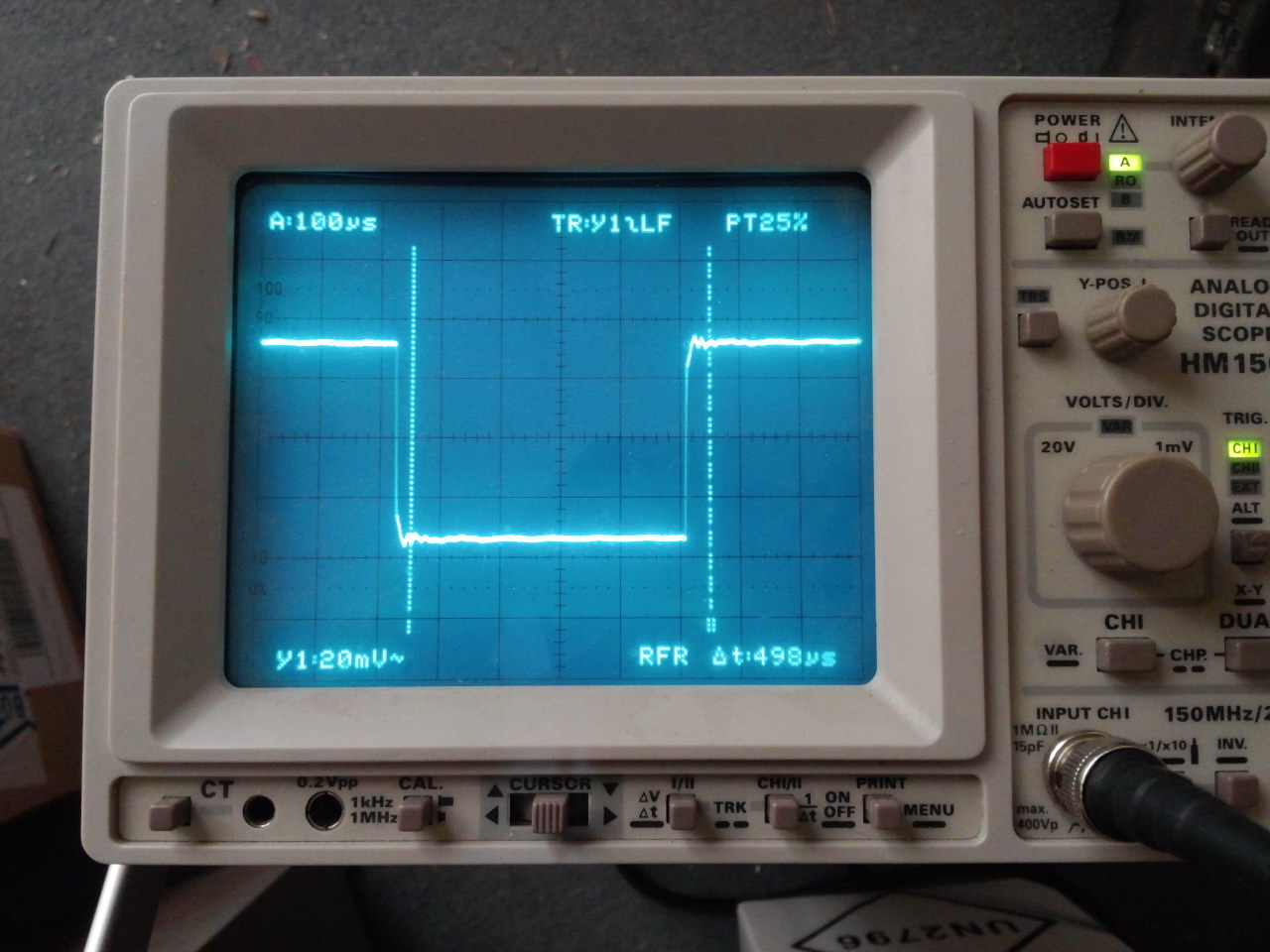

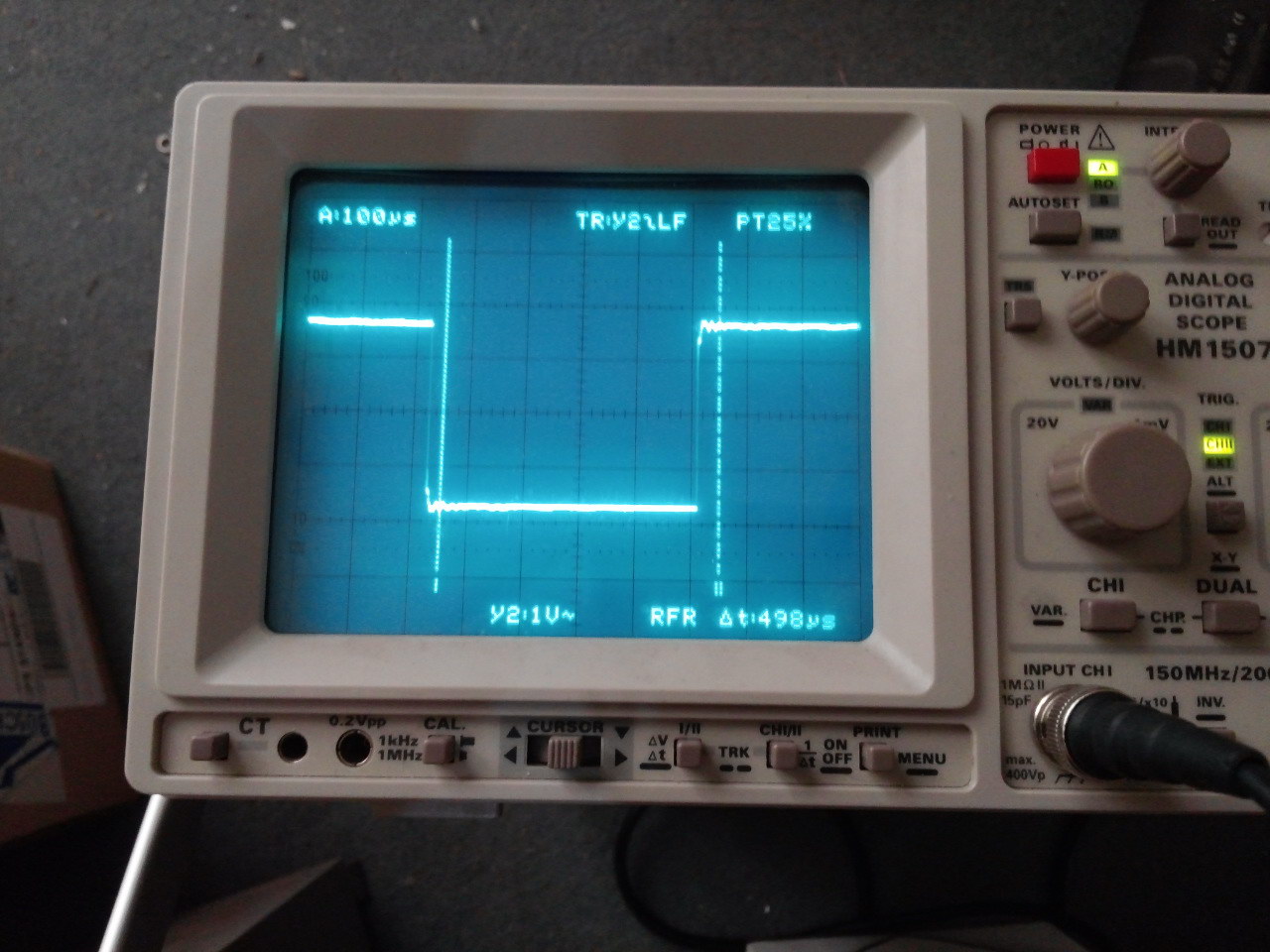

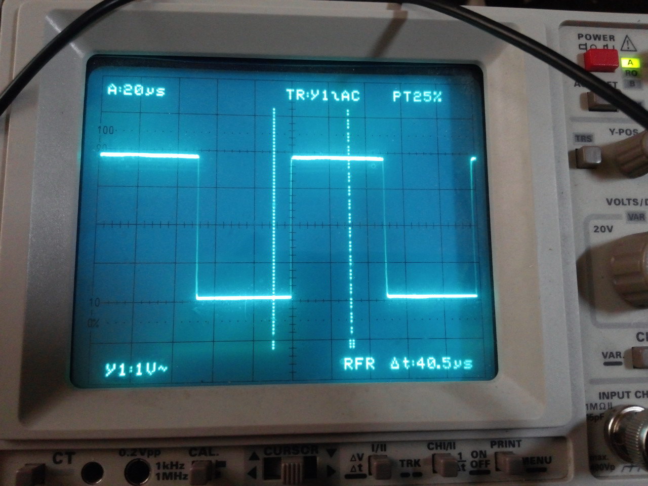

The pictures with the square wave response were taken with cables of high capacitance, so there is a small resonance already in the signal coming out of the generator.

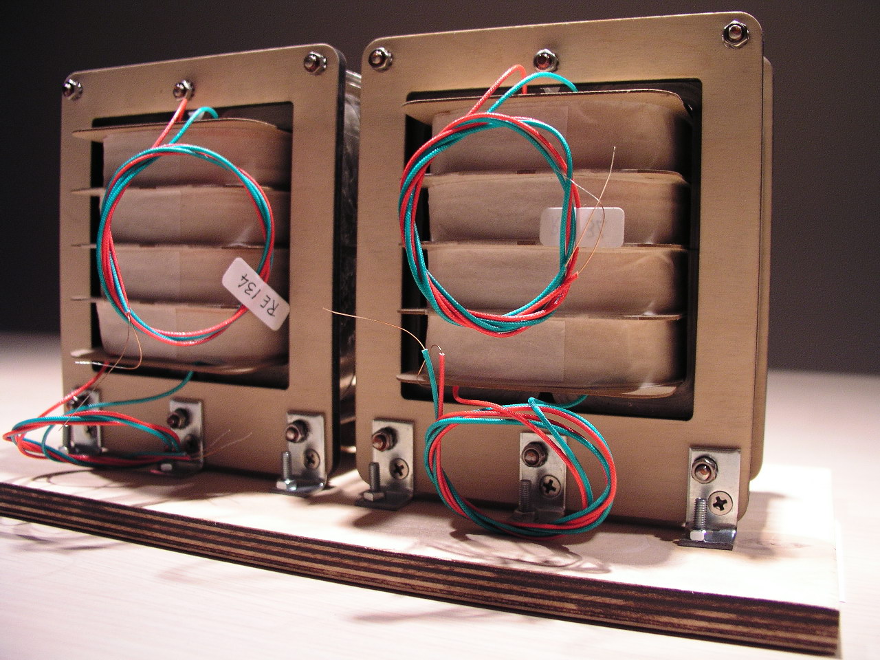

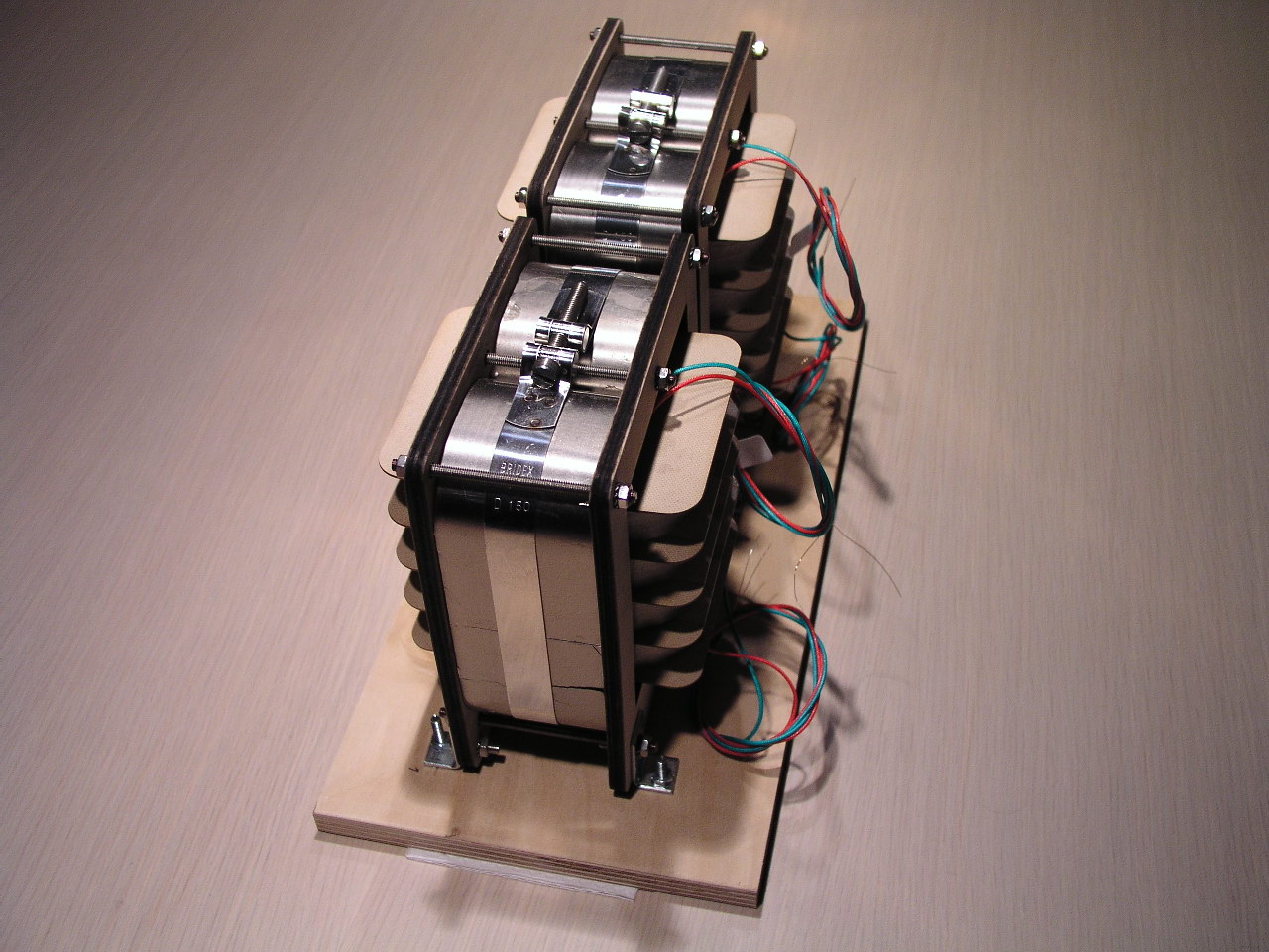

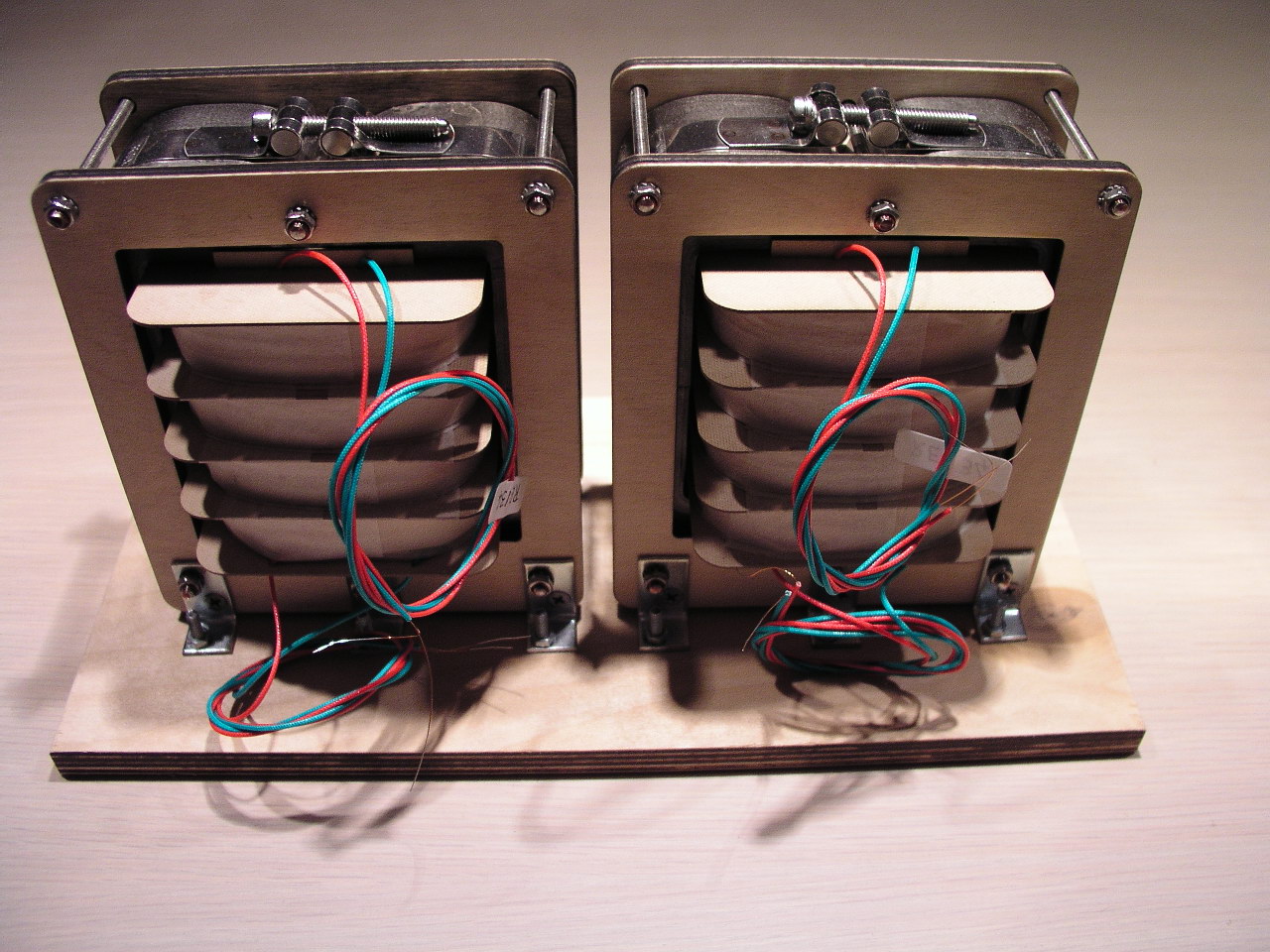

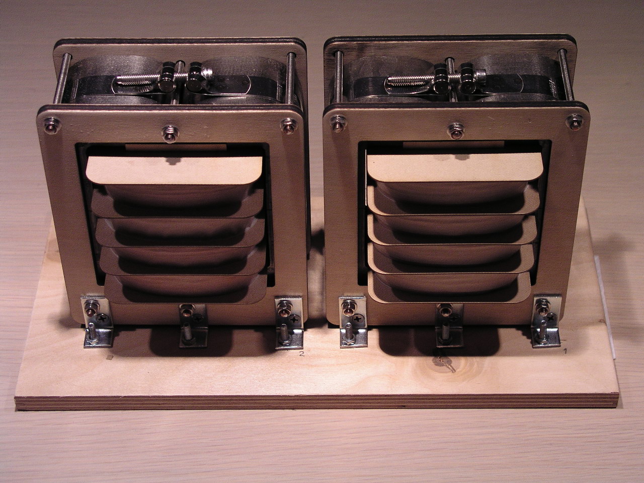

Now I am going to present you the most exotic interstage transformers for Single Ended vacuum tube amplifiers. They are proposed for the creme de la creme of Directly Heated Triodes (DHT) that usually have internal impedances between 5 and 10 kOhms. But more conventional tubes can equally be used here.
The four-chamber coil formers are hand built, made of carton pieces, precision cut at a laser jet machine with tolerance of 0.05mm. The same holds true for the mounting brackets, made of baltic birch plywood. The mounting/securing strap is absolytely non magnetic and the bolts and nuts are all stainless steel 316 grade for lack of ferromagnetic properties.
These interstage transformers are proposed for the best Directly Heated Triode tubes that have ever been made. All interstage transformers suffer from poor high frequency extention, but here this is not the case at all! They can be loaded at unusually high loads, well exceeding 47 kOhms, ideal loading conditions are 47 - 68 kOhms, according to application. This way the user can drive his favorite tubes that provide spectacular sound at ideal loading conditions. The very best DHTs have internal impedance around 5-10 kOhms and these transformers are their ideal match at 1:1 turns ratio (bifilar wound). Due to their design, primary voltage must not exceed 350 Volts DC.
Due to the fact that the securing band can be taken off, the user has access to the gapping spacers, so he can find tune the performance of these transformers according to his taste. This feature is offered for the first time to the end user!
Specifications:
Nominal load: 47-68 kOhms (the transformers pictured here are tuned at 56kOhms, for Telefunken RE134 tube with an Rp of ~5 kOhms)
Primary and Secondary DC resistance: 740 ohms
Primary inductance: 440-530 Henries depending on which tube will be used, without DC biasing, at 1V rms, .
Frequency response (with Telefunken RE084 tube with Rp ~10 kOhms) loaded @ 68kOhms: -3dB @ below 10 Hz to 195 kHz.
Frequency response (with Telefunken AD-1 tube with Rp ~600 Ohms) loaded @ 68 kOhms: -3dB @ below 10 Hz to ~2 MHz.

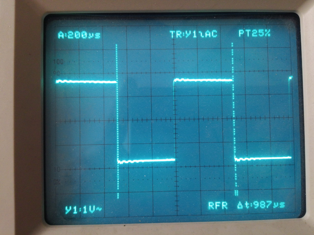

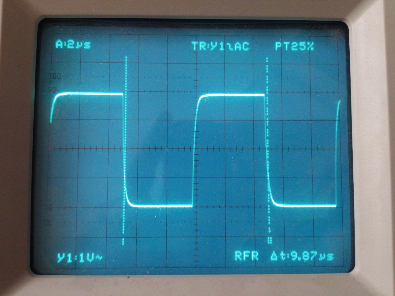

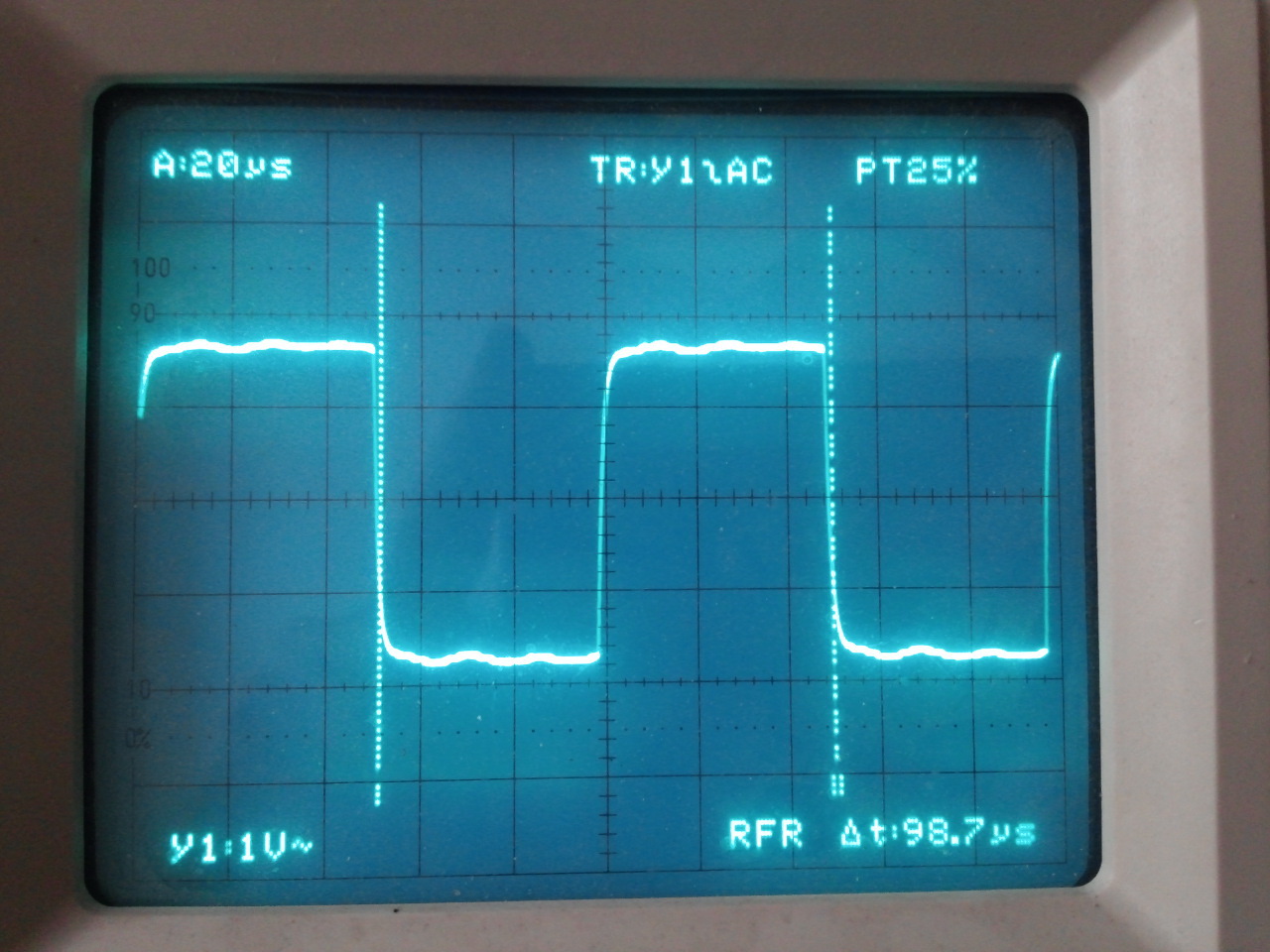

1st graph picture: 1 kHz square wave response, input impedance: 10 kOhms, loading impedance: 68 kOhms
2nd graph picture: 10 kHz square wave response, input impedance: 10 kOhms, loading impedance: 68 kOhms
3rd graph picture: 10 kHz square wave response, input impedance: 600 Ohms, loading impedance: 68 kOhms
4th graph picture: 100 kHz square wave response, input impedance: 600 Ohms, loading impedance: 68 kOhms
Show the square wave pictures at 10 and 20 Khz and at 50 and 100 Hz. 1 Khz is meaningless.
