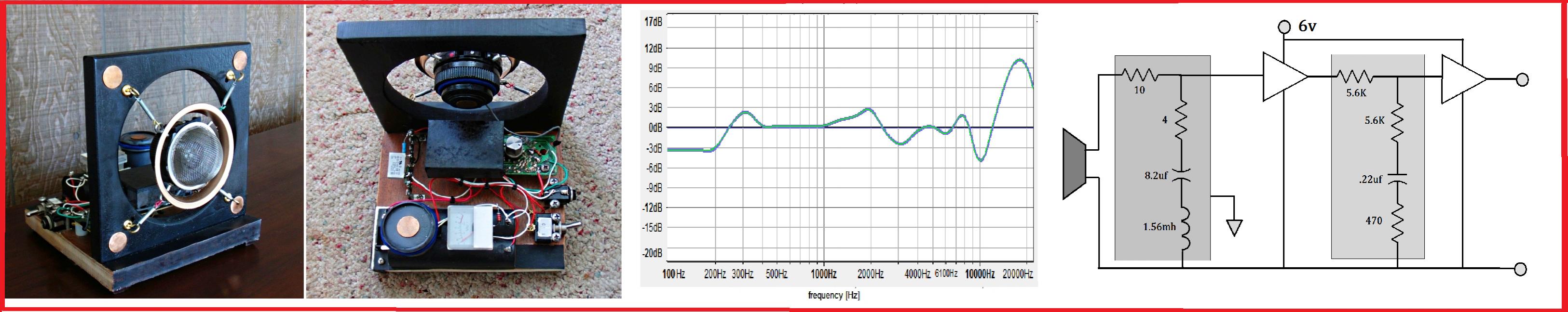

Of all the mics I have made this is by far the most elaborate, headphone element is used.RC circuit provides the needed bass boost and the LC circuit reduced the very large 1.4K peak, when speaker elements are used as mics this is very common.I like the sound so much that I have actually used in in some of my recordings.
