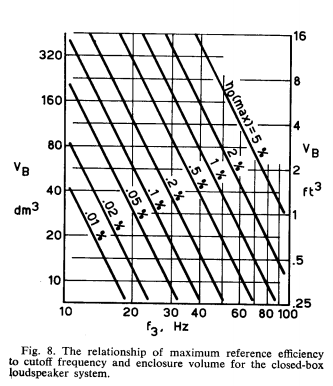

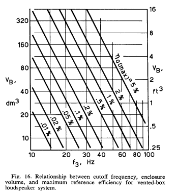

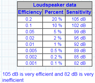

as the late DJK often stated, a 6th order bass reflex (ideal qts=0.312) offers some of the best tradeoff of boxsize vs LF capability. Without the boost, its a SBB4 having the best transient response of the vented box family.
The drawback is having sufficient power at that narrow band of tuning. Done properly with highpassing (20Hz 2nd order in example below - it would be better yet with highpass corner around 25Hz) its win win as junk below tuning doesn't waste power.

hi GM, somehow I missed those charts - here's an enlargement of the vented box chart

Uff, those efficiency tables give me goosebumps. While there is some merit to that, It doesn't seem to always hold true? At least Hornresp sims very different outcomes regarding efficiency, and my calculation by hand from WinISD data (doesn't have efficiency sims) shows similar outcome.

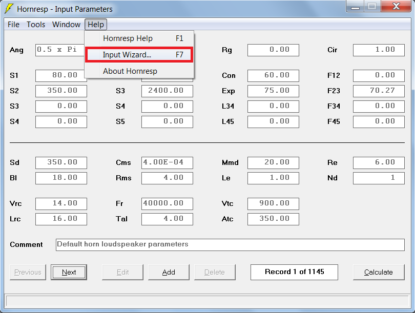

I have used WINISD and found it very easy to understand. Tried Hornresp and not as much luck. Is there a good tutorial on how to use hornresp for a complete beginner? Video would be useful. Thanks
Hornresp is it's own guide. It comes with a help file and hovering the pointer over any input box will tell you what the box is for or what you need to enter. Double clicking many input boxes brings up a wizard to help you fill in the box. It does get a lot more complicated but a simple sim starts as simple as that. I figured it out on my own, just used a sim online, copied the inputs, made sure I got the same results and learned as I went.
