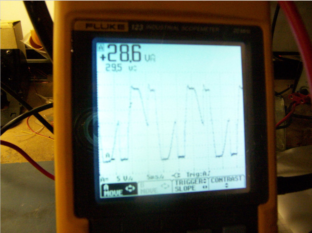

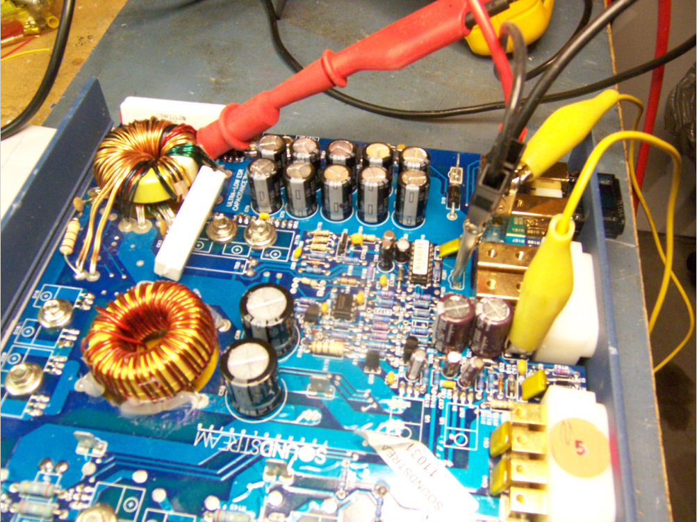

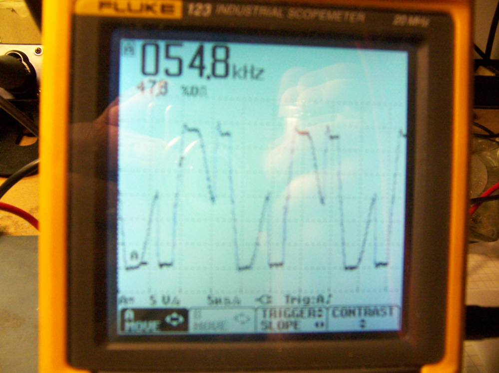

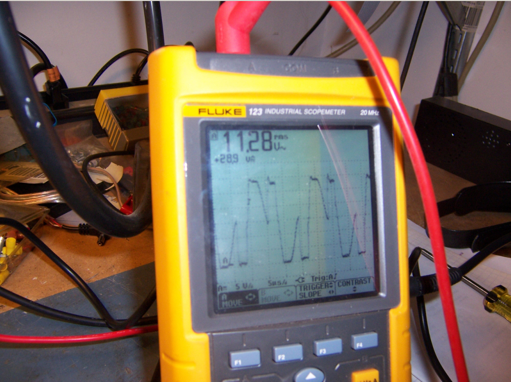

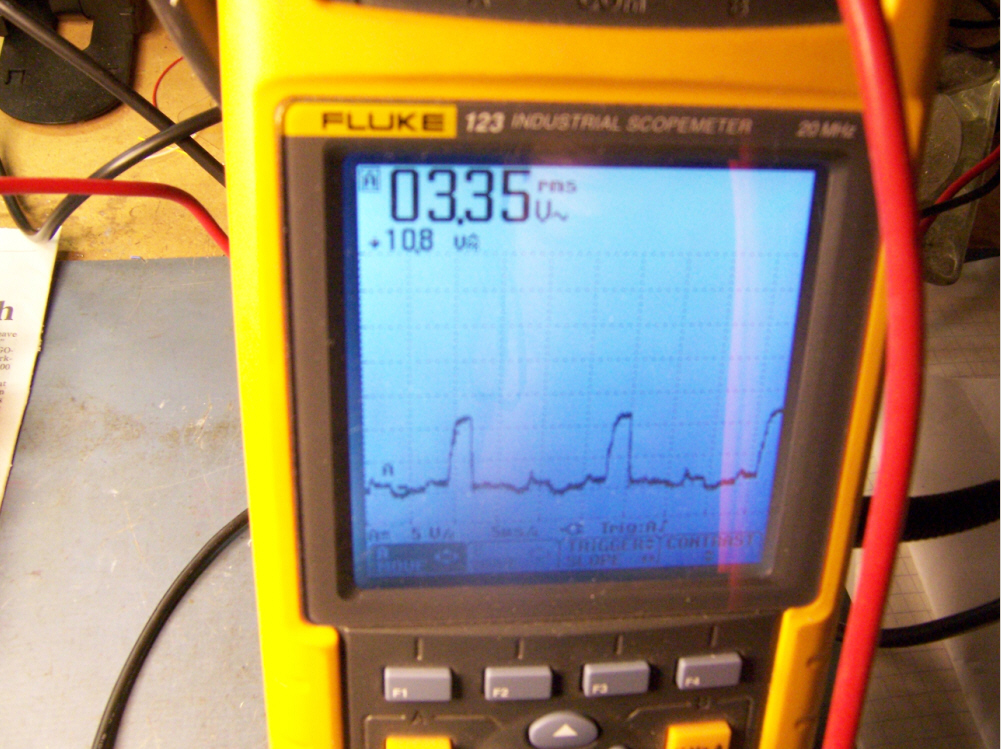

A regulated power supply is designed to maintain a target voltage and will do so as long as the input voltage range is within the design parameters (11.5-14.5 is common). To prevent the voltage from varying from the target voltage, the pulse width is varied. When you vary the 12v DC supply voltage, the pulse width will vary (changing the appearance of both the gate and drain waveforms) to maintain the target voltage (whatever that is for the amp being tested).

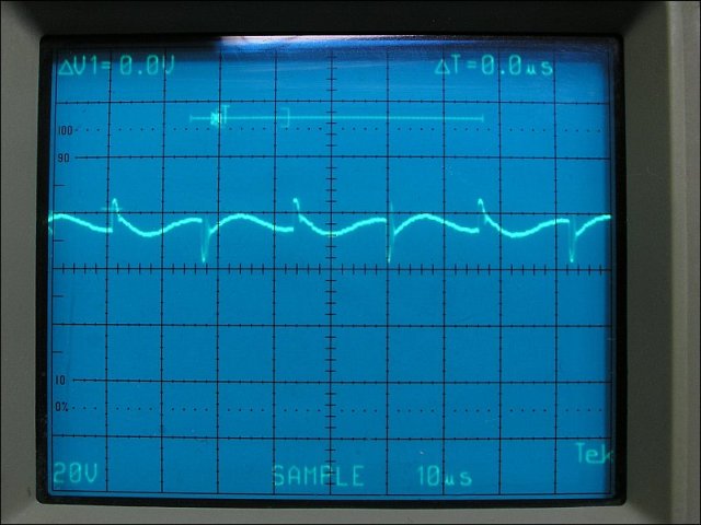

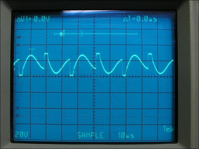

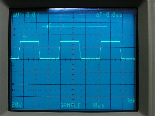

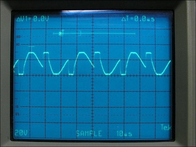

90scaraudio, The waveform in the photo third from the left on top looks like the drain waveform. it shows a spike on the leading edge a notch then another spike on the leading edge. the leading edge is the on the left of the positive going edge. I f you are going to usde 100volt mosfets I wouldn't worry aboput it though. even 60 volt mosfets should be ok.

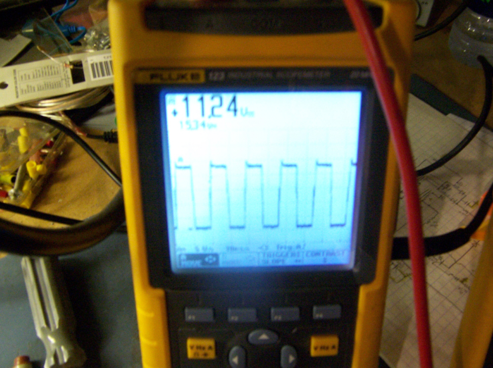

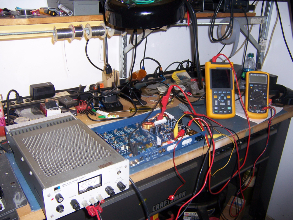

Did you try reducing the DC voltage from your power supply to see if the pulse width changed?
Just checked it out.....Yes as I lower the power-supply voltage down to 11, the pulse gets better.

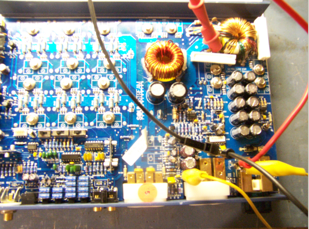

With the NDP7060's in it, I tested it powering a Pioneer TS-W2501D4 10in. It sounds fantastic but this sub can handle more than this 700s can dish out. I'll see how hot it gets on my drive to work in the AM. 😎
Thanks Perry and Wade for the knowledge.
