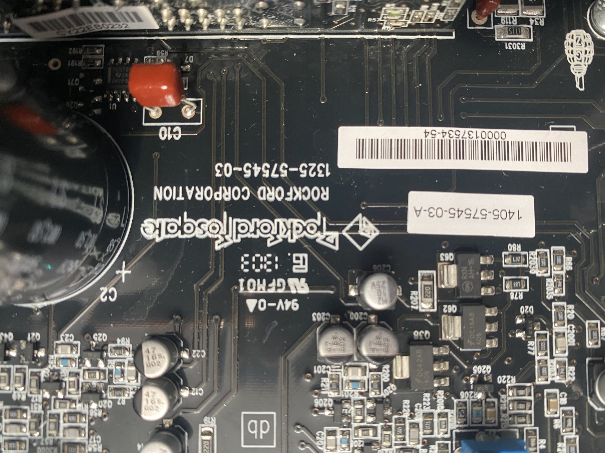

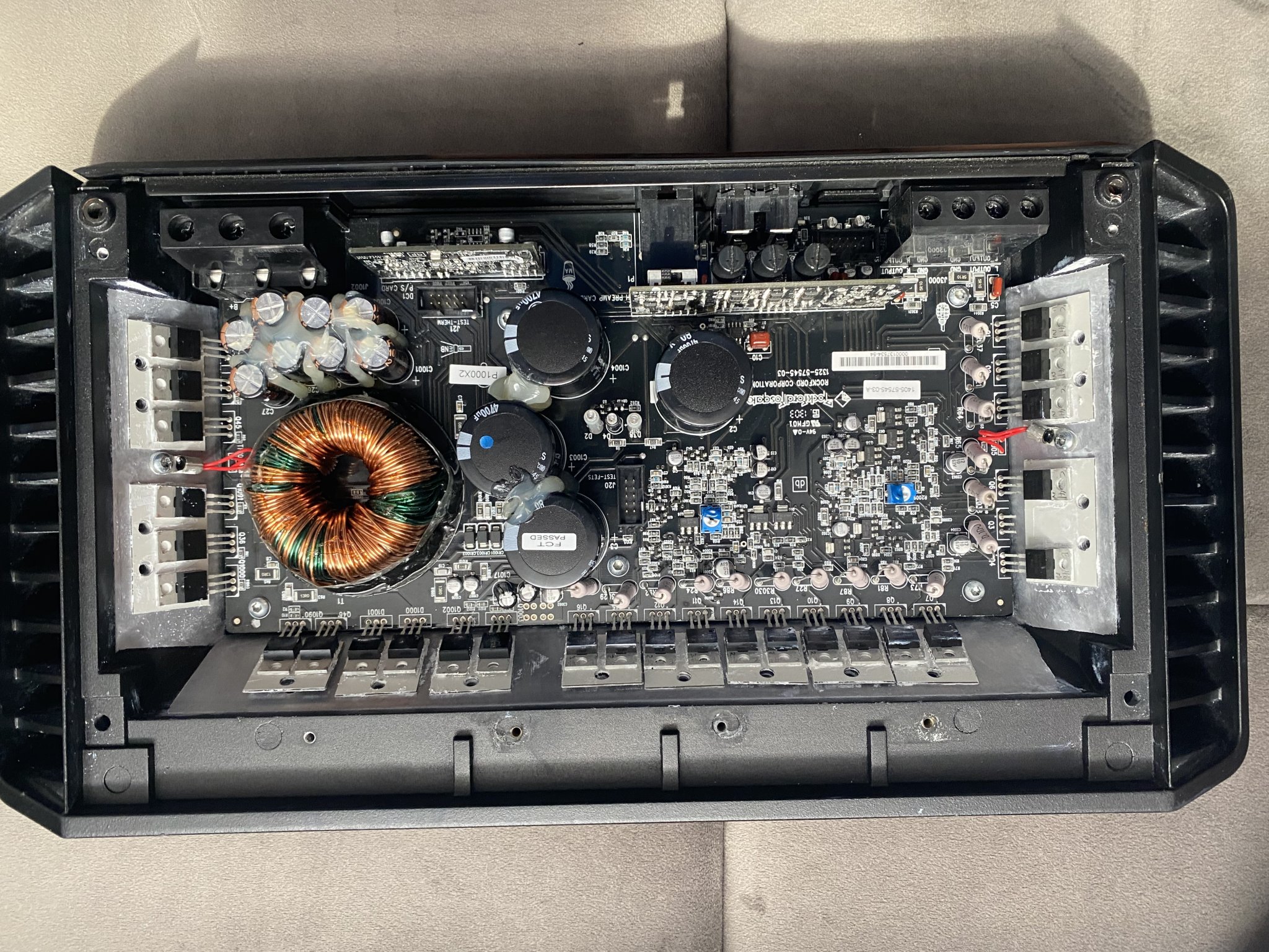

I have a Rockford 1000x2 that has a blown output mosfet. The part # is Irf6218, this part is discontinued there are some on eBay and Amazon but I’m concerned with getting fakes. Does anyone know of a suitable replacement or a reputable source for the 6218?
Is this your amp or is it for a customer?
What's the PC# on the board?
Rochester shows stock. I never used them as a supplier but I've seen Digikey sell parts through them. That doesn't include this part but I'd trust Rochester over eBay or Amazon.
I attached a photo of the board#. It’s my amp.

Thanks for the replies.
Perry, the rail voltage is 57 volts.
Moer, I looked at those the irf6218 is a p-channel those are n-channels does that make a difference?
