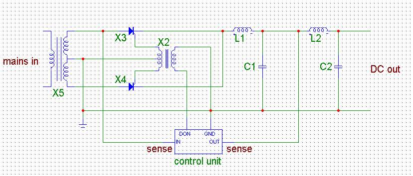

The design that poobah has proposed operates at line frequency (100Hz or 120Hz), not at high frequencies.
L1 may as well be the leakage inductance of the mains transformer, maybe with some additional inductance in series.
The control scheme won't work because S1 can't be opened until L1 current has decreased to zero due to transformer leakage inductance (that may be even bigger than L1 and there is no way to clamp it), so S2 is not required.
So S1 and S2 may be replaced by a single thyristor in place of S1, that would open automatically when inductor current reaches zero. Then the output voltage would be controlled through the firing angle of that thyristor and we would have something very similar to the PSU found in Carver's amplifiers. An alternative control scheme may be based in skipping mains cycles, this is quite common in microcontroller-driven electric heaters.

Could a thyrister be put in the center tap leg. and then just use diodes (or a tube if you must) on the "ends" of the primary. Then use simple control of the conduction angle?
Then you would need a thyristor in the center leg and one diode in each other leg, thus making the current flow through two diode drops. On the other hand, one thyristor in each leg produces just a single diode drop. Remember that a thyristor is almost like a conventional diode, but in order to turn on it doesn't only require to be forward biased but also a trigger gate pulse.
Yes, of course, I am only thinking of a way to simplify the gate/trigger drive for the thyrister. 2 diodes drops is small a for a tube amp. In this way, the gate drive circuitry could be ground referenced perhaps.

In these high voltage circumstances, the most comfortable way to trigger a thyristor is through a small pulse transformer. A single one may be used to trigger both, since the reverse-biased one will ignore the pulses.

Eva's idea is great... my inductor, L1, is already hiding in the secondary of the transformer; and is not required. This elimanates the need for Switch 2 also.

[...]So S1 and S2 may be replaced by a single thyristor in place of S1, that would open automatically when inductor current reaches zero. Then the output voltage would be controlled through the firing angle of that thyristor
Wow, this sounds like a really GREAT idea!!!
This would give you your "pre"-regulation.
I would put the SCR in the center tap, you coould then used sand/snubbers or a tube for rectification on the "ends/legs" of the secondary.
I would use some heater supply to power a small circuit (sand) to: 1. control (regulate) your output voltage through conduction angle, 2. provide a B+ delay to prevent cathode stripping and output pops.
You may still need some small inductance where I have drawn L1... it depends on the leakage inductance of the secondary... with Eva's realization you do not need switch 2.

BTW, let' sum up. Here is a rough sketch of the idea, as I have understood it; is that right?
The next step will be to design the "control unit" circuit.
I would use the SCR in the center tap and 2 diodes in the normal way for each leg of the secondary. Then use a little bit of rectifed heater power for control circuit.
In order to trigger a thyristor, a small current should be made to flow from gate to cathode, so you should connect the secondaries of the pulse transformer between these legs. There is no point in inserting the secondary windings of the main transformer in the trigger loop.
As a control circuit you may consider the good old TL494 synchronized to the 50/60Hz waveform and with its internal clock programmed for 40Hz or so operation. The TL494 will be fine since it employs trailing-edge blanking (the pulses grow backwards from the end of the cycle as duty cycle is increased, instead of growing from the beggining as usual). Voltage mode control with enough frequency compensation will do the trick, and there is still a free op-amp in the IC that allows to implement some degree of output current limiting.
I forgot to mention that you are going to need some kind of high frequency pulse generator with on/off in order to feed the trigger transformer. A LM393 comparator may do the job (Nat.Semi. datasheet contains some hints about that).

Either method would work... the method with 2 SCRS would be more efficient. The center tap method avoids the pulse tranformer and requires some careful thought about grounding.
