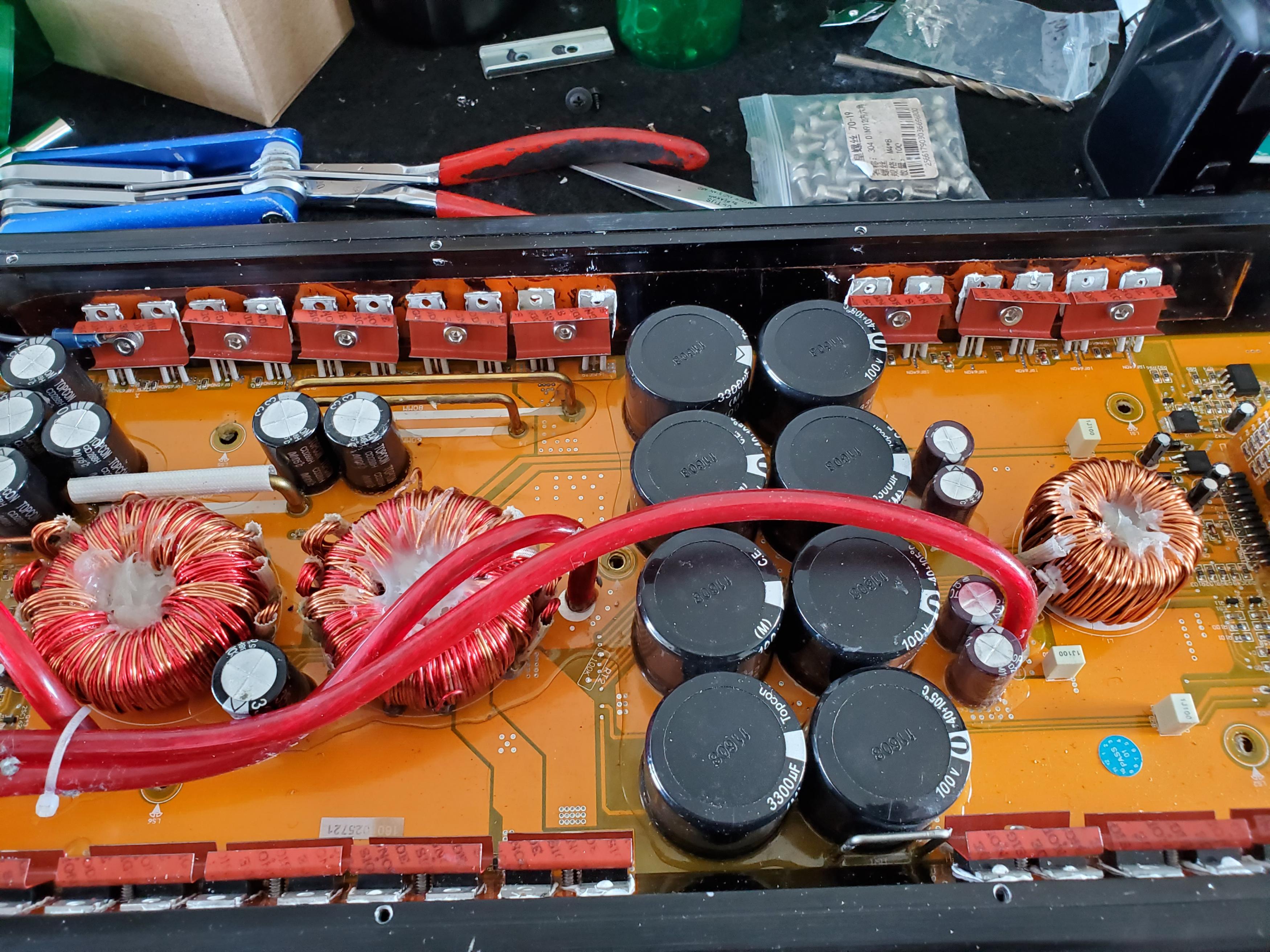

REPLACEMENT FOR THE SCREW TYPE
I used a stainless band clamp of steel 1-1/8th lond by .5" tall. 2mm in thickness. It doesn't bend under the force of the new stainless m4x8mm hex cap screw.

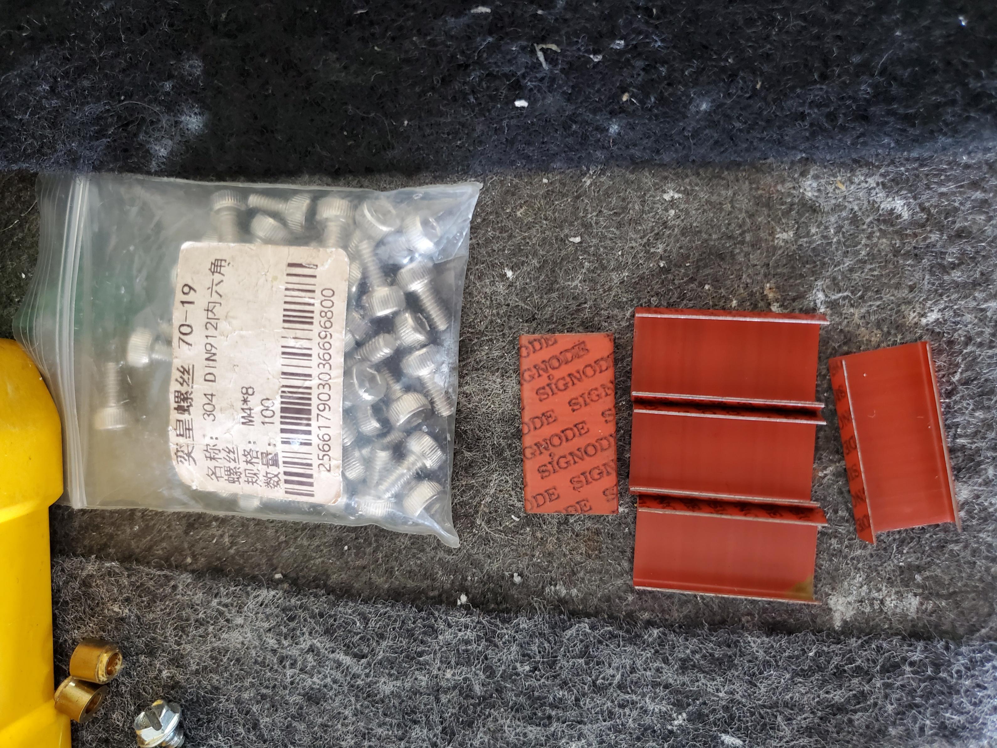

The parts needed.
A m4x8mm hex cap DIN912 (Alibabia) there are plenty of places to buy them.
US $3.28 25%OFF | DIN912 M3 M4 M5 M6 M8 Metric Thread 304 Stainless Steel Hexagon Socket Head Cap Screws Inner Hex Socket Bicycle Bolt 4mm-50mm
DIN912 M3 M4 M5 M6 M8 Metric Thread 304 Stainless Steel Hexagon Socket Head Cap Screws Inner Hex Socket Bicycle Bolt 4mm 50mm|din912 m3|socket head cap screwcap screw - AliExpress
The band clamps are used on 1" stainless steel bands. EBAY
Signode USA 1/2” x 1-1/8” Metal Banding Clips Seals NEW USA ( 100 Pcs. ) | eBay
