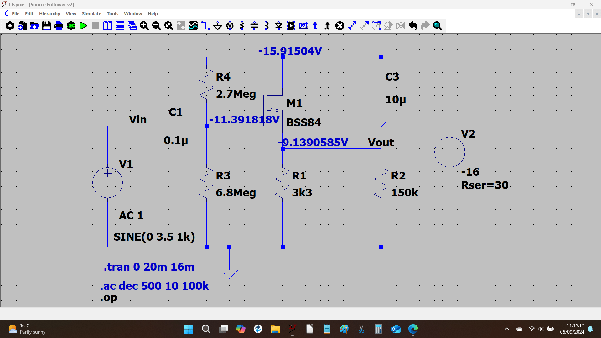

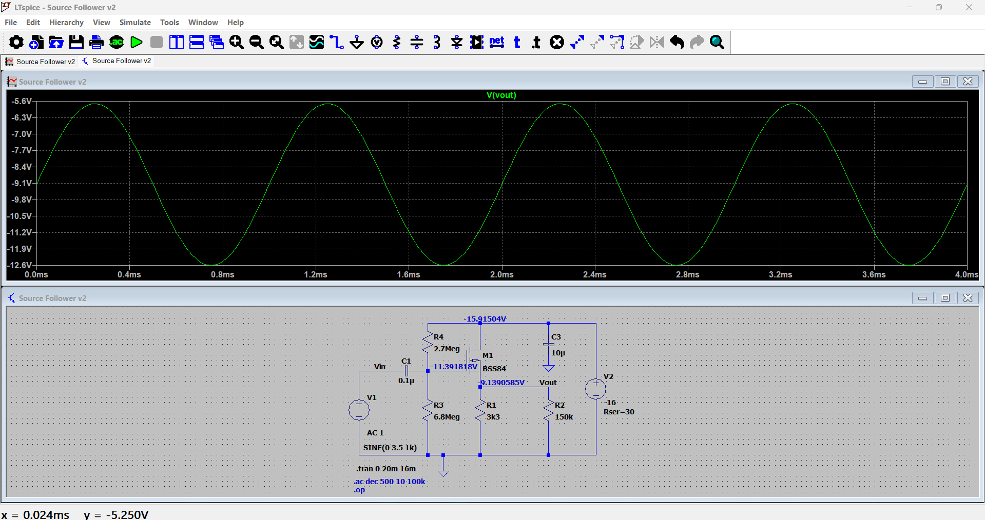

So something like this. Tweak the gate bias to get maximum symmetrical output swing.:

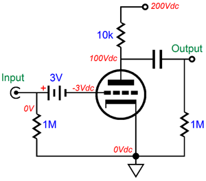

I think the problem is that I'm using a 9V battery to bias the grid of my 01A tube like this
Battery Grid Bias Line-Stage Amplifier with No Input Coupling Capacitor (1) (1).png
and as soon as I turn down the volume pots on my bass, the treble goes right down.
Maybe I should use filament bias on the 01A tube and see if that's any better, before I resort to a SF in my bass guitar
If the pot acts on the grid then yes, it will do, if it acts on the other side of the battery then it should not.
The grid draws essentially no DC current and so shunting the the 1meg even down to ground potential via a pot has zero effect on biasing. If the pot acts on the other side of the battery it reduces the grid bias by an amount determined by the pot setting.
For example if the pot was set to 100k then the grid bias would fall from -3 to something nearer - 0.3volts

As drawn that should work. Any reduction in the 1meg value caused by a pot should not alter the grid bias but if the signal (pot) feeds in at the other side (the grid) then it will.
