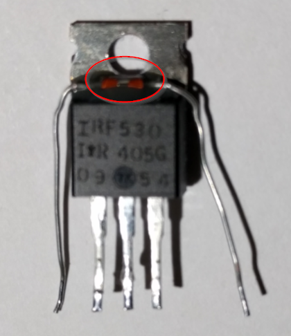

There are two MOSFETS
IRF 9530 (tests ok)
IRF 530 (tests short)
The IRF 530 has a glued part to it, looking like a Zener diode, but it's not as there is no cathode line on it.
Considering that it is glued on it, I'm suspecting some kind of a thermal cut-off, but have no way of confirming it or knowing what part / specs
Any clue as what it is, and what it can be replaced with?
Also the IRF 530 comes in both P and N forms, this one has neither N or P marked on it, how do I know which is it?
Lastly, the local shop did not have anything equivalent to IRF530
Which is 100V 14A
What can it be replaced with?
The closest the clerk was able to provide was IRF740, which is 400V 10A
Is it safe to use higher voltage (I suspect yes but am not certain)
What about the current, 10A instead of 14A?

I suggest you not use the IRF740 or 640.
first you need it be "closest match" the manufacturer decide to use IRF530/9530 he now what he's doin'.
if you don't have this 2 mosfets replace it with IRF540 & IRF9540 this is for sure better solution.
the other part that looks like diode it's NTC thermistor for the Thermally compensated bias.
