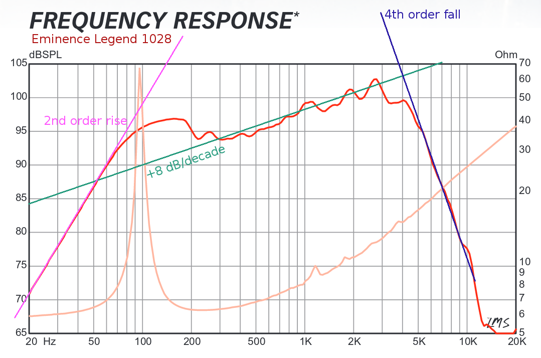

What Shanx said is important, particularly if you plan to overdrive your preamp at all. (Never overdrive the MOSFET power amp itself, as others have said.)
The reason is that guitar speakers have very strange frequency responses (if you come from "normal" audio.) They have a peak somewhere between 2 kHz and 3.5 kHz, and then very steeply roll off the treble above that frequency. This removes the horrid-sounding harsh high frequencies from the distorted guitar.
The attached image shows the manufacturer's published frequency response for an Eminence Legend 1028 (which has less of a peak than some other popular speakers), with some annotations I added. You can see that this applies a *lot* of EQ to the guitar signal - deep bass is filtered out, mid-bass is bumped up a bit, there is progressive treble emphasis from about 300 Hz to 3 kHz, and frequencies above 4 kHz are rolled off very steeply indeed.
If you don't use a guitar speaker, but instead use a P.A. or other nominally flat-response speaker, then you will probably need to put some kind of guitar cab emulation circuit between your preamp and your power amp. This is basically a complicated filter that more or less reproduces the frequency response curve of a guitar speaker.
I'm not familiar with your specific preamp, but some guitar preamps will include a cab emulation filter, and some will let you switch it in (for use with flat-response speakers), or switch it out (for use with a guitar speaker and cab.)
-Gnobuddy
