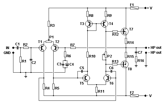

find a schematic that gives what you need.
The design shown is using the VAS to drive the FETs directly. I do not like this arrangement since it forces the adoption of big medium power transistors for Q3 to Q7 inclusive. Then these load up the LTP, also not good.
Get a better schematic.
Have a look at Quasi's designs. There are three or more threads covering all the detail of the design and build with a wealth of buider input and a superb web site put up by Quasi.

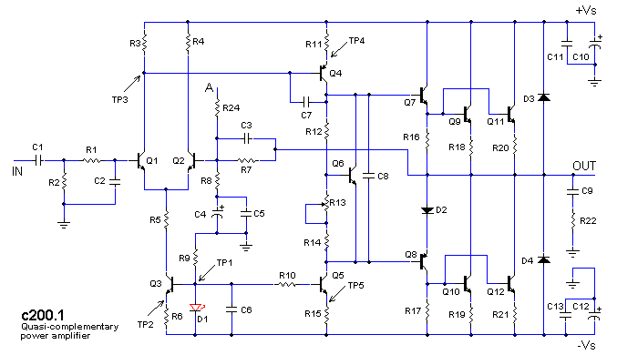

mosfet output
andrewt

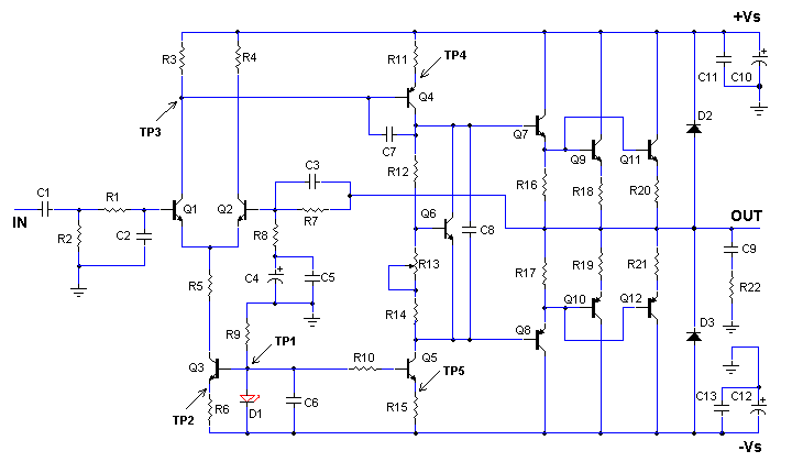

thanks,for long i've been searching for quasi design,any comment on quasi's n-mos amp,i just wan't to use my n-channel fets,from surplus shop
andrewt
What more comments do you want? He recommended the design to you. Have a look on the threads by quasi, they are full of information.
What MOSFETs have you got?

quasi comp
hello,
I have tried this output stage, good to me

Re: quasi comp
Shouldn't that have at least some sort of thermal sompensation?
jmbaudoin said:hello,
http://perso.orange.fr/francis.audio2/C07_FB1a.gif
JMB
richie00boy said:It uses lateral devices, so no need.
Really? Te top is a 'darlington' with a BJT in front so at best it will have zero Tc at well over 200mA, and the bottom is a CFP with BJT in front which has the TC of the BJT transistor. Have you simulated at different temperatures?

Why don't you build that then? The circuit in your first post is not really suited to easy converting to n-channel mosfet by beginners.
- mosfet output conversion
