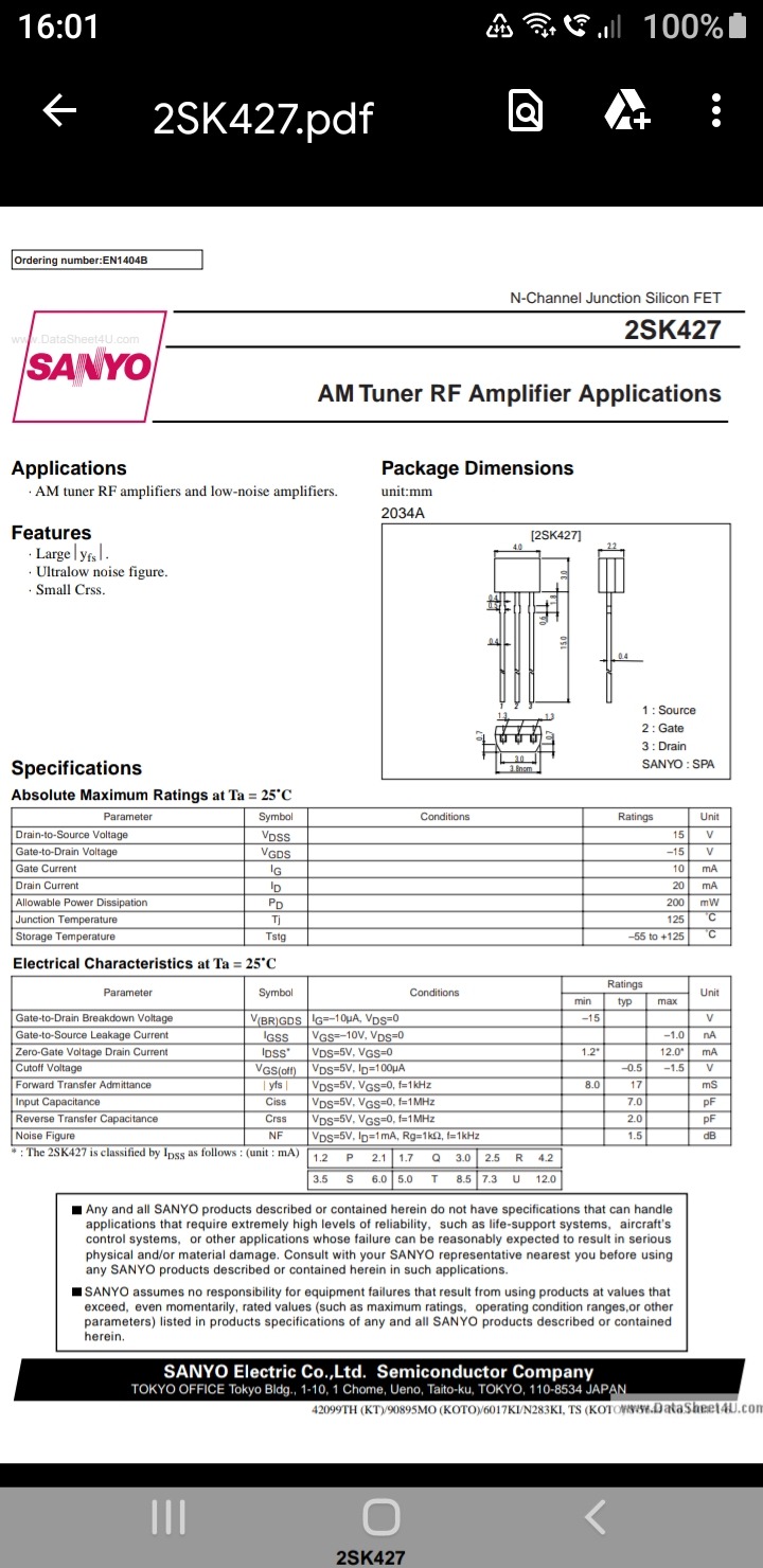

I was searching between my printed data sheets, and you are true. My apologies. The JFET with 17mS is the 2SK427 between many others. My confusion was because it has same package as 2SK241.
@WhiteDragon also took an important point: Current consuption. A single MOSFET or JFET needs 10 to 20mA to reach those mutual conductance. If you want to maintain FET category (Personally I love them toguether with tubes and strongly dislike BJT's), you can try one or more of the low voltage low current drain opamps. I may cite as example TS271 series from STM but there are several of them. If you have experience in SMD, you can go also for smaller micropower opamps. Search with Google or ChatGPT for a list of the thousands available from many manufacturers.
