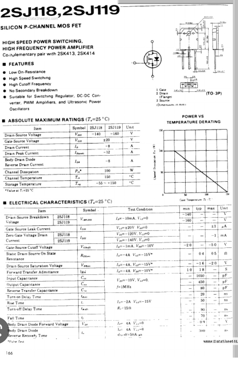

2sj118 sheet was not the best copy. Will try find a better

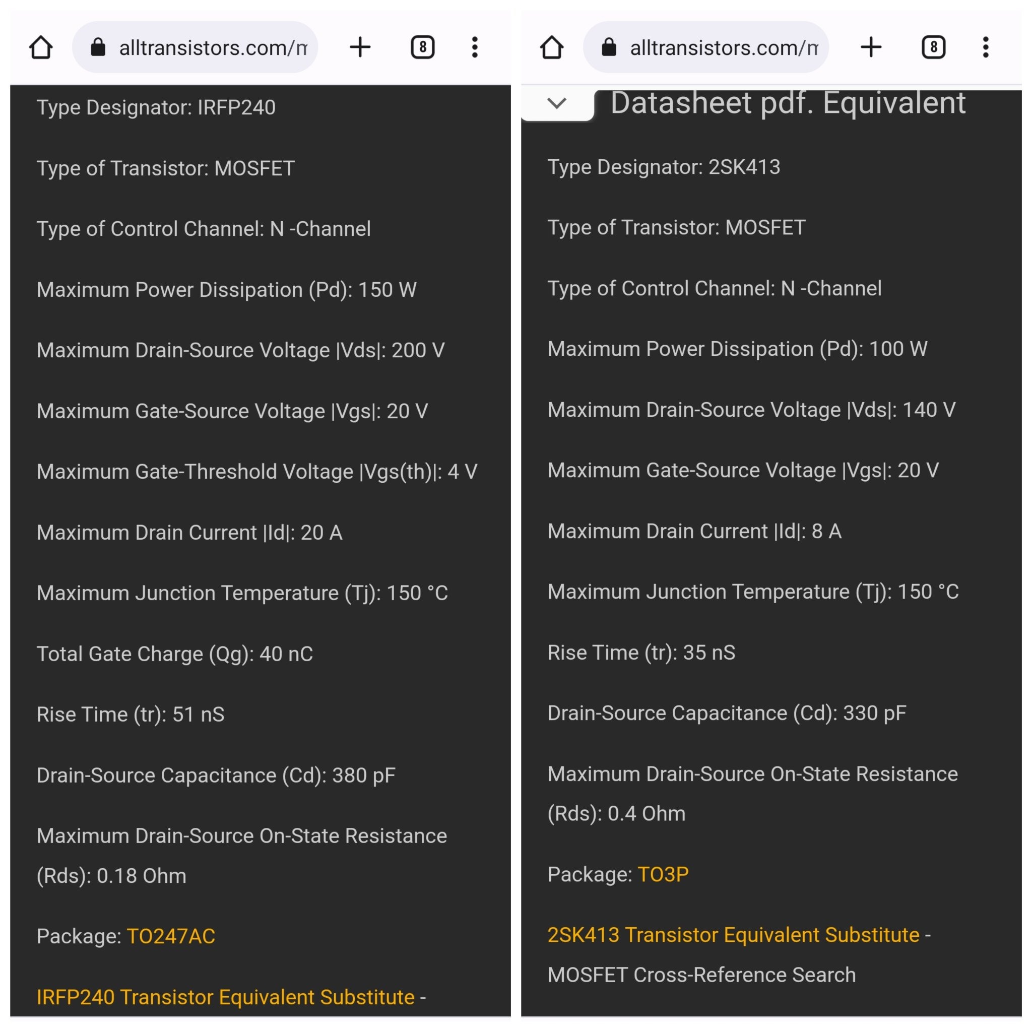

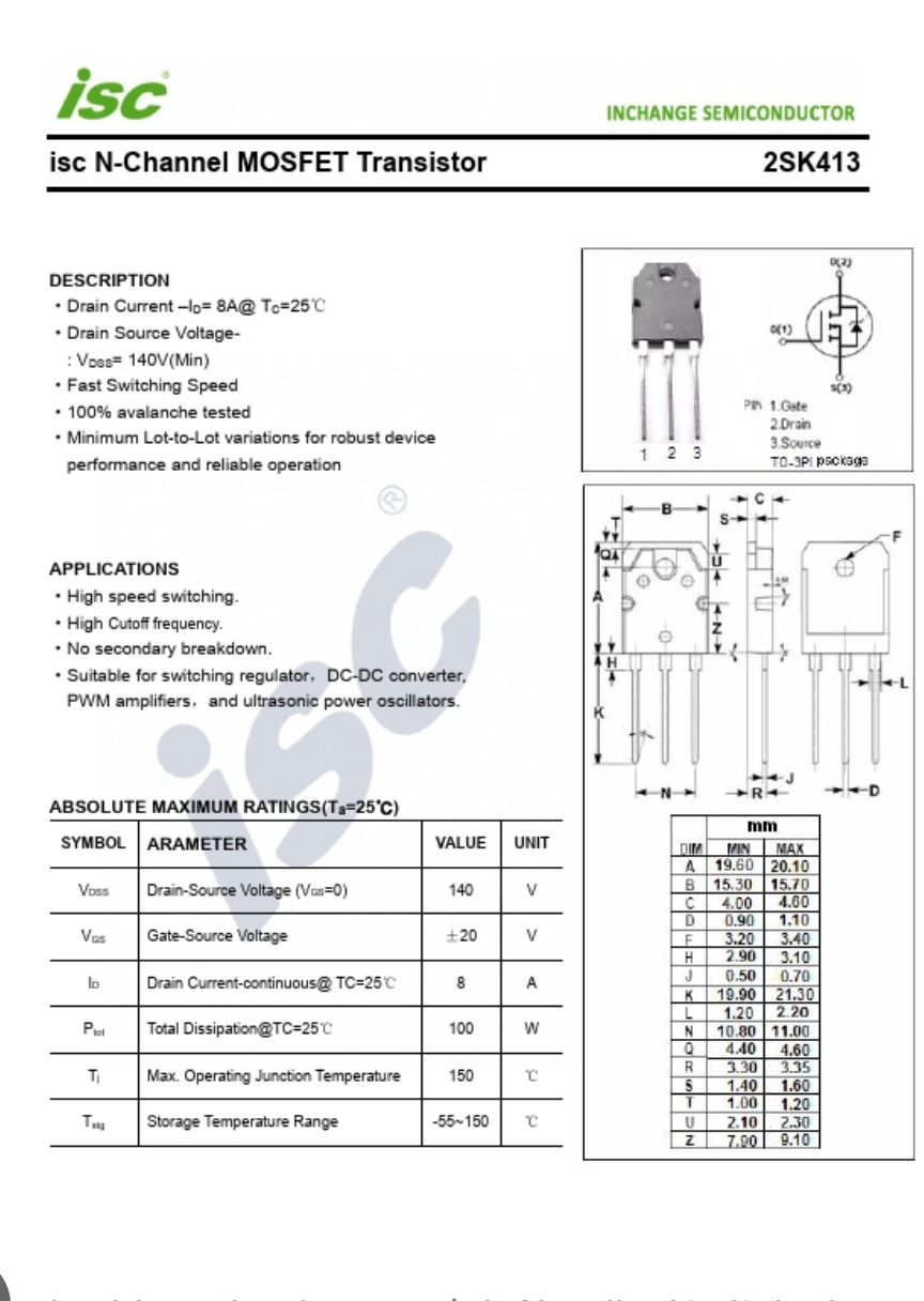

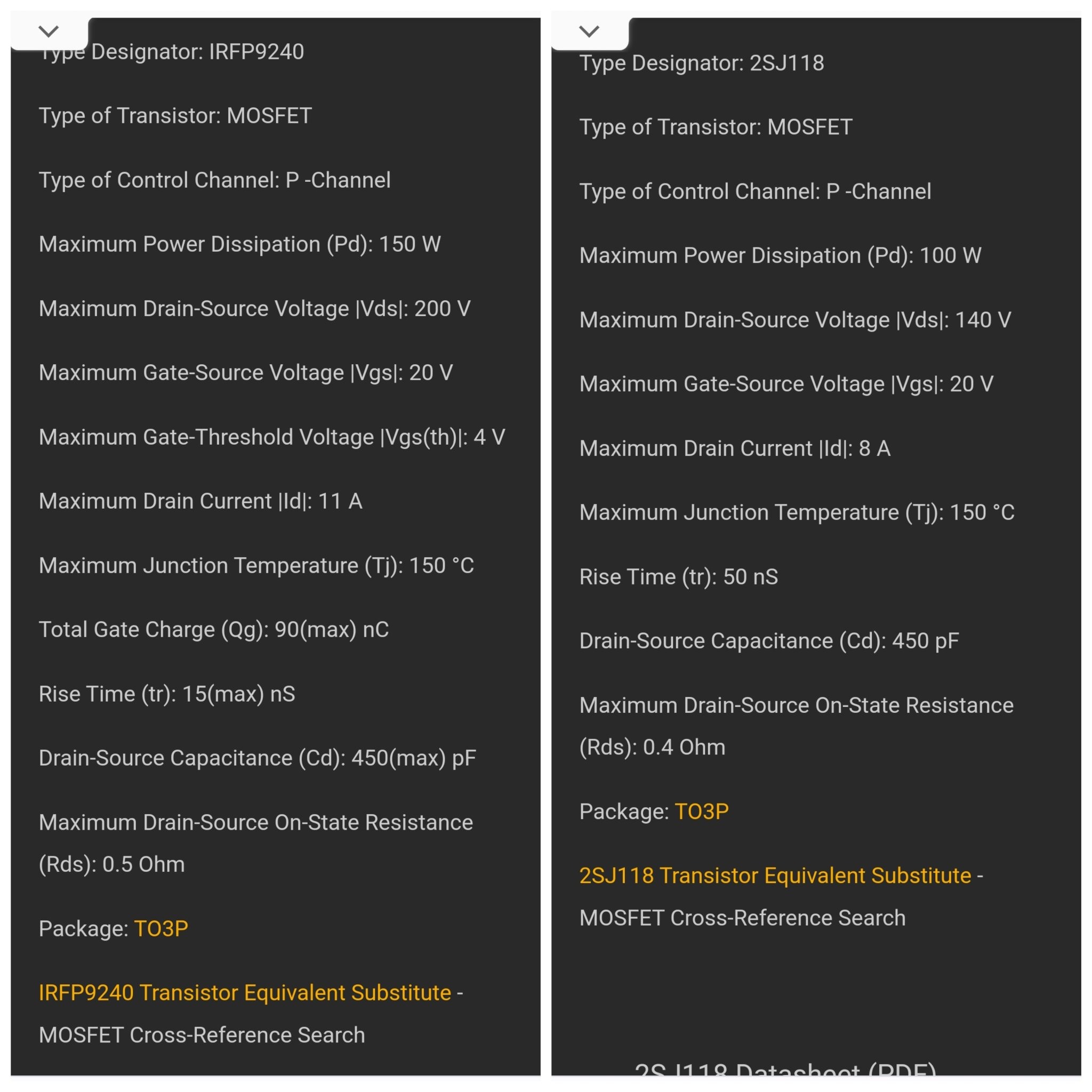

Based on the data sheets
https://www.web-bcs.com/pdf/Hit/2S/2SK413.pdf
https://www.web-bcs.com/pdf/Hit/2S/2SJ118.pdf
the vto is about 3.5V, so these are ~typical MOSFETs and I would try something like IRFP240 and IRFP9240, but some adjustment may be required to the bias.

Thanks steveu.
Those Irfp's does look like a close enough replacement.
