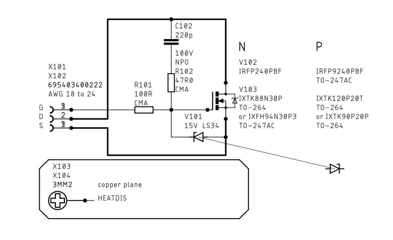

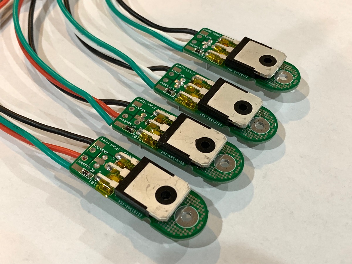

MOSFET mounting
We are using values selected by Hugh Dean from the design for the Alpha Nirvana. I think the design methodology you describe is good for making fine adjustments. 15MHz is trying to kill anything 1 octave above it. So 30MHz and up are where the oscillations would be. Setting it too low may “take the life” out of the music.
