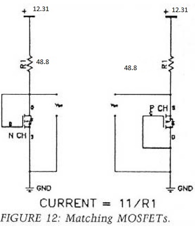

hi,
I have a 12V/5A brick(don't have 15V regulated PSU)
V(output measured with voltmeter) - 12.31 V
Is attached resistance value fine for matching IRFP240PBF?
For resistance four 200 Ohm 3 W in parallel
I won't be using any heat sink, turn on power - taking the first reading on voltmeter - turn off power. I'll be fine, right?

It should be, but ideally you want to measure your devices at the same voltage and current levels that they will see in your completed circuit. Your set up will match them for 12v and bias of 0.25A which is a bit low if you are building a class-A amp with them. You'll be fine measuring these, this voltage and current level won't produce much heat. When you test at higher levels (~20v and ~1A), you'll be good for 20-30 seconds without a sink. Any more time and you'll burn your fingers on the devices.

Thankyou Eric
I understand my reading wont be as precise as taken at operating voltage but at least it should give me rough range to consider a pair as match?
Zen,
I am getting reading ranging between 3.91-4.0 for both N and P channel without heat sink, power on - consider first reading on meter - power off. MOSFET not even warm.
Why you said heat sink is a must, are you also favouring reading at higher voltage(operating) with heat sink?

if you heatsink it , you can try holding it in place little more (20 or so secs) and observe trend of Vgs change vs. temperature

so - for general and not so critical case matching , 20 sec per device is enough , but heatsink is a must , possibly either heated to exact temp or forced fan cooled ..... to ensure same condition for all specimens

If you want precision ,and I guess you would , you should let the device warm and stabilize at least a minute on heatsink , you' ll have nice stabilized reading , reading just after the power on it's a simple mess !!!! .
forget about the time spent, precision is your goal .
why on heatsink ? , because the power p : volt x amps , and because the device will work that way , you want your devices matched like the working conditions

Thankyou Everyone. Will do a heat sink reading again later since I don't have any regulated PSU.
One final question, I am matching for f5 T
What input voltage = 34V ?
Current = ? (mA)

Member euvl published a article regarding cooling f5t on linear "site" , take a look if you haven't.

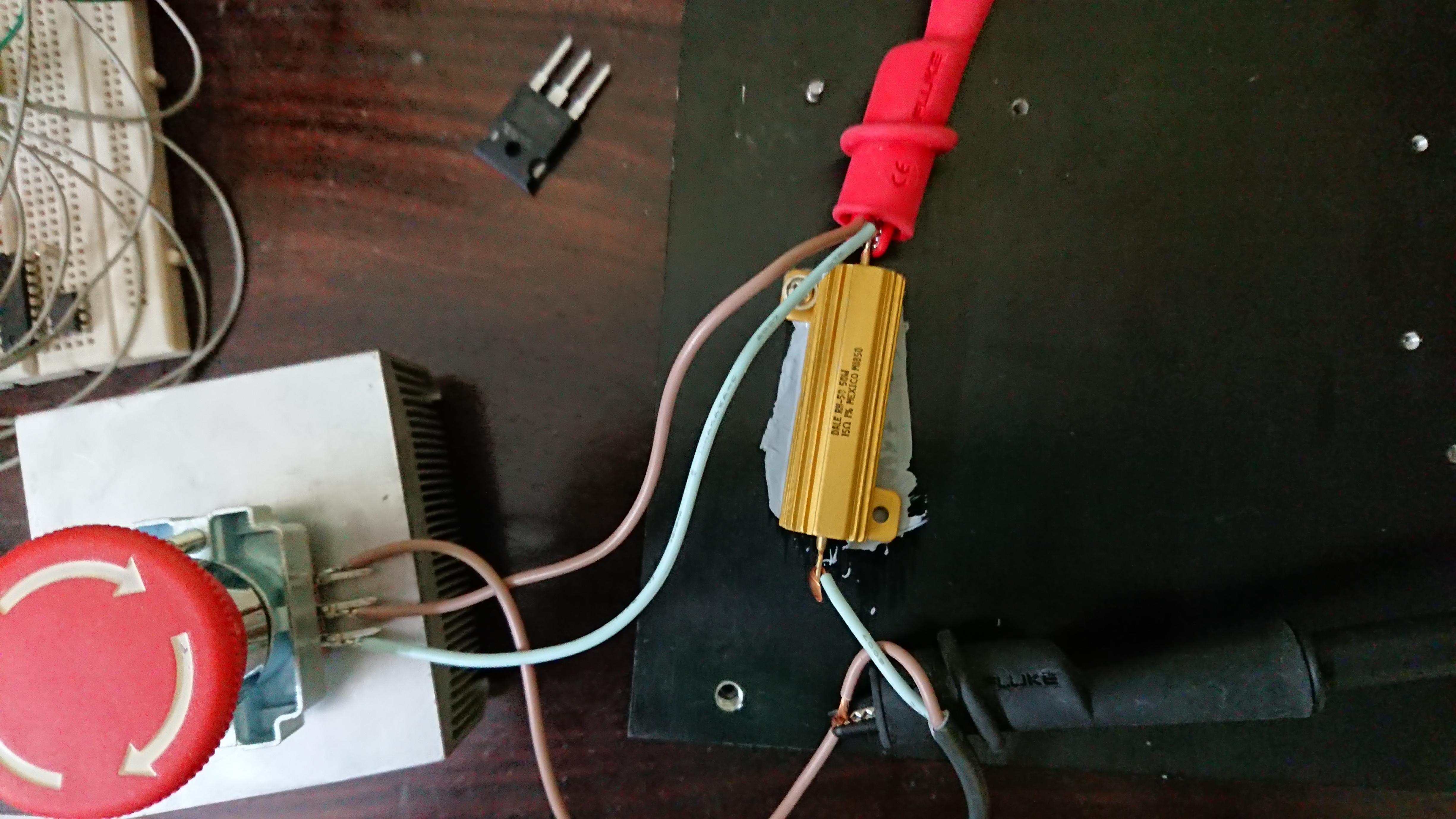

hi,
I am now matching MOSFET using heatsinks,
Resistor - 15.1R 50Watt
V - 19.5 V Brick
Yesterday i measured Vgs - 4.594 after running it for 1/2hour
Today measured again and Vgs is showing - 10.1-11 V
I have checked MOSFET Drain to Source using Diode function on Multimeter, it is ON only when Gate is charged. So is MOSFET kaput?
V - 19.5 V Brick
if you're going with setting Ugs , then better including gate stopper resistor and some cap (1uF and up) from gate to gnd

Every time I remove and reconnect gate, drain wires and multimeter to 15R resistor, it starts showing correct value.
Possibly you are latching up your device? I have experienced this with an IXYS hockey puck. I thought that I burned it up. Nope. It recovered.
I would be testing the mosfet by using a variable gate voltage and monitor voltage it turns on at. Also from that I would calculate mu.
That way you get mosfets that turn on at same time but also have the same gain.

I have tested with multimeter and mosfet looks good.
Took readings of 50 mosfet at same temperature. I had a dmm meaduring temperature and other Vgs, weird thing was, every time I powered up mosfet Vgs would start with 8-10Volt and every time I had to disconnect leads(gate, drain and dmm Vgs) and reconnect to 15R resistor and voltage would come down to 4.XX which is what is expected.
I didn't understand why that happened for all 50 mosfet, I also had a temp. probe attached to heatsink(k type) , every time I powered the setup dmm showing temp started showing random numbers and once I diconnected/reconnected(gate, drain and dmm Vgs) it started showing correct temperature.
This issue wasn't there for IRFP9610. Anyways I am done with readings.

Its something else, since it happened for all 50 mosfet, every time it started with Vgs 8-10v range and on disconnect/reconnect(gate, drain and dmm vgs) back to normal.
