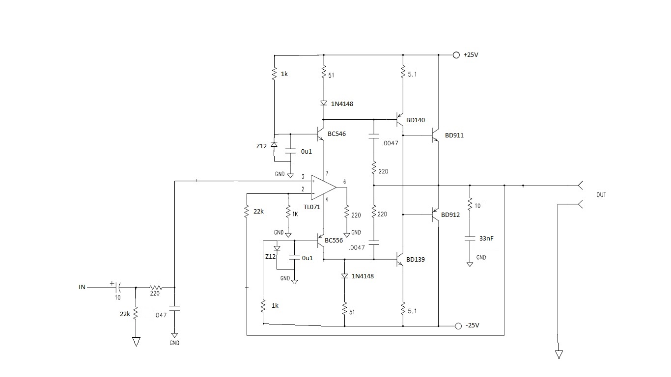

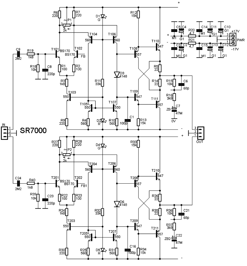

BJTs also can be use instead MOSFETs
What BJTs i can use instead BS170 and BS250 Mosfet???
Thnx
Regards
Thnx
Regards
BD139/140

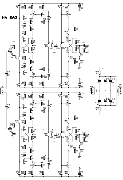

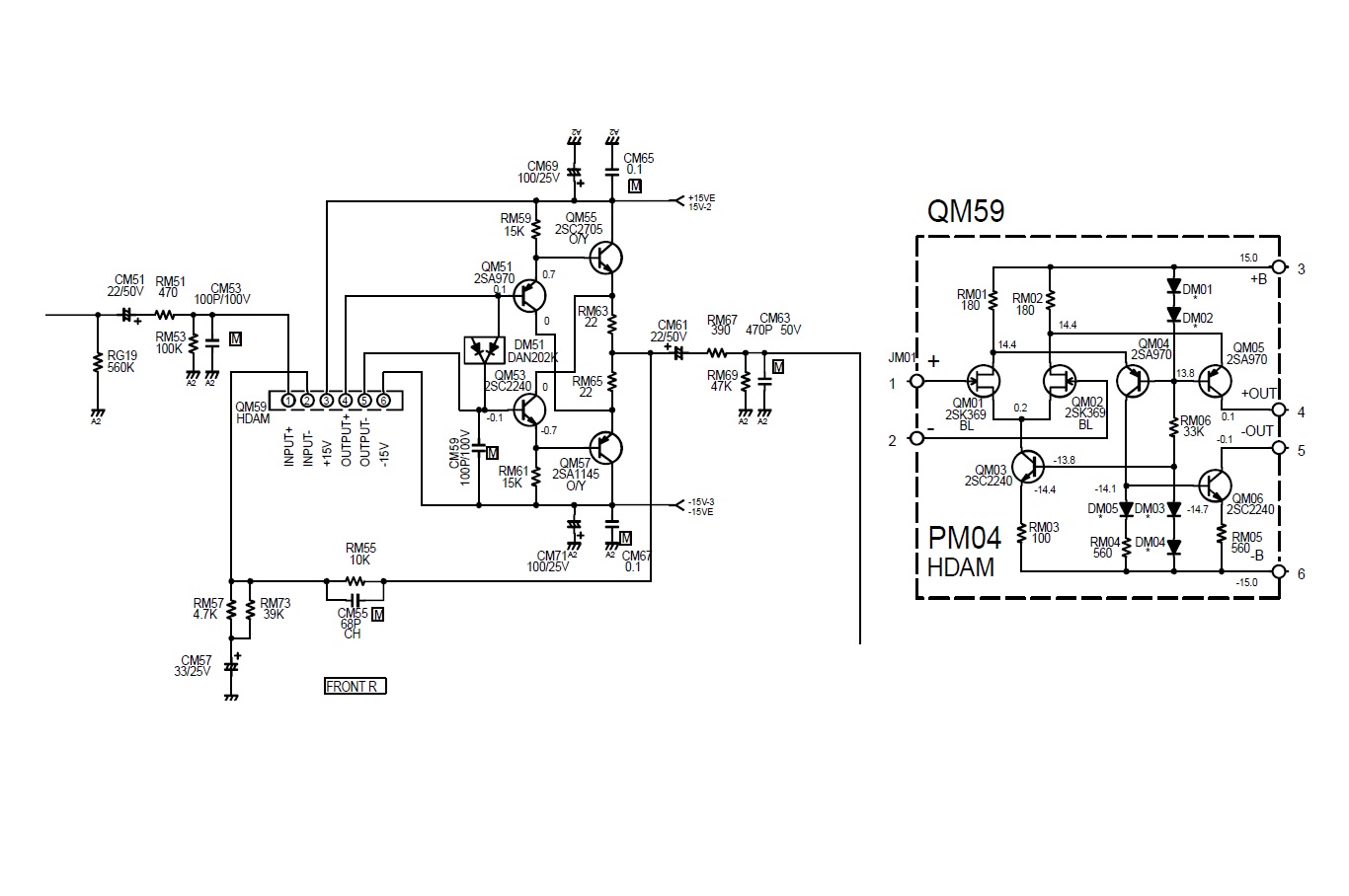

need 16 ohm amp
Dear, Mr Mile. Can drive this LS?? Or change some part.
LS was 35w/16ohm.
BJT amp
LS was 35w/16ohm.
LS was 35w/16ohm.
Yes you can drive this LS without any change.
better images...
SR7000 is fet input preamp...

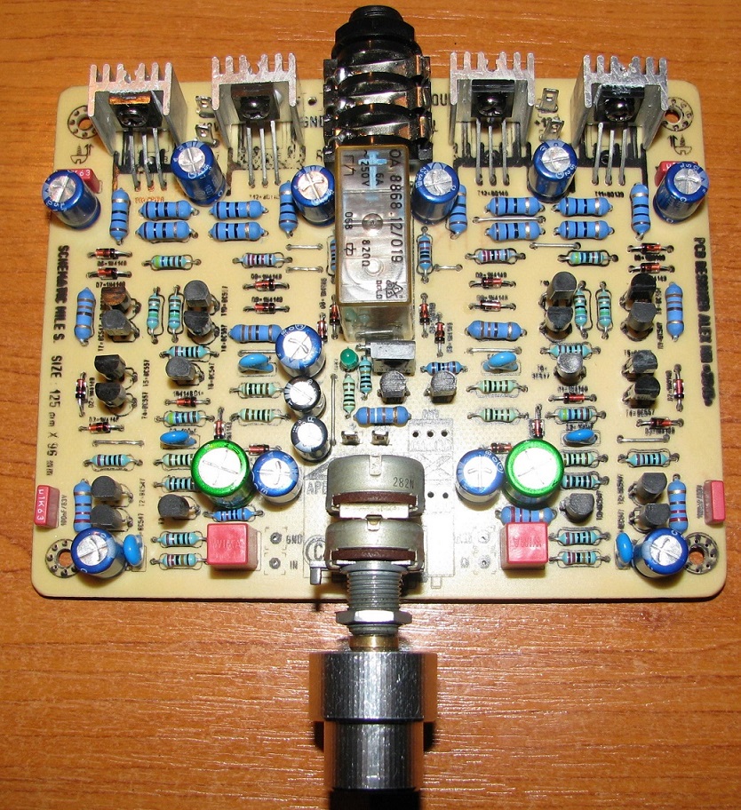

about Mosfet Headphone Amp
hello apex
I have some question about Mosfet Headphone Amp can i connect
it to laptop without any changes ?another is what is difference in sound quality
when use bjt BD139 ,140 instead of mosfet .
hello apex

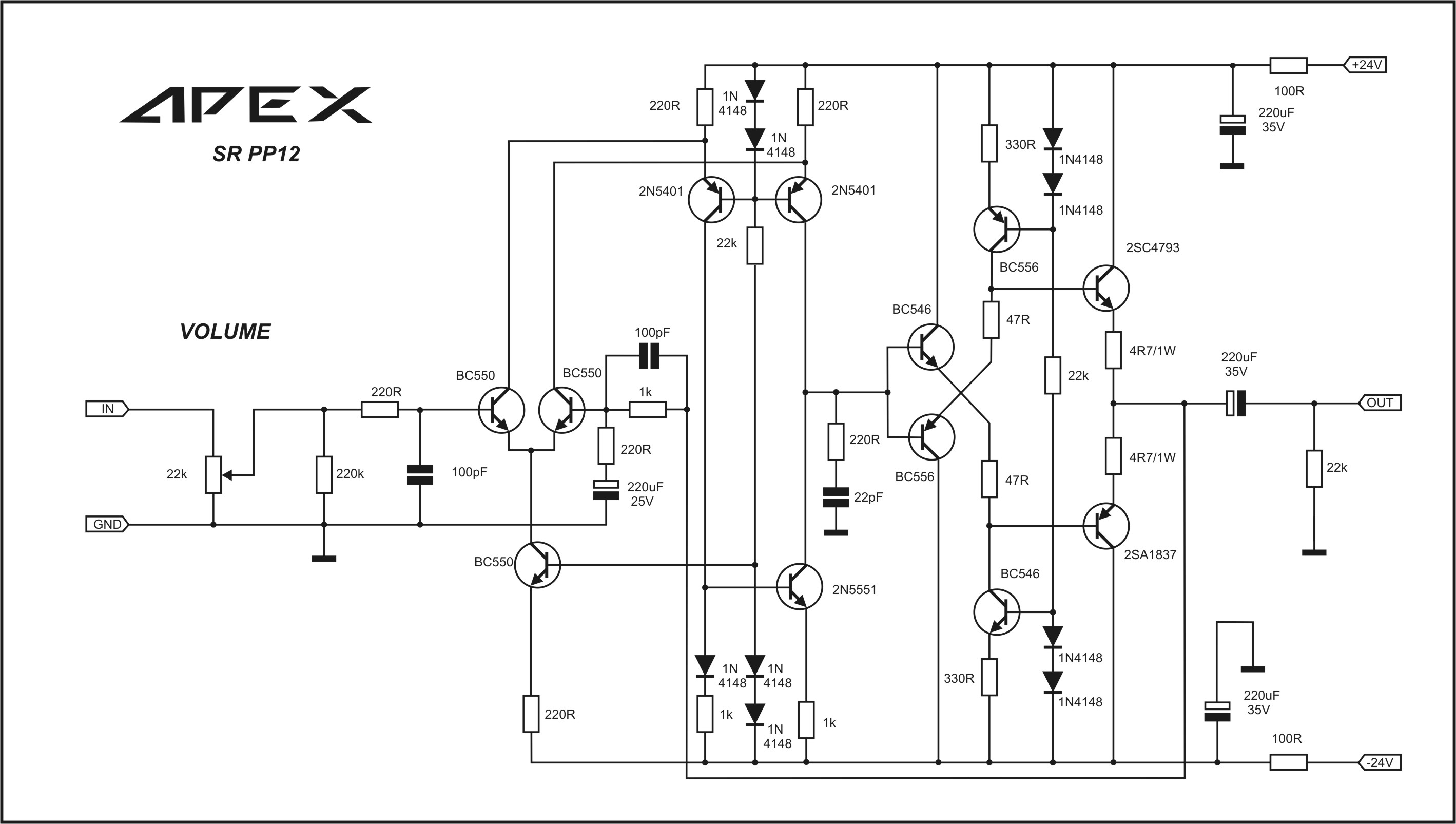

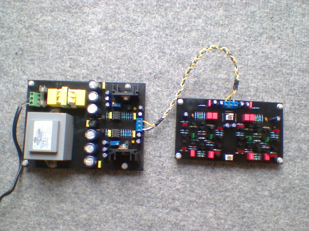

Folded cascode headphonr amplifier
Mr Mile, can this schematic (headphone amp) be also used as a pre-amp
for your A40 amp?
I'm planning to build a preamp AND headphone amp in one encolsure.
I guess they are similar enough to only do ONE circuit that can do both.
Alternatively, is there a way to change your P30 preamp, so it can also drive headphones??
Terry's enthusiastic recomendation of P30 + A40 made me thinking
about it..
for your A40 amp?
about it..
SR PP12 is preamp and can be use as headphone amp. You can use it for A40 or any other amp.
Regards
Regards

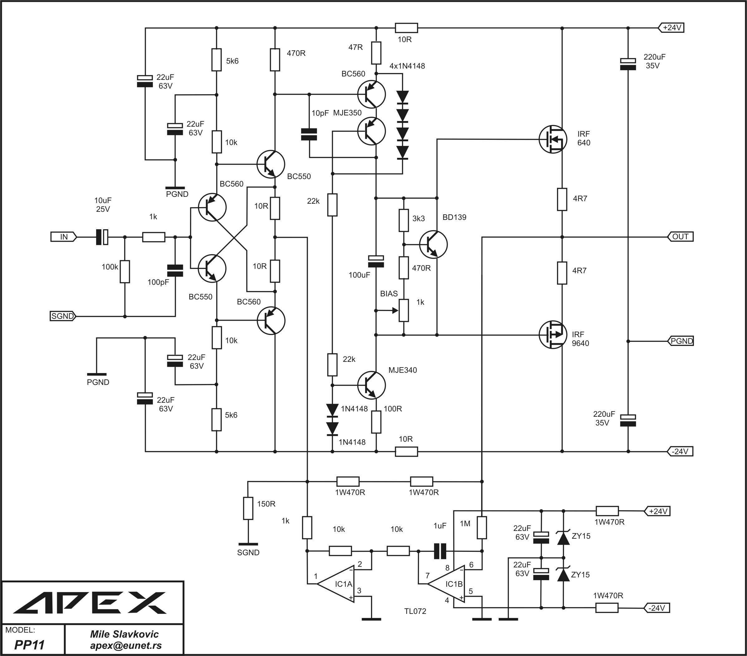

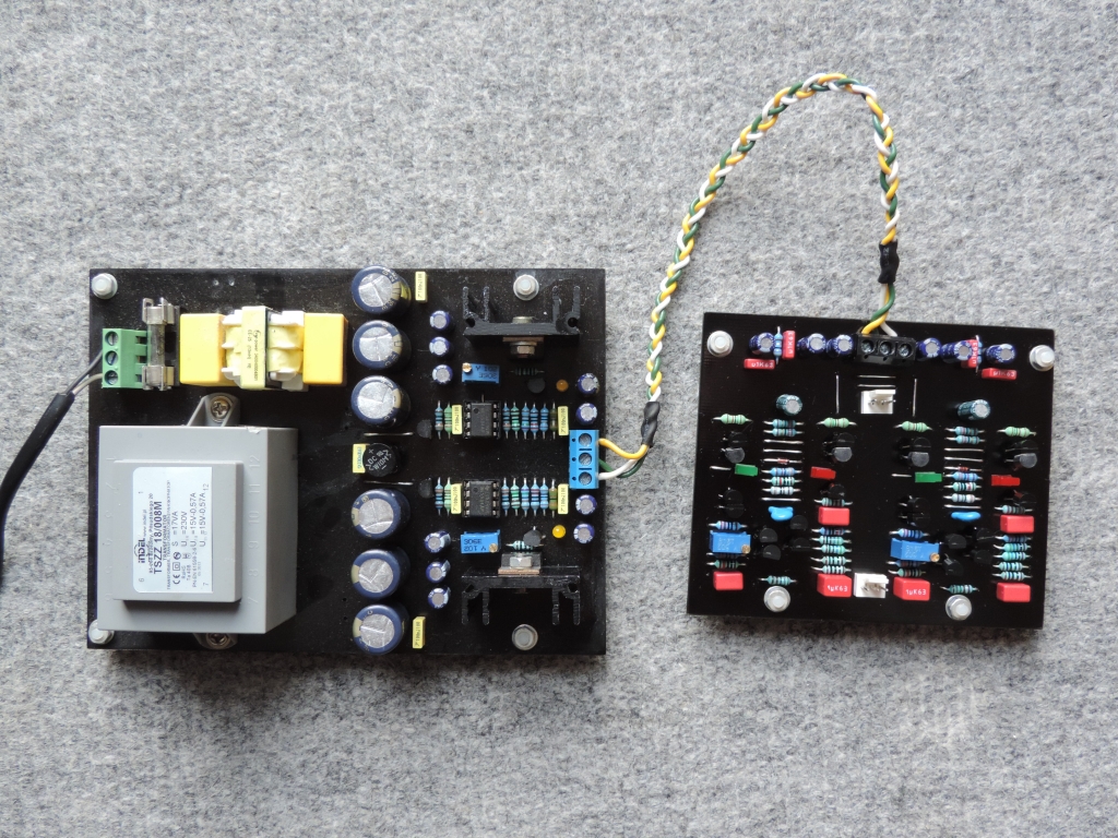

Mr Mile,
Which one of your designs:
a) PP11
b) PP12
c) P30
would you recommend as a pre-amp ?
My power amp needs input of 7Vpp before clipping.
Can PP11 or P30 be also used as a headphone amp? E.g. by adding a buffer to drive headphones (e.g. BUF634 chip?), or by changing output transistors and emiter resistors?
Thank you for providing your schematics and help!

PP11, PP12 can be use as headphone amp or preamp. PP11 is CFA and PP12 is VFA topology.
P30 can be use only as preamp, if you want CFA headphone amp PP11 is the best.
P30 as headphone amp will be A33 or A40 with single output pair and 4R7
emiter resistors.
7Vpp is not problem, any preamp can give this output level without clip.
