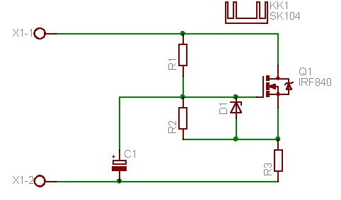

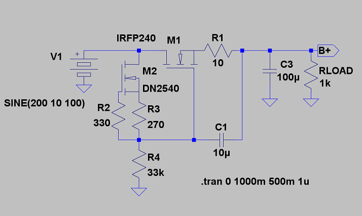

Mosfet Gyrator using the IRF840
Could I use the IRF820 instead? With the same values?
I'm thinking of building a Gyrator for my Baby Huey EL84. Maybe even two. And I have IRF820's in my parts bin.
I know very little about solid state things like mosfets, hence my question.
R1, R2 330k Ohm
C1 4.7uF
D1 ZD15
R3 33 Ohm
Q1 IRF840
Also any tips for improving this gyrator?

Bas,
This is not a strict gyrator. Despite that, it has two advantages. You can adjust output voltage(vary R3) and it has a lot less ripple than a typical MOSFET gyrator. Still it has the exactly the same high Zout. C3 is not part of the gyrator.You might also change R1, C1 to your values if this suits you better.
Of course, when in the mood and want to shoot for the stars you could go for the full shebang low output impedance shunt reg with everything on it 😀
The zeners can be replaced by suitable resistors to get lower noise.

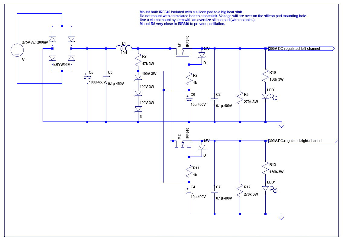

But I'll think I'll go for your schematic Lars. Could I use the IXTH 20N50D? Instead of the IRFP240 Because I'm going to have those in my parts bin soon. Any changes? Sorry about all the questions. But I'm clueless on anything solid state.
That would work. But the CCS depletion FET should be small like a DN2540 or LND150 as you should only run 1-5mA through it.

Another circuit to consider would be salas' simplistic high voltage regulator. Quite a few people have built that one and are happy with it.

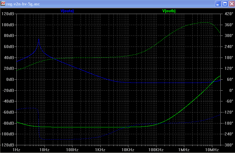

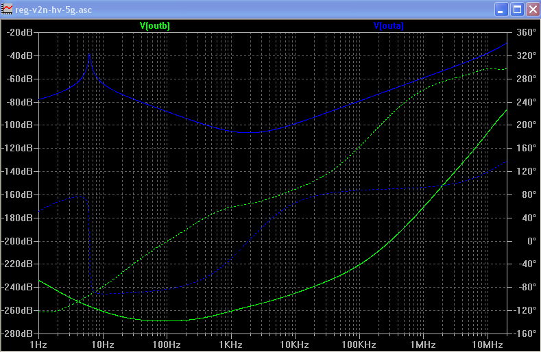

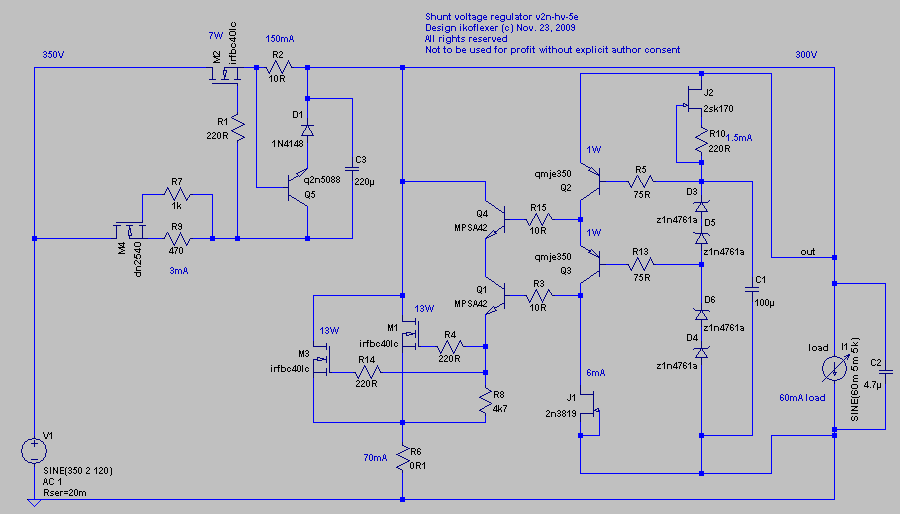

I like Lars' circuit. For something quick that's the one I'd also go for, it has good psrr. I'm not very familiar with the baby huey amp and how much it would benefit from a low output impedance supply. But if it would, then check this out. A bit of simulation here. The green line is a shunt regulator, the blue line is Lars' circuit. It is unfair to compare the two, one being easy to implement and requiring only a few parts to build, while the other being a project in itself. I'm working on a pcb for the regulator but I don't have that much time for the hobby lately, so progress is slow.
PSRR
ZOUT
