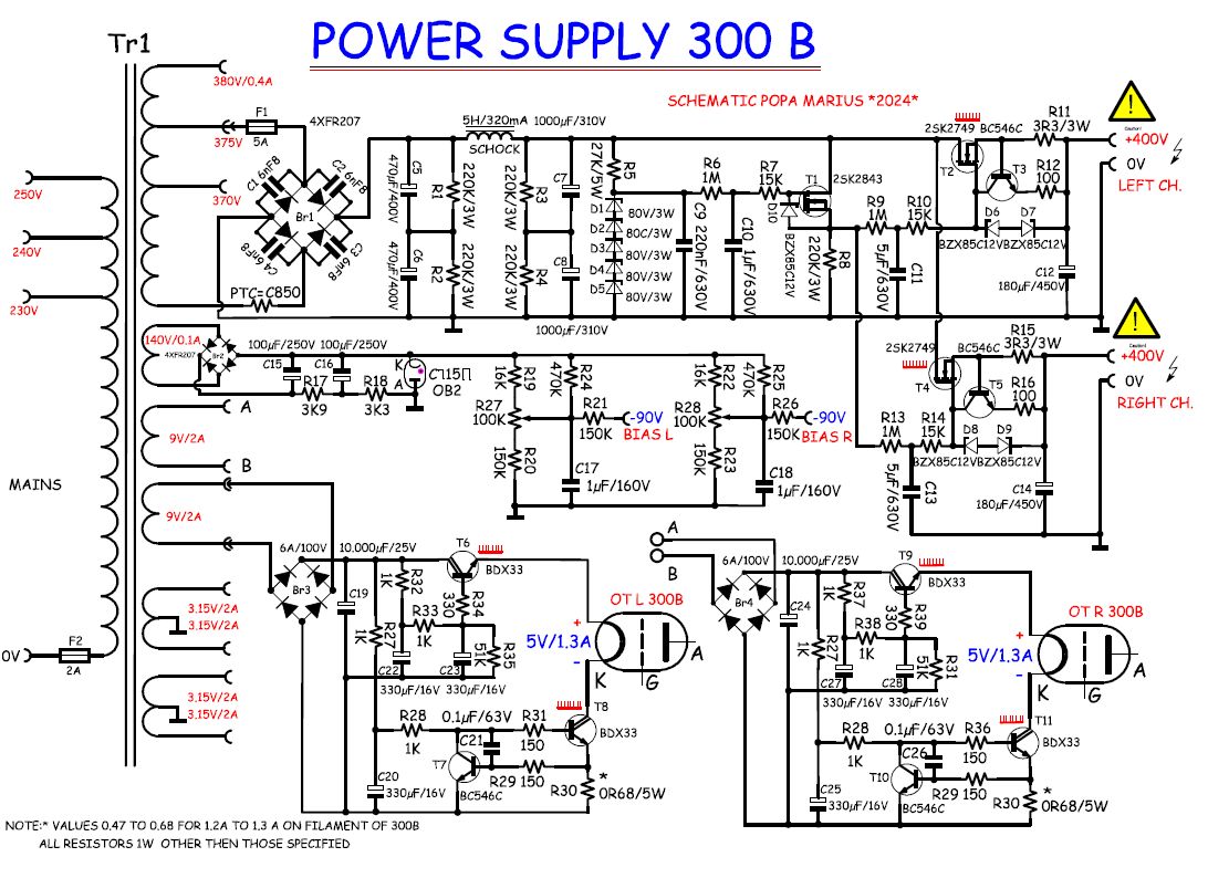

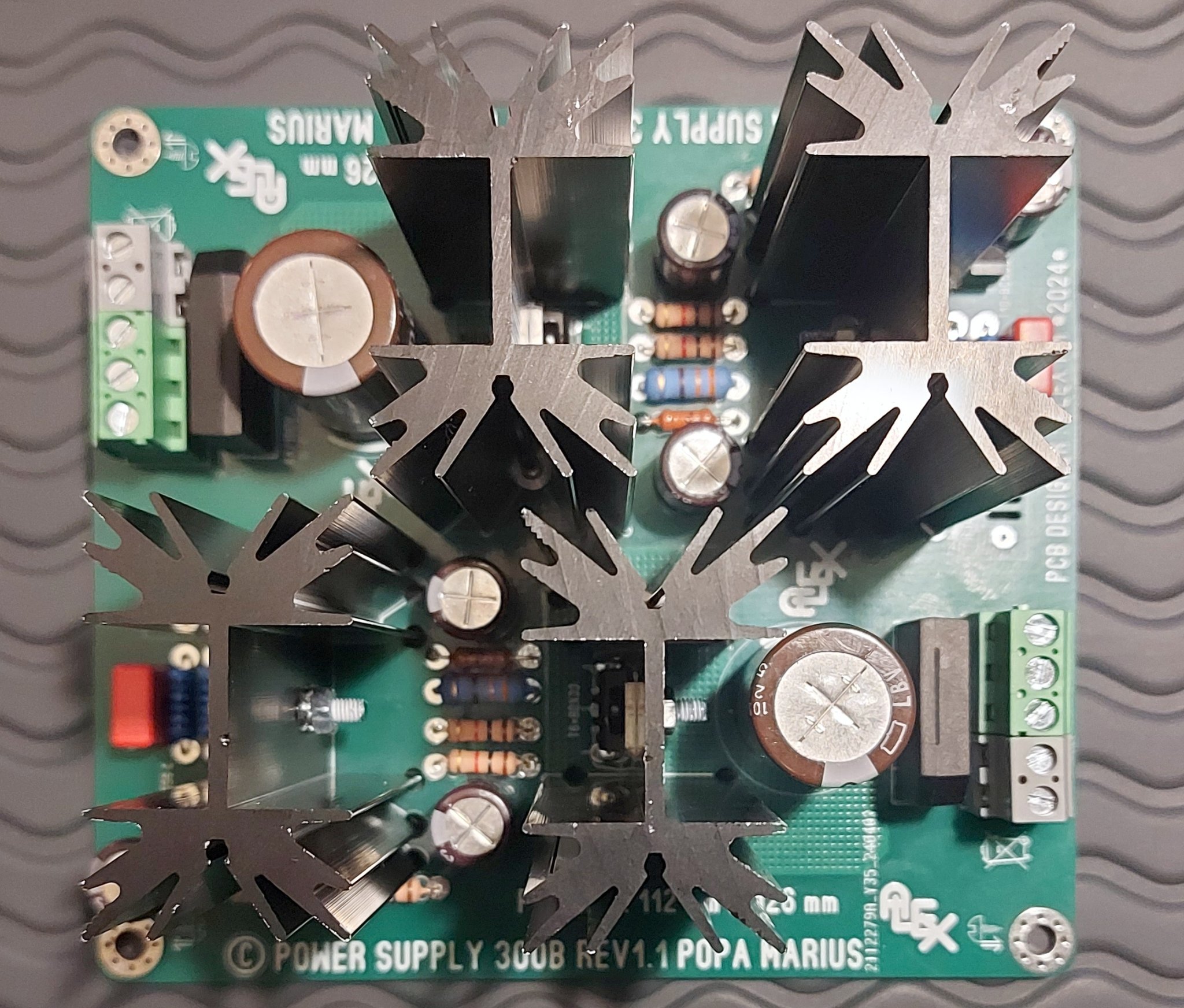

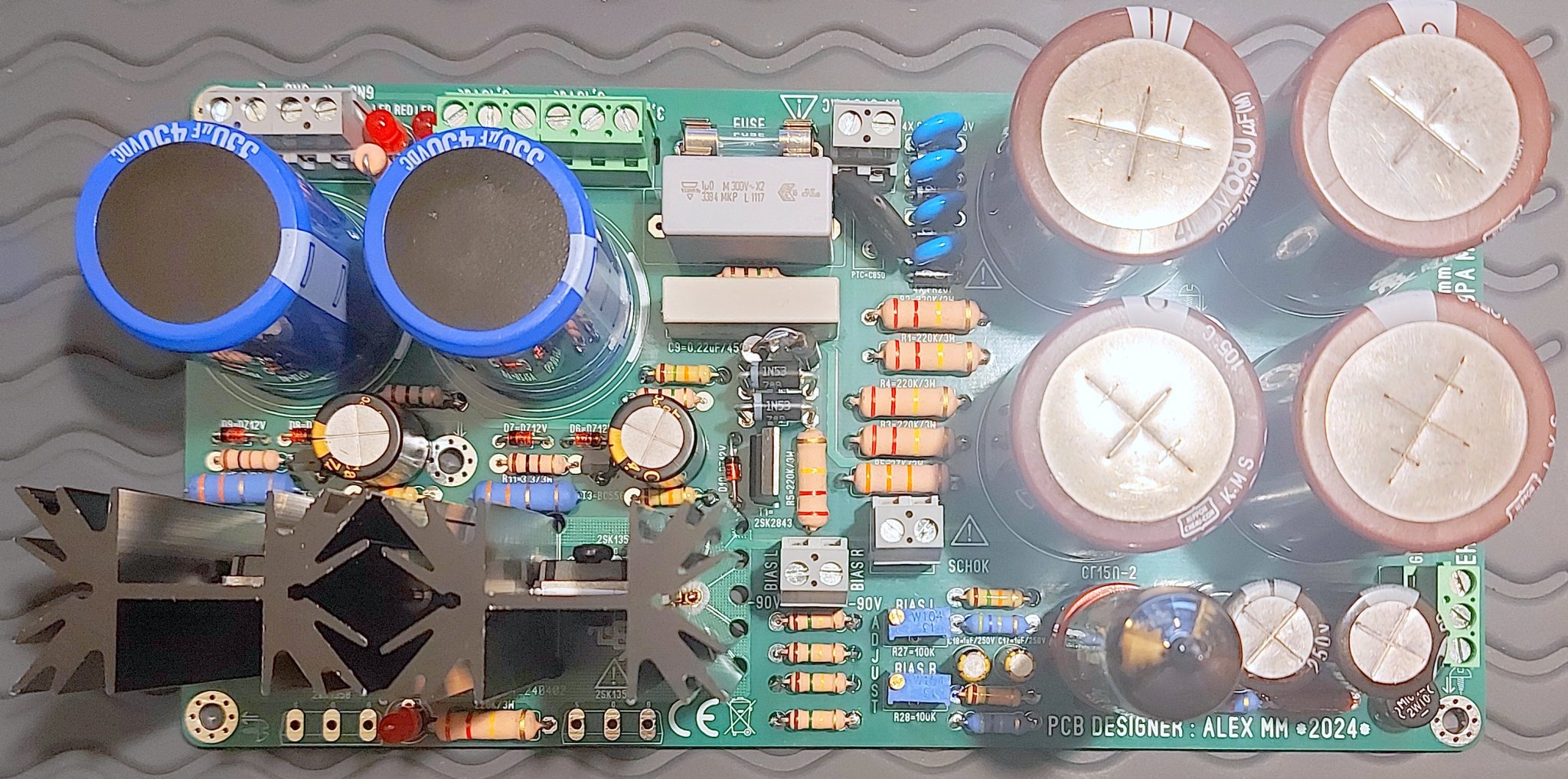

Looks like a serious PSU!!Recently have tested this power supply for my SE 300B amplifier with good results.
Hi...are the smps for the filaments?
I tried smps on my DHT filaments and found my trusty Sic Schottky diodes -> LM317t -> with a couple of power BJT's to boost the current had a much better tone, (I found smps cold and unengaging sounding) . I used 2 x 68,000uF caps in the supply

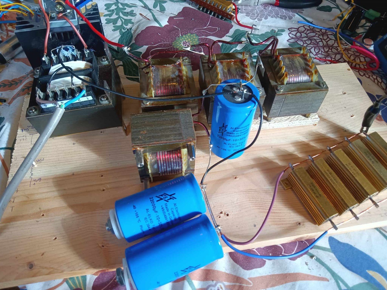

Yes, I used SMPS for the initial tests. They are now replaced with LCLC-filtered supplies using 3x 1,1mH 10A iron core chokes and 5x 22000uF per channel. Still on a breadboard while I'm working on a chassis that has room for those gargantuan filament supplies plus a better HV supply (tube rectified).Hi...are the smps for the filaments?
