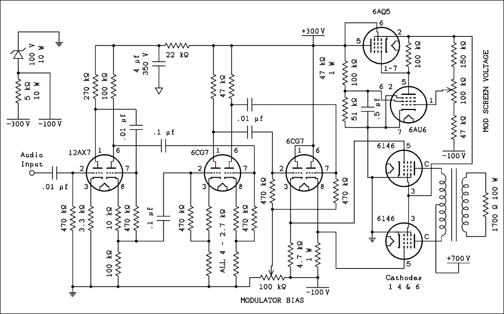

I am going to reverse what I said originally. MOSFET Source Followers on the Cathodyne Phase Splitter will help because it puts a Class A operating load onto the Cathodyne so that it is never subjected to the very low load impedance of the an output tube with grid current and therefore the Anode/Cathode loads remain balanced.
Here is a 200Watt AM Transmitter Modulator circuit for reference - note that the Cathodyne phase splitter has cathode followers on it. Note the output tube grids are direct coupled from the followers and the bias is applied at the follower grids. You could do this with MOSFET Source followers. Ignore the 6AU6 and 6AQ5 which are just a screen supply regulator.
Ian

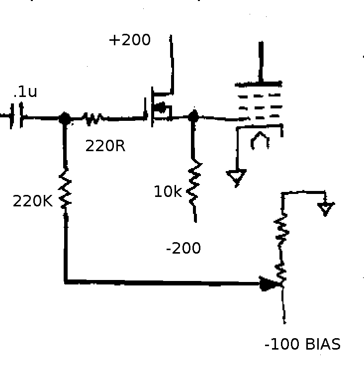

Thanks for the reference, it confirms the way I was going to implement the source follower. I will post a schematic once I figure this out some more, for I can't seem to get it to work correctly in a simulation😕
I omitted the cathode bias scheme for the 6V6's and tied the cathodes to ground through 1R resistors. For mosfets I used IRF630's and tied the drain to 200v source, the source to a -200v source through 10k resistors, and the gate was tied to a -100 through a voltage divider for the bias. No matter what I change the -bias to I get 200mA through each 6V6:headbash: The IRF630's are AC coupled to the cathodyne PI. What am I missing?
-bird

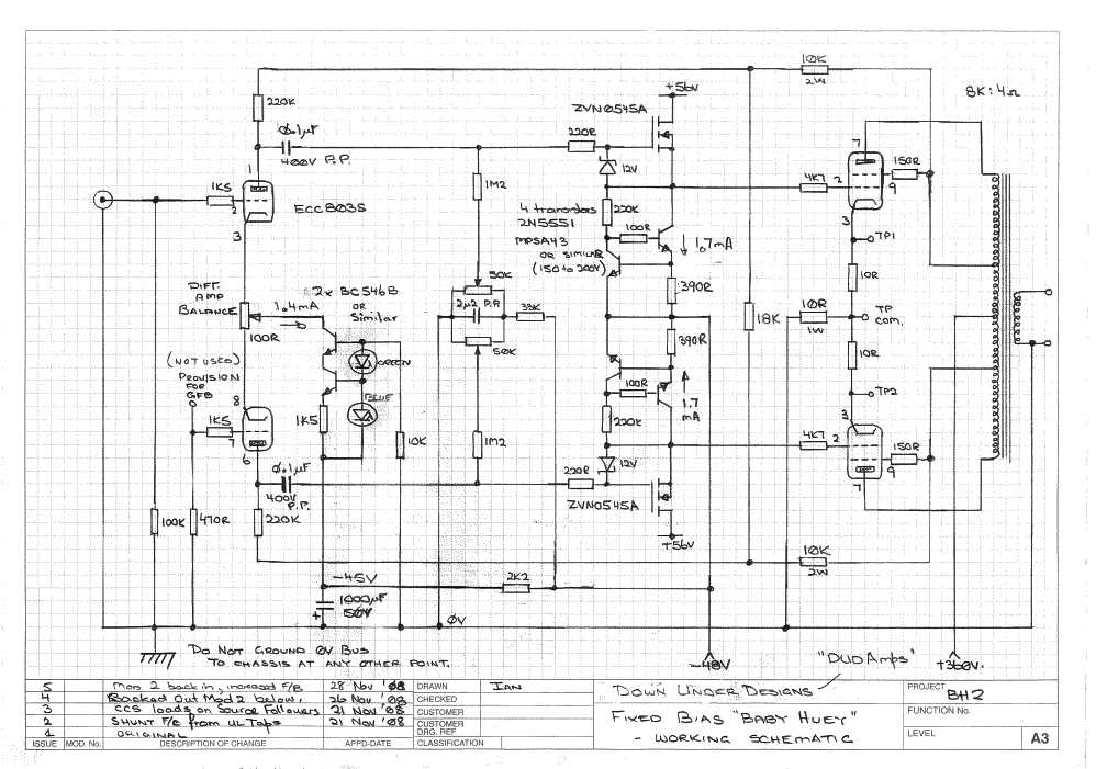

I don't see anything wrong with the schematic sketch so would suggest that there is something wrong with your modelling schematic capture or similar.
I do exactly this in my HiFi Amp except "spiffed up" with current source loads (instead of resistors) on the source follower. Here is that for your possible intertest. The 1.7mA source follower idle current was sunbsequently increased to 3mA but 1.7mA would be plenty for a guitar amp.
Ian

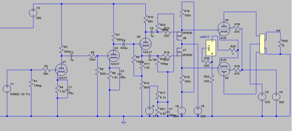

Here is what I have so far. I am thinking of using a DPDT switch, one side to put the 6V6 cathodes to the LM317 or straight to ground. The other side will switch between a positive bias supply to use with the LM317 CCS and a negative supply when the cathodes are at ground. This should give me a lower powered class A2 mode and a higher powered class AB2 mode. The mosfets are running at 2mA and the LM317 is setup up for 80mA putting the cathodes of the 6V6's at 20v.
If you want to go for AB2 then don't forget a voltage/current limitation function at the control grid of the power pentodes.
Otherwise you risk to blow up the control grid in case of overdrive because the Mosfets can deliver high current.
Do you happen to have any schematics with this "voltage/current limitation" implementation? And would I have to worry about the grids melting if I just go with A2 operation?
Of the various resources online that I have seen that uses cathode followers or mosfets to drive power tubes I haven't seen such circuitry. I do plan on using Pete Millets board for this project which has protection diodes to prevent the mosfets from failing due to reverse breakdown voltage.

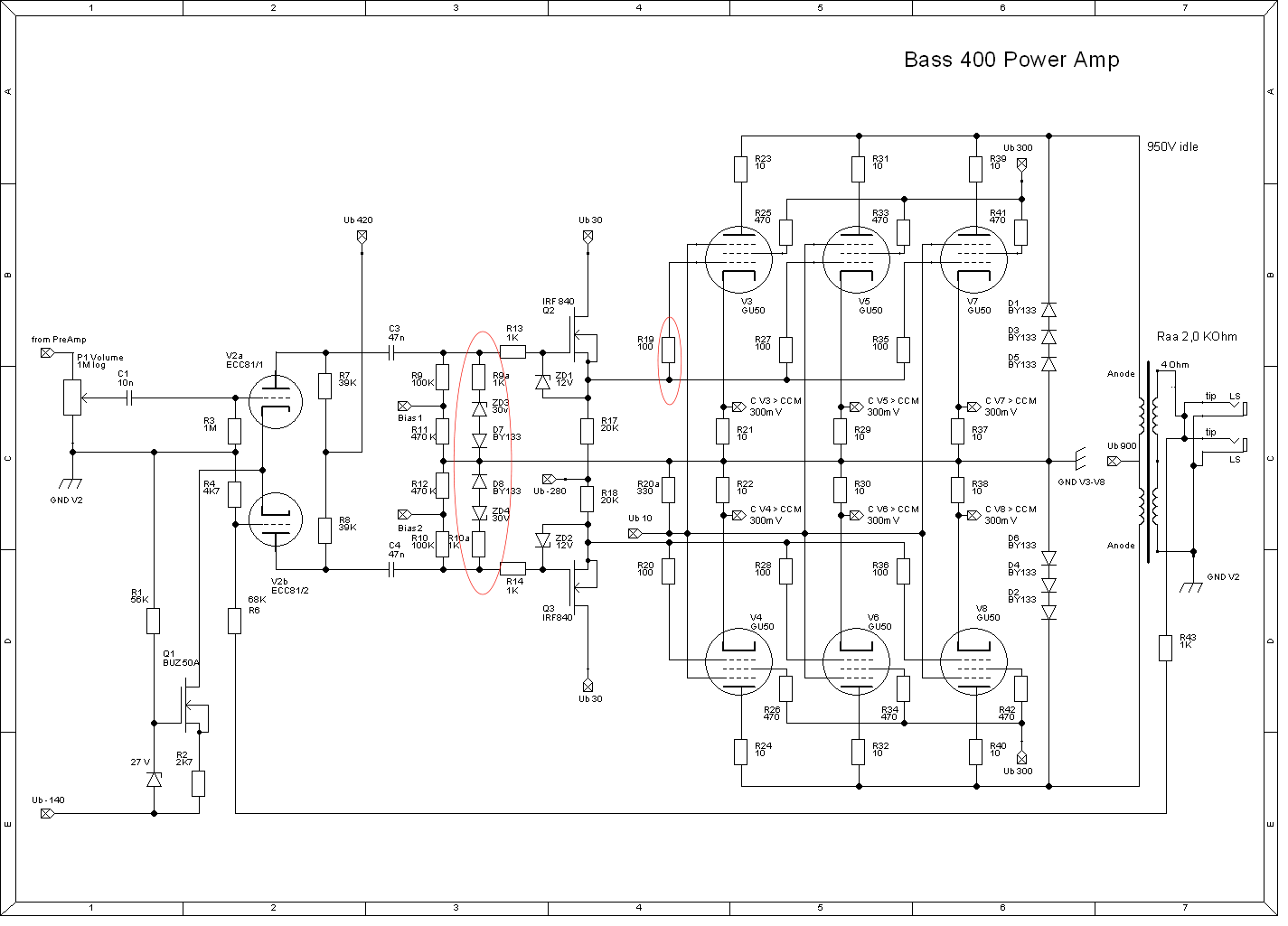

Aa an example you will find the power stage of my 400W bassamp. The limitation is done with R9a/ZD3 ans R10a/ZD4. The max positive voltage at the source of the IRF 840 not more than ~25V. The grid stoppers R19/27/35/20/22/36 are preventing oscillations and were used to measure the grid current at the GU50 during development. This tube can handle 1W dissipation at the control grid according to specification.
I don't know that value for a 6V6, my personal guess is less than 0,3 W. The value of the Zenerdiode needs to be adjusted as well as the gridstopper value.
To start from the safe side I would first go with a grid stopper of 1K and measure the gridcurrent with a differential probe with increasing drive to calculate the grid dissipation.
Hans- Georg
