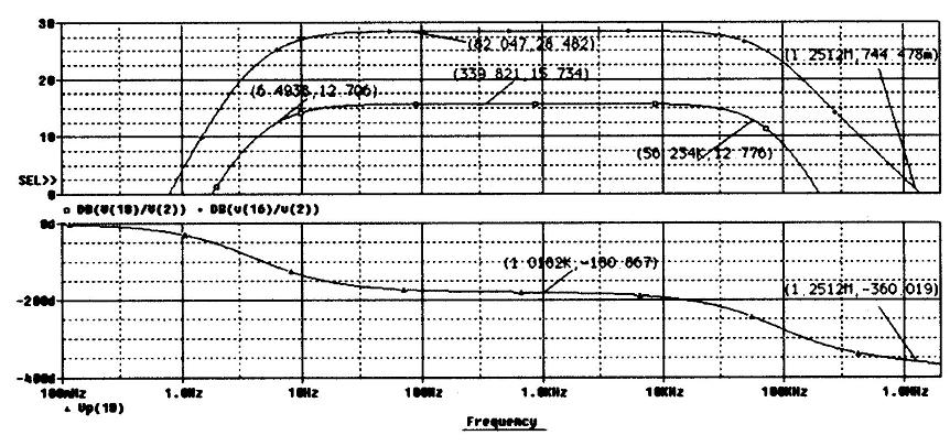

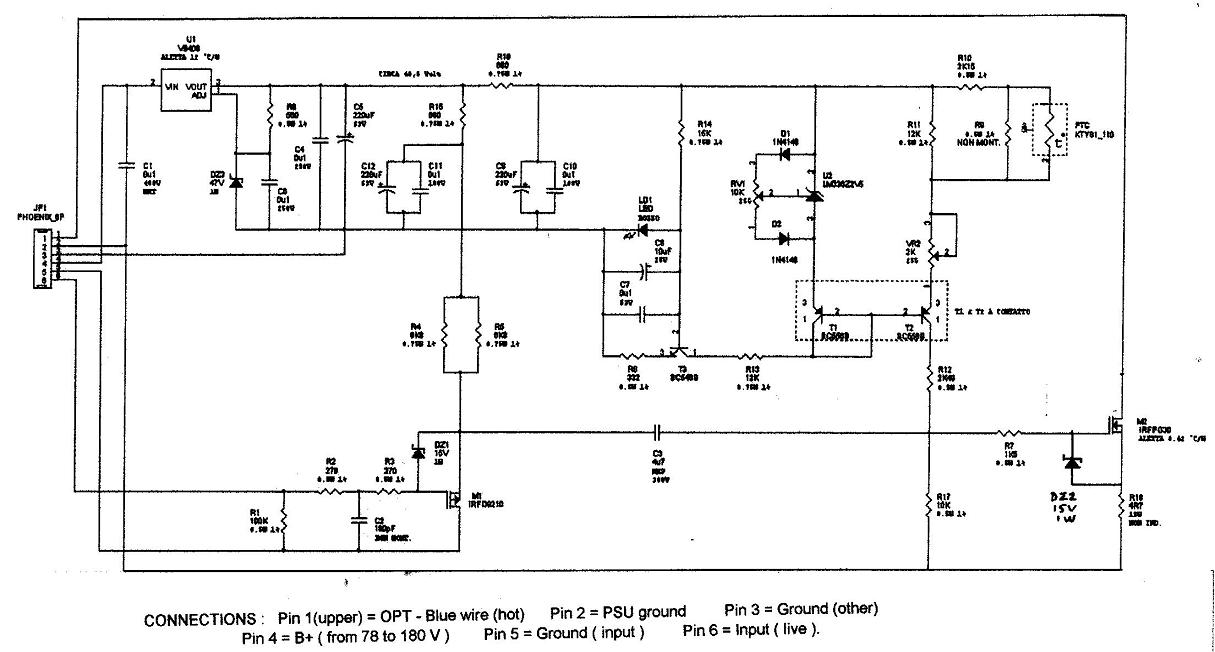

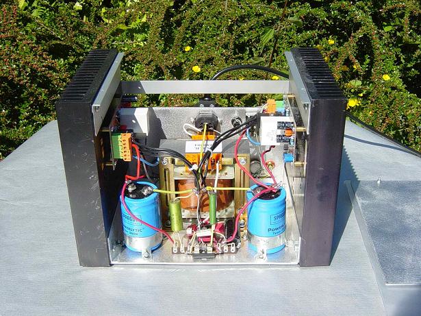

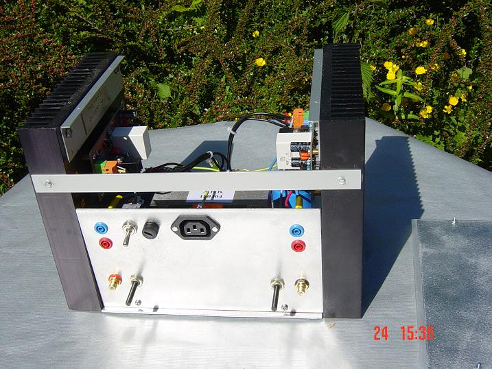

My son has built a Single ended ( yes, single ended ) Mosfet amp, using a heavy duty OPT.
Based on the theory that Mosfets behave very closely like valves, we fitted, as a trial, two different types of OPTs, that had been previously used with an amp fitted two parallel 6C33C-Bs (estimated internal resistance = 50 ohms ).
The first OPT had an impedance of 300 ohms, the second 800 ohms.
In spite of the fact that the mosfet ( an IRFPG30 of the International Rectifiers C° - used with B+ = 130 V at 500 mA current) is stated to have a much lower internal resistance, the best results, in terms of sound ( at circa 20 W output ), were obtained with the higher Z ouput transformer.
This suggests a peculiar dynamic behaviour of the Mosfets, compared to valves.

Dear Alex,
Thanks for your explanations.
The two problems you stated are under control ( temperature and frequency). In fact, the range extends beyond 70 kHz.
But I do not understand the comparison with the penthodes.
These have notoriously a high internal resistance, whereas the Mosfets are supposed to have a very low one ( few ohms or less).
Ari.

You can draw a load line for MOSFETs the same way as for valves. Another thing about the differences in the transformer loads could be the primary inductance; if the high impedence transformer has a higher inductance, then it will have a more extended bass response. This will make it sound better. 😀

Dear Ari
As the mosfet have a high transconductance (more than 1 S = 1 amp/volt ) and can output many amps of current , you can't use a high impedance output transformer , because that way ,you will have a very high voltage output excursion at the mosfet drain..
Imagine a mosfet outputting 1 Amp in a 1k Ohm load it will make a voltage swing of 1000 Volts

What are the rail voltages? I'm curious why you would use an OPT with a mosfet because they work under lower voltages and higher currents than tubes. But I'm far from being an expert...
Thanks, I am beginning to see the light ( although some explanations are - in my head ) conflicting.
Dear Evaas - I will try to reduce the file size ( schematics and photo) to an acceptable value.
If I do not succeed, can I send it to you direct by e-mail ?
