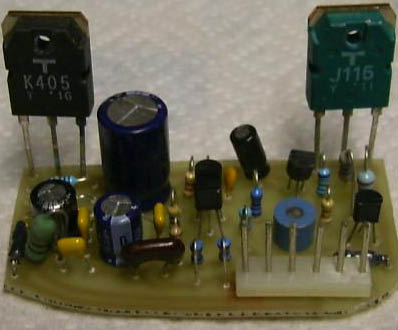

Hi, I designed and made boards from the schematic in AA. I went with the complimentary version because it made more sense to me. I am including a picture of one channel. With a + and - 55 volt supply I am getting 85 watts into 8 ohms. They sound GREAT. I used these both for a home unit and built a smps to use them in my car. Over ten years, two cars and going into the third. Works flawlessly! The circuit is so simple, it can be breadboarded easily. Thanks to MR. Pass for sharing his knowledge. Regards, Steve😀
