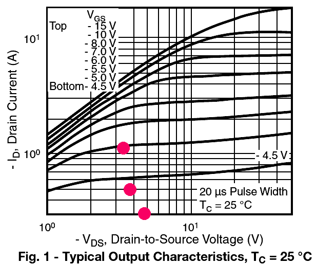

Here is my question. I am at the limit of my skill set and have the following data to determine if this device will live long term and whether the mosfet is in saturation or linear region. I cannot tell how to really read the VGS data and correlate that to the IDS.

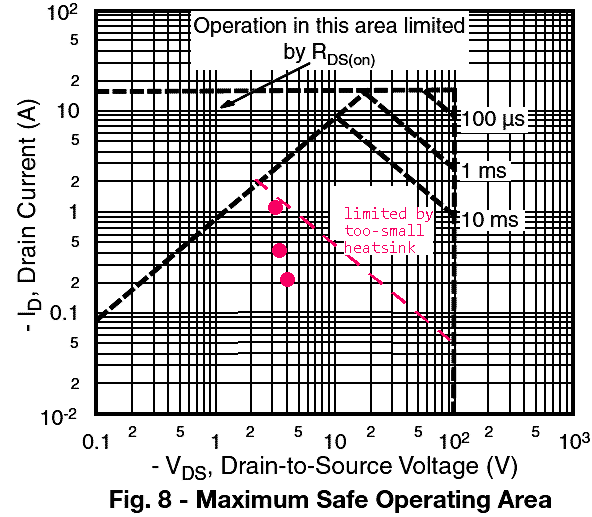

Lastly, I am having the most trouble figuring out how to read the IRF9510 SOA of the device under the following conditions.
Amps = .220
VGS = 2.33V
VGD = 1.40V
VDS = 3.71V
Amps = .435
VGS = 2.40V
VDS = 1.25V
VDS = 3.67V
Amps = 1.1
VGS = 2.58
VGD = .733V
VDS = 3.391V

The 1.1A 3.4V condition is under 4 Watts. That IRF is a 43W part.
If the heatsink is too hot to touch, it "may" be OK. The part is rated for 175 deg C, far past the boiling point of water. However _I_ would not want it run that hot. If this is really your op-point, you want a bigger heatsink.
But why three test currents? You apparently want to heat a PAS. The heater current should be known. Not counting the rectifier, 0.6A, right?
Unless you have w-i-d-e wall-voltage variations, I don't see why you need to regulate a PAS's heaters. Add a resistor to compensate for loss of the Selenium rectifier(?). If you do have wide variations, that "3.391V" will be much less at low line, drop-out, no regulation at all. At high line, the IRF will be much hotter.
I can understand wanting to understand. The IRF9510's log-log plots make me dizzy. I have attached my understanding of your three points, curves and SOA. The curves appear to be "drain saturated" (good), though very slight drop of wall voltage puts you on the knee. The SOA would be safe if you had an infinite heatsink, which you don't. You must plot the safe Power for the heatsink and ventilation you have. I plotted a guess; very slight rise of wall voltage might put you over.

using your heatsink = Ts = 51degC
and assuming you have an Rth s-a of 1.2C/W
then 1.1A @ 3.4Vds gives a Pq=3.74W
The Tc will be 3.74W*1.2C/W = 4.488Cdegrees above the heatsink temp. i.e. Tc=51+4.5=55.5degC
The temperature de-rating for a 175C device is (175-Tc)/(175-Ta) = 119.5/150 = 0.797
your 43W device is de-rated to 0.797*43 = 34W when the heatsink is @ 51degC
you are passing 3.74W through that 34W device so that's only 11% of it's capability.
I would generally advise that the operating Pq use less than 50% of the temperature de-rated power capability.
Repeat the modelling for a 70degC heatsink and see what proportion of the capability you would be predicting.
For the sake of learning (not for actual operation) try repeating for a 100degC heatsink.
And try Ts=100degC, when Pq=2W
