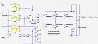

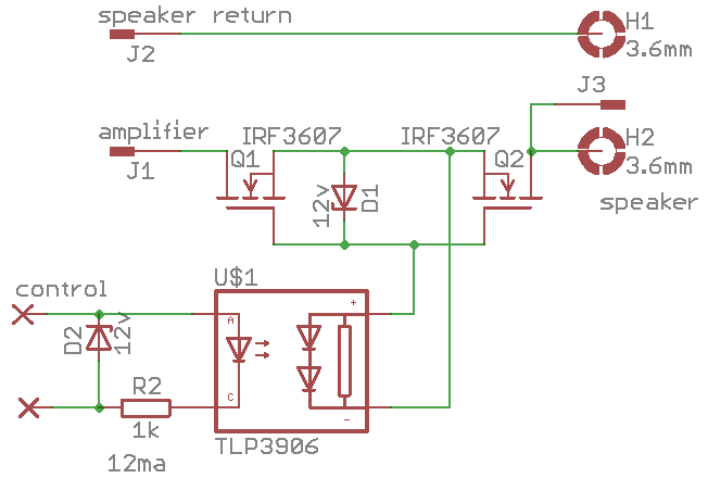

Mosfet-based replacement for loudspeakers relays

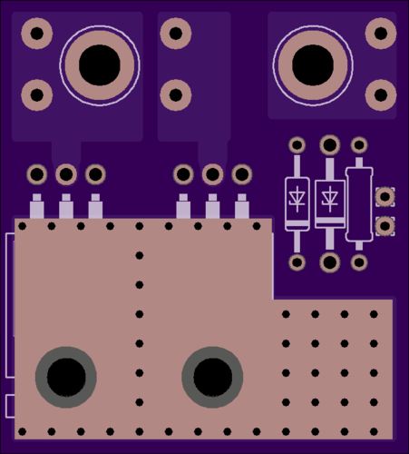

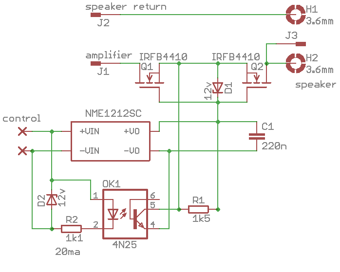

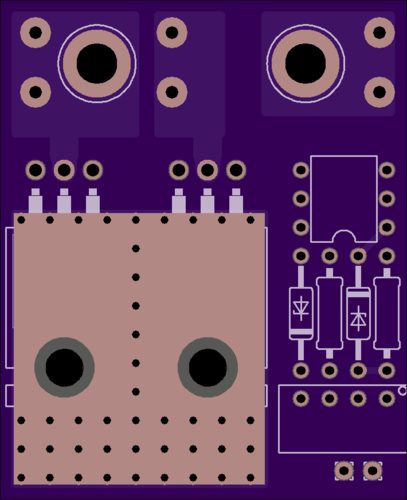

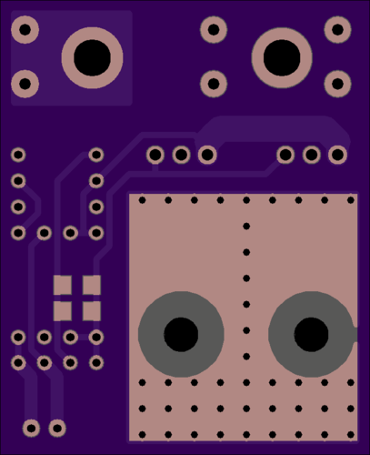

Up till now, I've been using relays to protect loudspeakers. I must say I'm uneasy about using parts underrated for the job (most relays DC current ratings are terrible).
Uneasy enough to consider replacing the relays by a mosfet based solution. Would the following schematic seem ok ? Inspiration comes from the esp pages on driving ssr. Rod Elliot dismisses the dc-dc solution because of cost but a 1W murata is now less than 6€. Add a pair of irfb4410 (8m rdson @10Vgs), a cheap opto and you're set for 10€ (pcb excluded)
attachment.php
The requirements are:
- it can be used as a direct replacement to a relay, controlled by an existing offset protection board (in my case, based on the esp33). Just a pair of wires to run.
- it is made to be used with amps with up to +/-50vdc rails.
- it is made to be directly mounted on binding posts with 3/4" spacing.
- it is made with parts in stock at Reichelt (ease of ordering).
Any trap I've fallen into ?

Definitely do it, MOSFET is the correct way to protect a speaker from DC IMO. It has initially lower resistance (with low Rds MOSFETs chosen) and maintains this value throughout its life, is actually capable of breaking a DC fault current and can do so repeatedly, acts much faster, cheaper than a relay with remotely comparable performance for this task and with modern parts can even be simpler to implement.

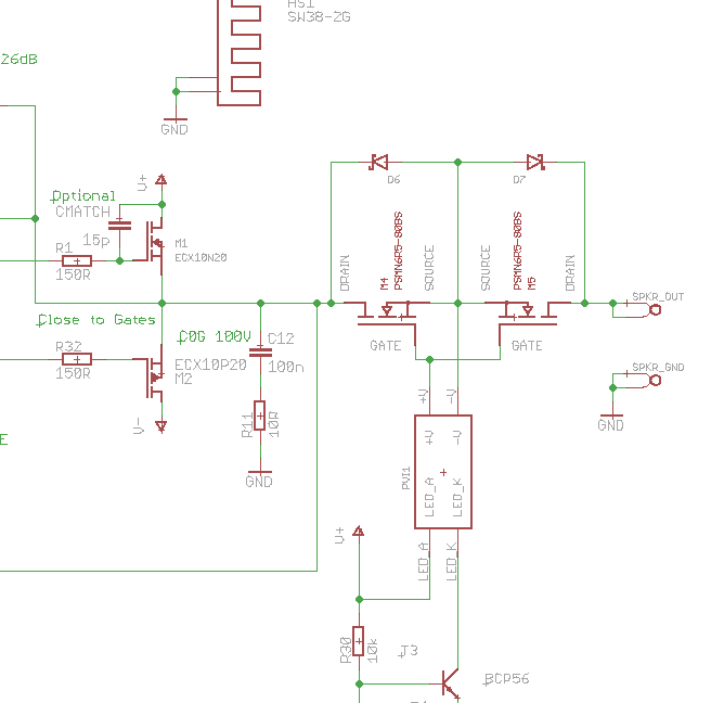

Which brings me on to the PVI, or photovoltaic isolator. While your circuit should work I'd simply replace the DC-DC and opto with a cheap PVI like the APV1121, this generates a decent voltage drive of very low current and this device even includes a fast turn-off circuit inside, which is where switching speed counts! Even if you use very high input capacitance MOSFETs then turn-on time will still be faster than a conventional relay.
Attached is the MOSFET muting relays I use in my amplifier, it's been in service for several months now and performs flawlessly. The only small caveat is that 'off' isolation will be relatively poor at very high frequencies due to MOSFET Coss, you can select to minimise this somewhat. In practise it's not an issue, it blocks any turn on/off noises and blocks DC entirely. Good luck :)

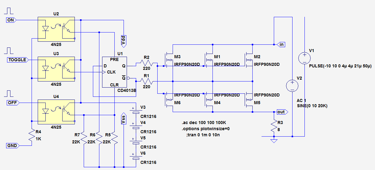

Fully off, there's no dissipation. Fully on, a 45V sine wave (peak, into 4R) gives only 350mW of average power per device.
Switching off heavy dc loads (in case of a fault) leads to some crazy power but for only a short burst.

Rethinking this tvs issue.
If I put the tvs accross the mosfet, the working voltage has to be equal or superior to the rails of the amplifier, to avoid the tvs conducting in case of a fault.
Let's take a 50V rail amplifier. In that case, the first bidirectionnal tvs with a >50v Vrm is a 68V nominal tvs. Breakdown voltage is between 65 and 71V. Clamping only 92V.
So, for a +/-50V supply, we need a 68V tvs and a 100V mosfet, right ?
PS: this might be a bit conservative. A 56v nominal tvs with a working voltage of 47V, a minimum breakdown voltage of 53V and a clamping voltage of 77V might enable the use of a 75V mosfet.

Very nice! Thank you. :)
I have lots of IRFP9240 - can that work?
In principle, yes, but it wouldn't be a very optimal choice: because they are P devices, the polarity of the controls would be reversed (ON becomes OFF and vice-versa) which is no big deal, but P devices suffer from a higher Rdson, everything else being equal.
Of course, if you have buckets of IRFP9240, that's no obstacle
