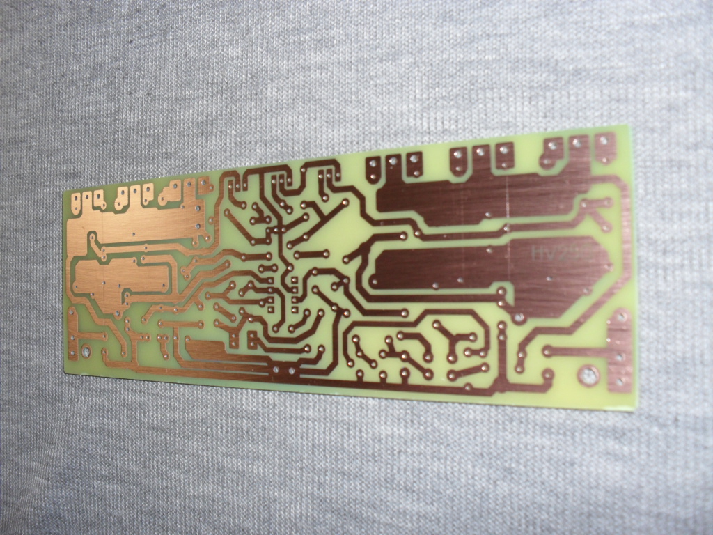

When you want to try the circuit in 2 hrs there’s no substitute to etch your own. I agree that for $2 plus $14 shipping from China, that’s what I resort to when not in a total hurry. In fact, my $2 JLCPCB order for some cap multipliers should be here in a few days. :)

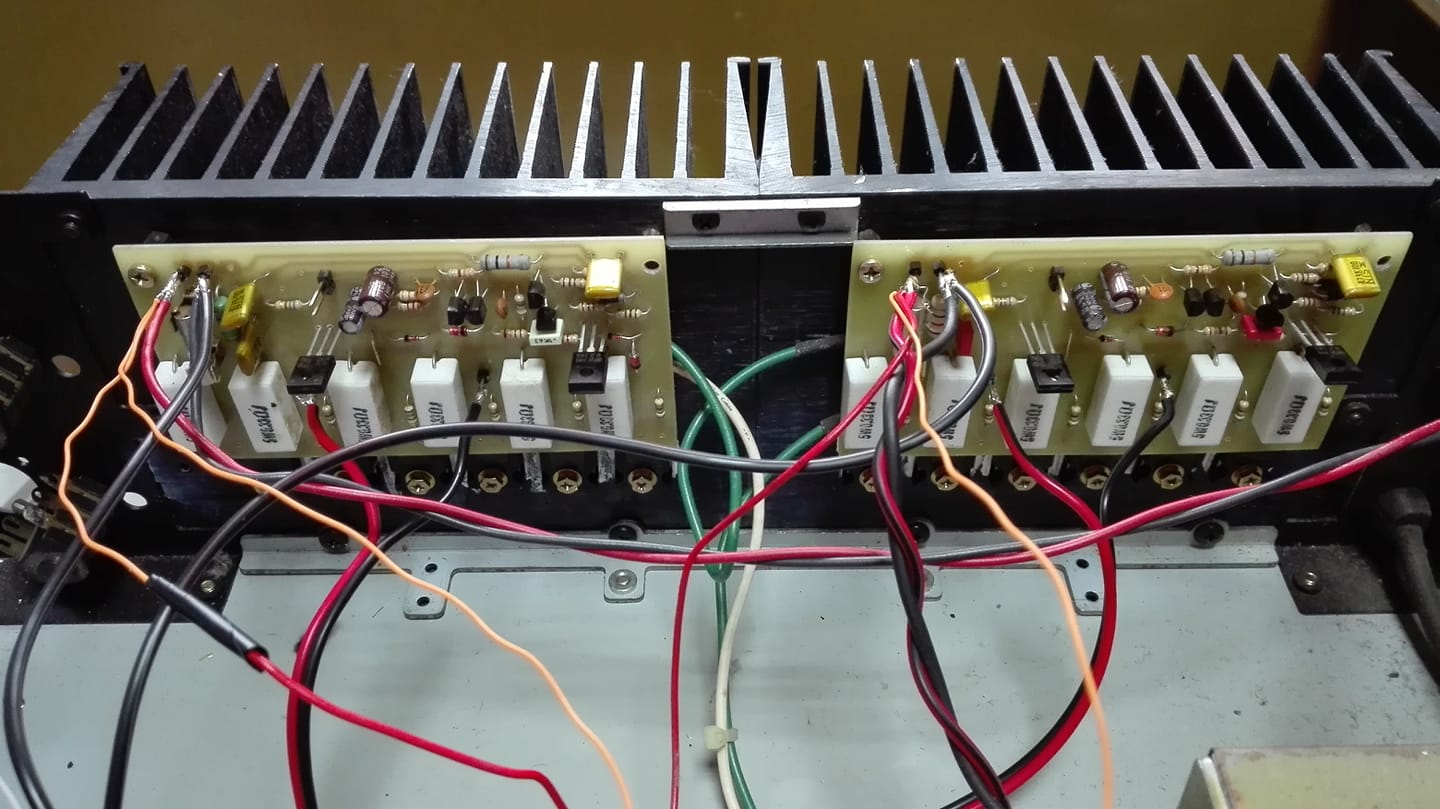

Hi XRK971, I did this pcb with Positiv 20 its a funy work

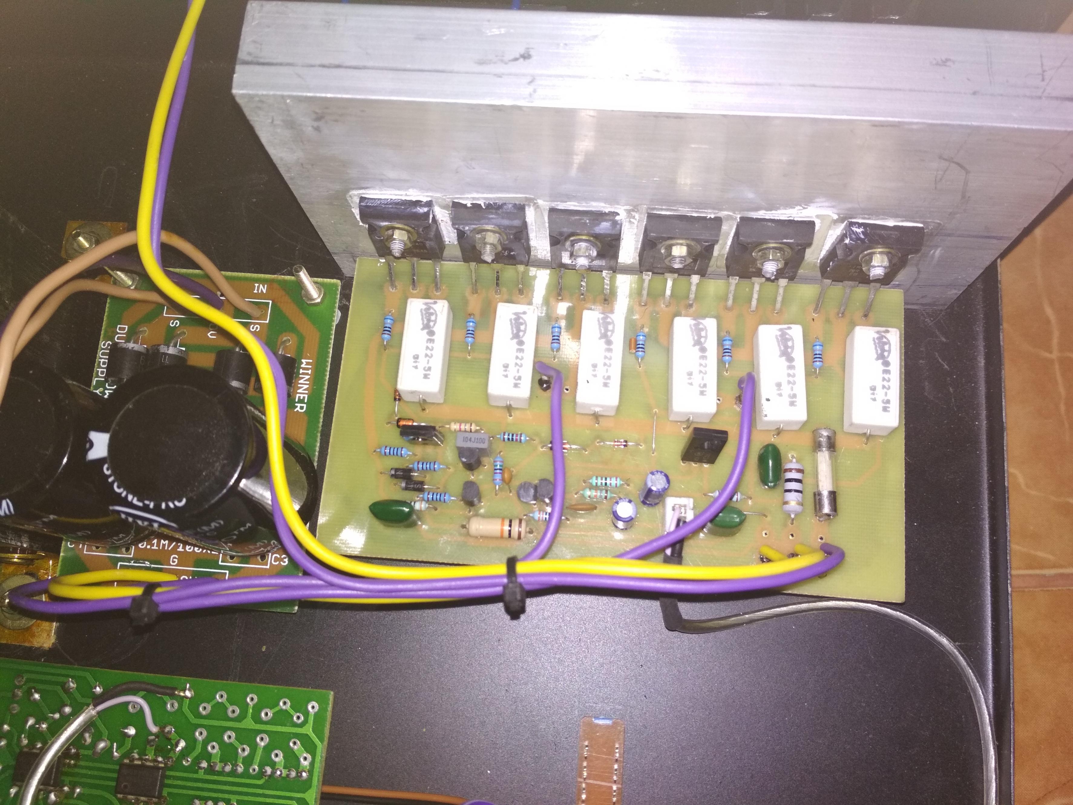

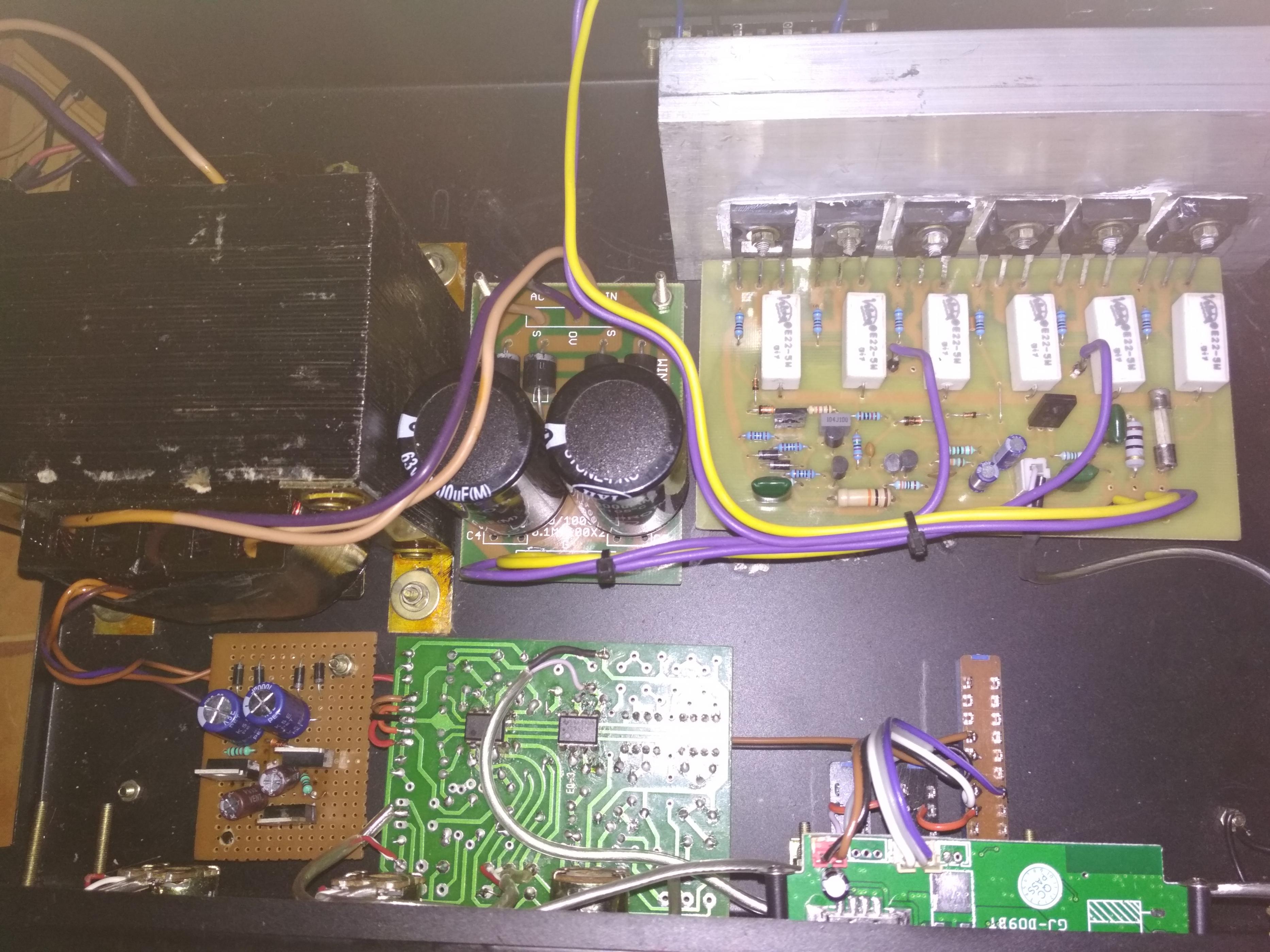

I'm collecting all the possible information about HV23 and I find this in post # 77. No forum user commented on this and I do not see a thermistor on R20 in the photos of all the armed PCBs.
Apex, Is it possible to use in Q9 and Q10, MJE15030 / 31? or 2SD669A, 2SB649A?
It is possible to use many TO220 pairs in Q9/10 and R20 is not NTC but can be MF (metal film)

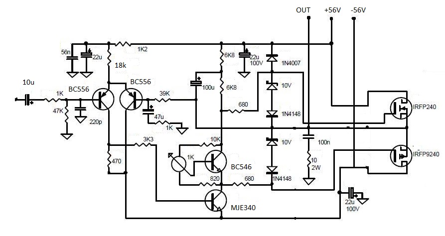

Hi all. A query on the limiter VI. The transistor Q12 (Q11) needs a voltage of approximately 3V to be developed on the resistor R35 (R39) to start conducting and carrying out its current limiting work. Now, the 3v on R35 (R39) implies a current of about 6A on each power transistor. This is good?.
Another question, how many pairs of output would be necessary to operate safely in bridge over 4 ohms with a power of +/- 80V?

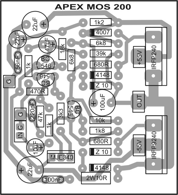

Simple Full Complementary Simetry +/-80V. Voltage amplifier/driver biased with 30mA. This driver circuit stabilized BIAS in output stage. Exelent stability without oscilation, hum and noise, sound great.
RMS Power: 240W 8ohm, 350W 4ohm
Go to post #470 for schematic and PCB
