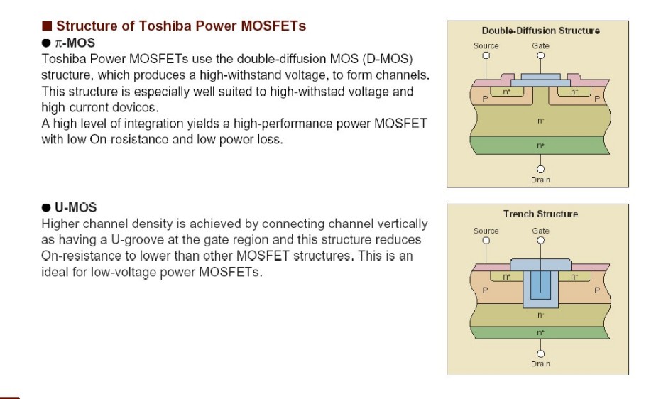

> Susan Parker is under the impression that the 2SK1529 is
a lateral part.
She got the FETs from me. : )
According to a broshure on power FETs from Toshiba, they refer 2SK1529 as pi-MOS. From the picture, it looks more lateral than vertical to me. In any case, it is D-MOs, and has the characteristic "linear" region after the parabolic at low current.
Patrick

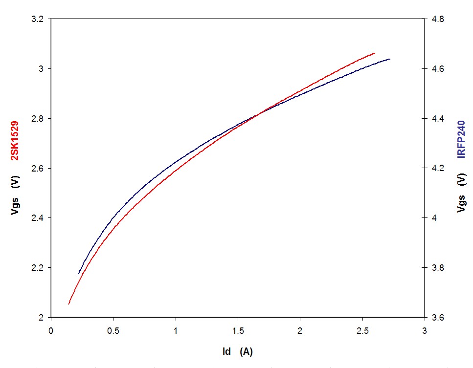

And this are the measured Vgs vs Id curves for both IRFP240 and 2SK1529. As one can see, transconductances is practically identical at around 1A.
Measurement was done at Vds = 24V, with the gate driven by a function generator using 1kHz sine wave with appropriate DC offset. Single shot, 1000 measurement points, 16 bit.
Unfortunately I have no equipment to measure distortion or frequency dependent capacitance. If anyone is able and willing, I am more than happy to offer a couple of FETs, for the sake of knowledge for all.
Patrick
