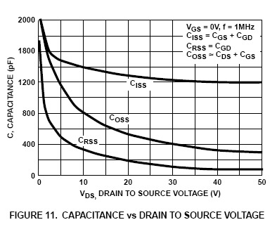

Nelson Pass said:
It is the linearity of
the capacitance which becomes the issue in any comparison.
Nelson, is it the linearity (straightness of the capacitance curve) or general slope of such a curve that matters?
For example, of two devies, one with a constant capacitance (perfectly linear), and another with a perfectly sloped capacitance (perfectly linear two), which one should we prefer, assuming everything else equal?
Any character of the device which is not constant over the
operating area gives rise to distortion. The variation in
capacitance with voltage creates distortion at high frequencies
not seen at low frequencies. Of course we would prefer a
constant value, but if we have to accept variation, it's a lot
easier to put up with a gentle variation, which is one reason
we say that Mosfets like voltage: the capacitance and
capacitance variation is less when there is greater voltage
across the device.
Let me ask the question in a slightly different way:
two otherwise identical MOSFETs: one's capacitance goes from 900p to 100p, in a perfectly linear fashion. another's capacitance fluctuates between 400p and 600p randomly (thus, perfectly non-linear).
Which of the two devices would you prefer?
Tough call. I would try both out, and see what happens. We
have to be clear in understanding that both create distortion,
and its a choice between magnitude and character. Usually
I prefer character, but it depends on how "perfectly nonlinear"
your example might be. If it's really random, then the harmonics
will have high order, and I really dislike that.
