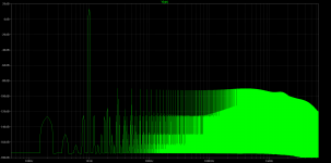

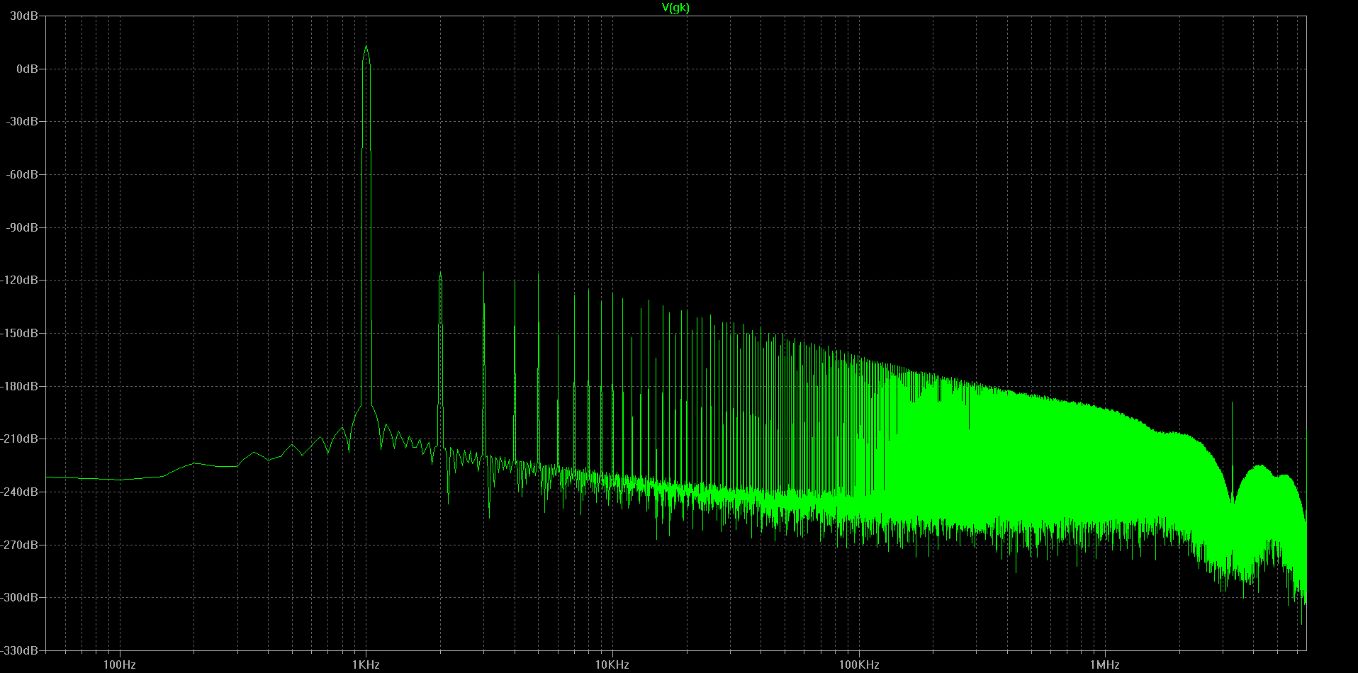

Hi
when r23 goes to 10 ohm, the idle at output irfs rise to ~150mA
look at fft, it is GREAT:happy2:
but still this oscillation:rolleyes::confused:
thd:
N-Period=1
Fourier components of V(vout)
DC component:-0.0039367
Harmonic Frequency Fourier Normalized Phase Normalized
Number [Hz] Component Component [degree] Phase [deg]
1 1.000e+03 6.600e+00 1.000e+00 179.99° 0.00°
2 2.000e+03 2.443e-06 3.701e-07 -7.93° -187.92°
3 3.000e+03 2.363e-06 3.581e-07 -93.36° -273.35°
4 4.000e+03 1.316e-06 1.993e-07 -2.84° -182.83°
5 5.000e+03 2.185e-06 3.310e-07 -92.21° -272.20°
6 6.000e+03 4.074e-08 6.173e-09 82.09° -97.90°
7 7.000e+03 5.329e-07 8.074e-08 -92.81° -272.80°
8 8.000e+03 7.618e-07 1.154e-07 176.64° -3.35°
9 9.000e+03 3.520e-07 5.333e-08 88.30° -91.69°
Total Harmonic Distortion: 0.000066%

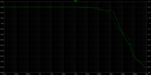

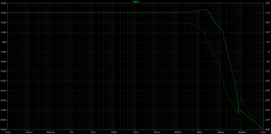

At the beginning of my simulations, the gate resistors have only caused instabilities.
However, after I changed the compensation, the gate resistors made ​​sense again. I interpret this as a good sign.
Now, the stability is not great, but again a little bit better. All my experience with common source at the output had shown something similar. Either high distortion with moderate stability above low distortion, and poor stability.
That's a bit of a challenge :mad:
Now, open loop and closed loop with 128mA bias through the mosfets:
