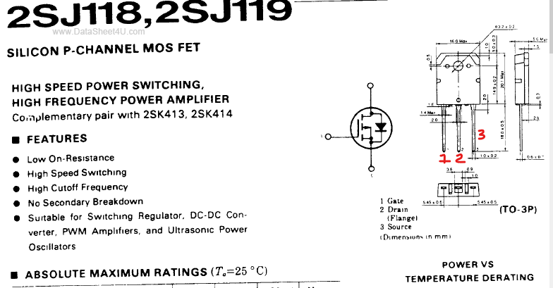

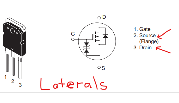

It's interesting that the source is bonded to the heat spreader. Also interesting the lack of gate protection with the 2SJ118/119 types.
